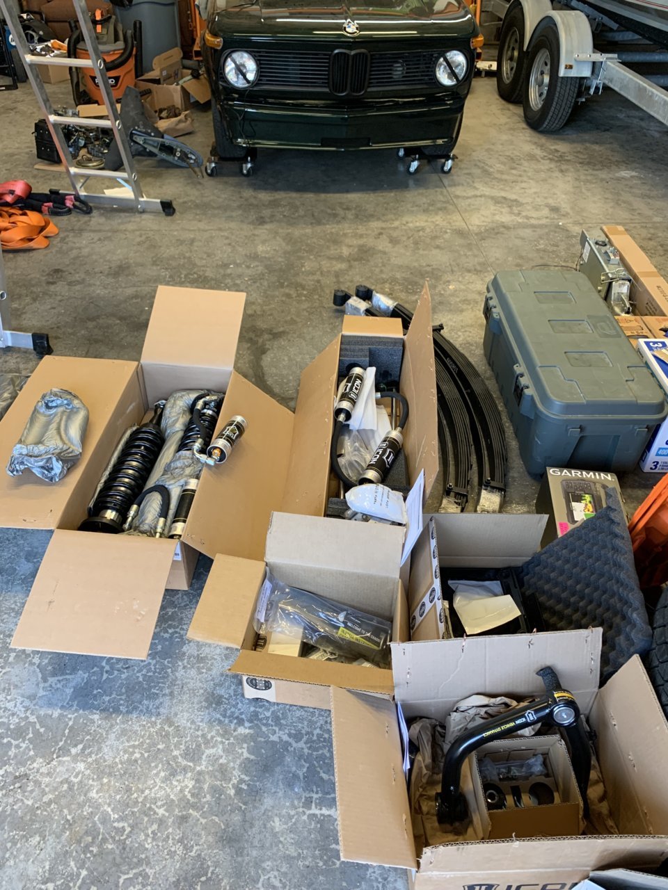

    I couldn’t help myself, when I bought the truck I told myself OME would work just fine for this truck, I didn’t need anything more….
    I didn’t..
    shoot
    S/O to Sam at SDHQ for helping me piece together a kit that’s in stock. We’ll call it icon stage 8.5, stage 9 fronts (RR adjusters), stage 8 RXT rears (RR non adjusters), and RXT leafs along with tubular UCA and some more little goodies.
    Sprayed all my bolts with PB blaster going to disassemble everything tomorrow after work and hopefully have it all put back together for my alignment appointment Monday.
    I ordered the socket for the axle nuts, getting it tomorrow. Is their anything else I should grab before I pull my truck apart?
    And as far as alignment, where should I be setting the coilovers at to get a good alignment with the icon UCAs, I figure I’m going to want to be shooting for that +.3 camber to maximize caster since I have et0 wheels on 35s so the extra positive camber should help with the scrub radius (just pulling numbers from the various alignment threads). I want to keep a slight rake, so something like a 3/2 lift

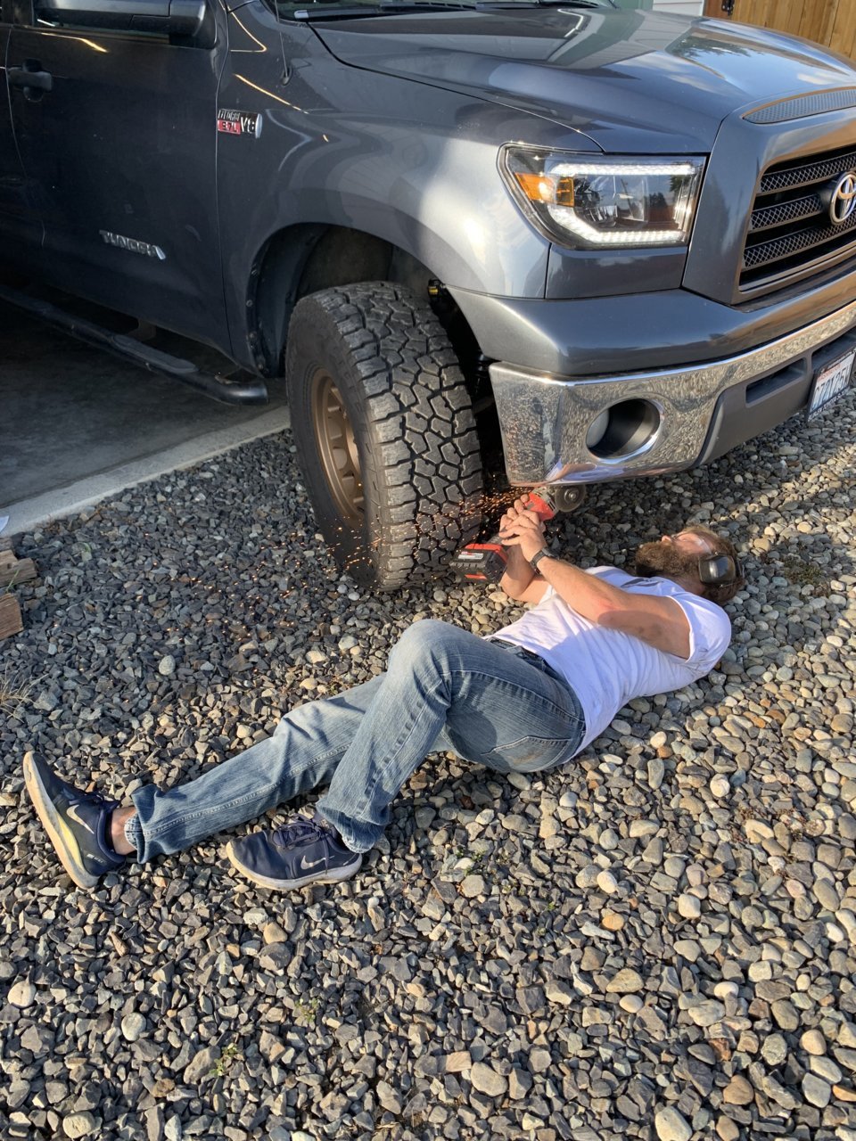

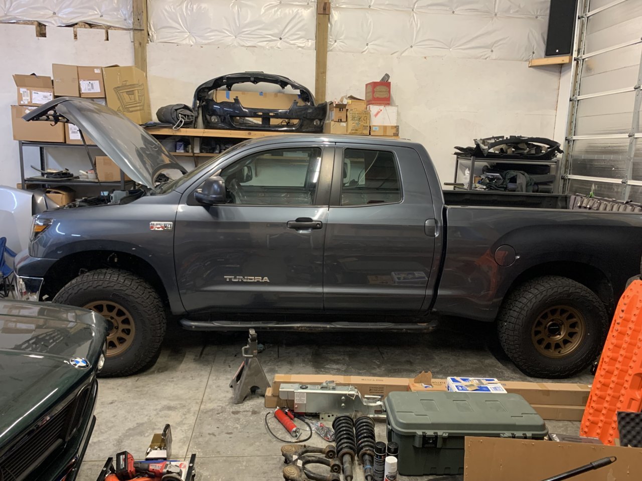

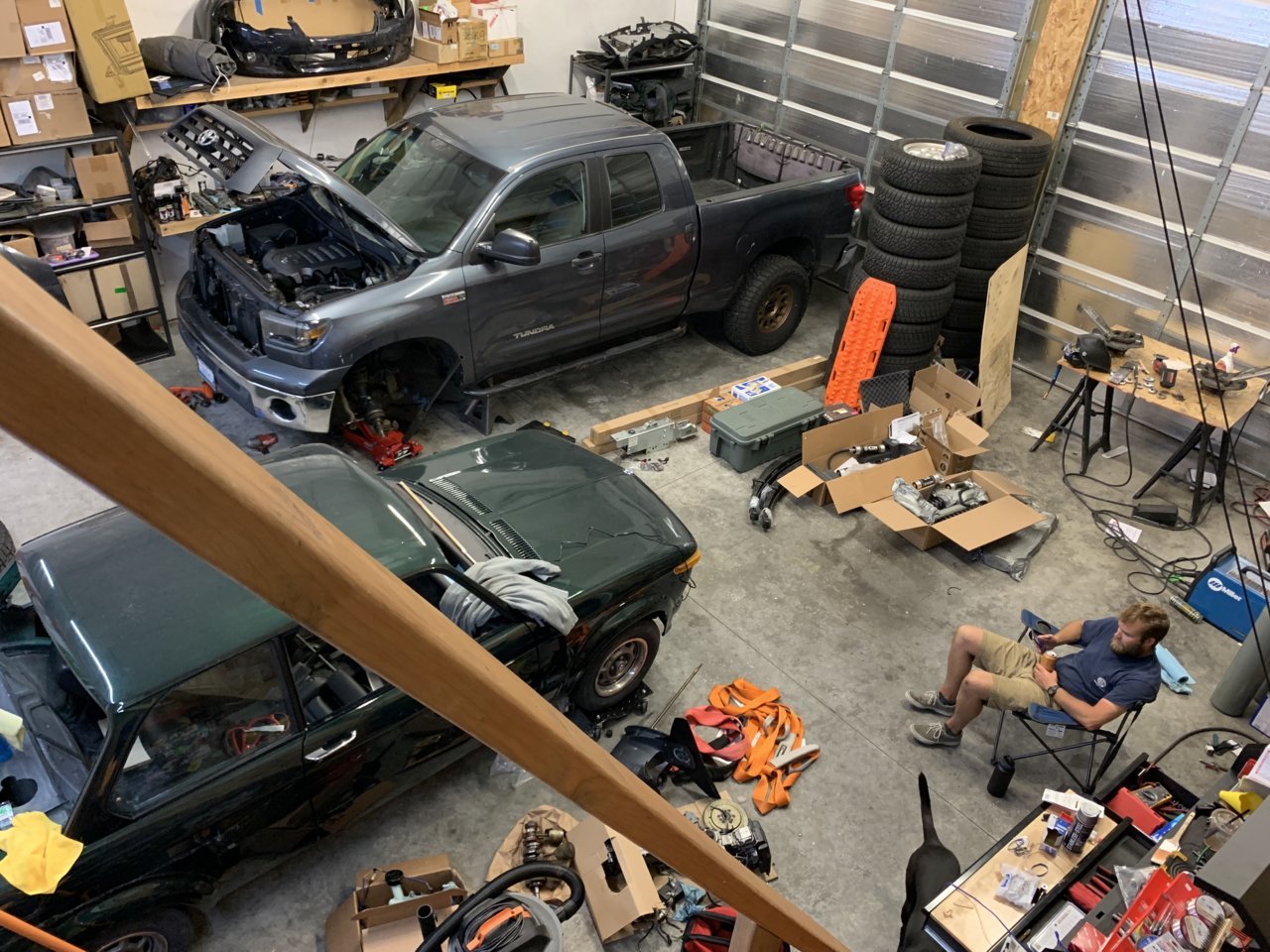

    Started tearing into it after work today, was hoping to get the front end disassembled…
    that didn’t happen
    my manager was really on my back about the union allotted beer breaks, and really pushing the tennis ball breaks
    Broke the passenger speed sensor..
    Broke one of the nuts welded in the frame for the sway bar.. good thing I didn’t buy extended end links
    Theirs a good pile of rust that fell off of everything using the ugga and hackzall

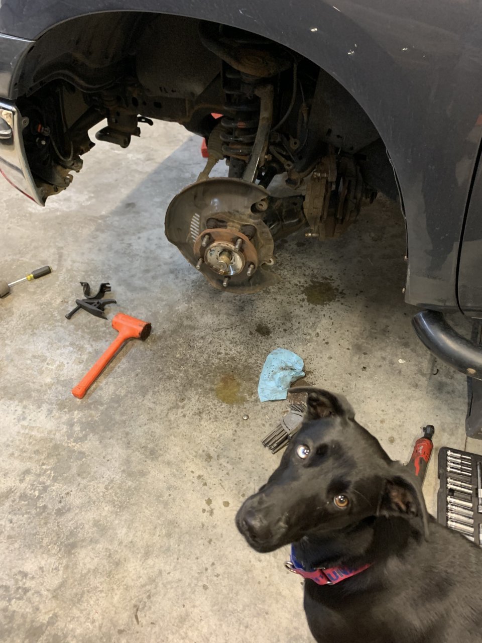

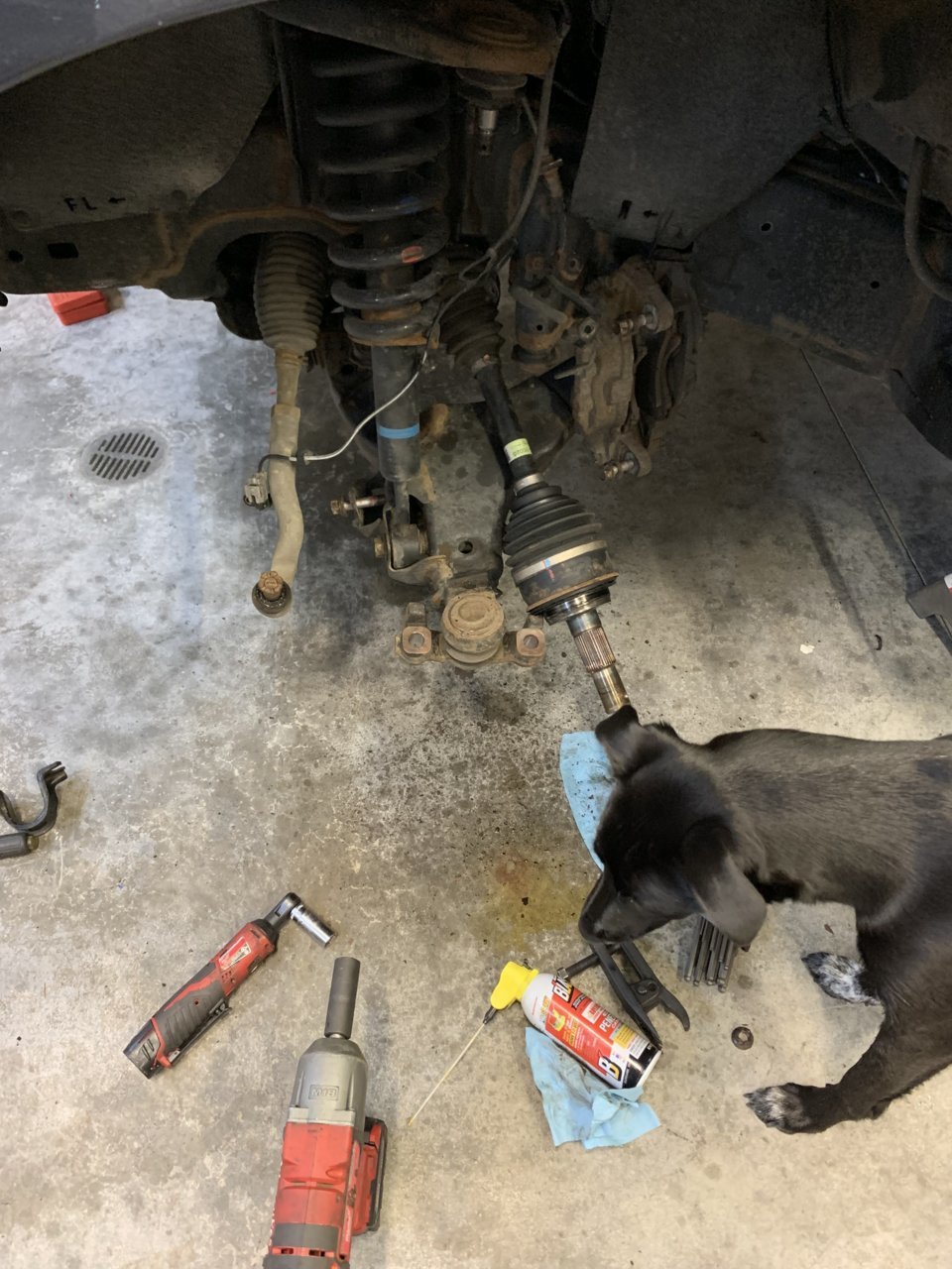

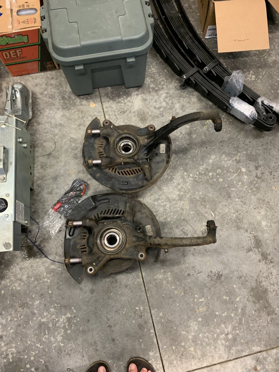

    Got the axles out and pulled the splines off, grease yo splines folks, that was a PITA. Nice little lunch break, one good outcome post pandemic is I get to work from home part of the week
    time to clean these up and make em look purdy again, kind of thinking painting them bronze to match my wheels and the icons

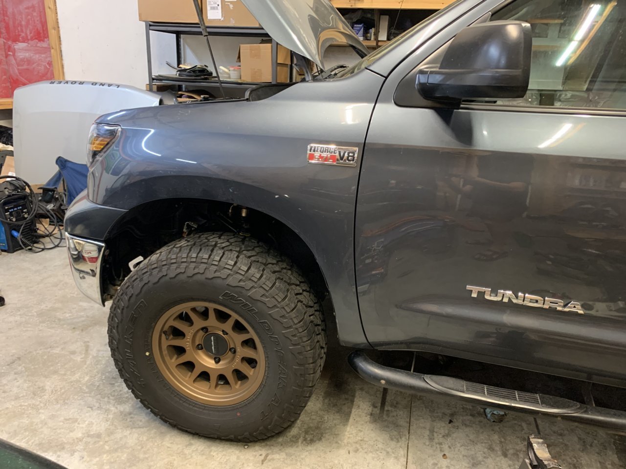

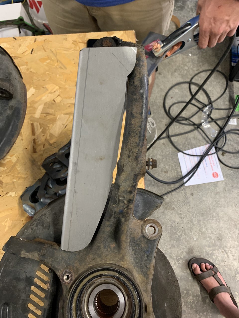

    Anyone know if I’m doing something wrong here, the cutout doesn’t line up and leaves a large gap
    HulkSmurf14 likes this.
  18. Jun 26, 2021 at 5:31 AM
    HulkSmurf14
    Aug 9, 2019
    #34377
    2,574
    2014 Tundra Limited
    Tastefully enhanced...
    One could trim the piece a bit more or lay a fat bead with TIG and be happy/comfortable...it's ose enough to get perfected in my opinion...

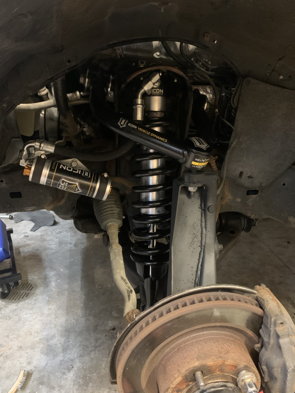

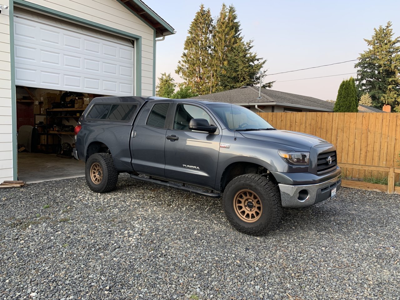

    got the front done after work today… finally
    After:
    For some reason my rubbing got significantly worse, think it’s the added caster with the UCA pushing the tire towards the rear. Going to raise it tomorrow and see if that helps
    coldcanuk and HulkSmurf14 like this.
  21. Jun 30, 2021 at 11:53 PM
    TXTundra2722
    TXTundra2722 Pipe Hitters Union
    Nov 26, 2018
    #22236
    1,763
    2015 Black Tundra
    I might be having an off moment since it's currently 0150.... but "added" caster pushes the wheel forward, not rearward.

  22. Jul 1, 2021 at 12:02 AM
    Maggy4x4
    Maggy4x4 [OP] N+1 mods
    May 26, 2021
    #63559
    33
    Washington
    2008 SR5 Tundra
    35s on methods Icon lift 46 gal fuel tank
    From my understanding it does when adjusting with the cam bolts (rears out fronts in) by moving the LCA ball joint forward but I think the icon UCA moves the upper ball (delta) joint rearward to add caster which moves the whole wheel towards the rear

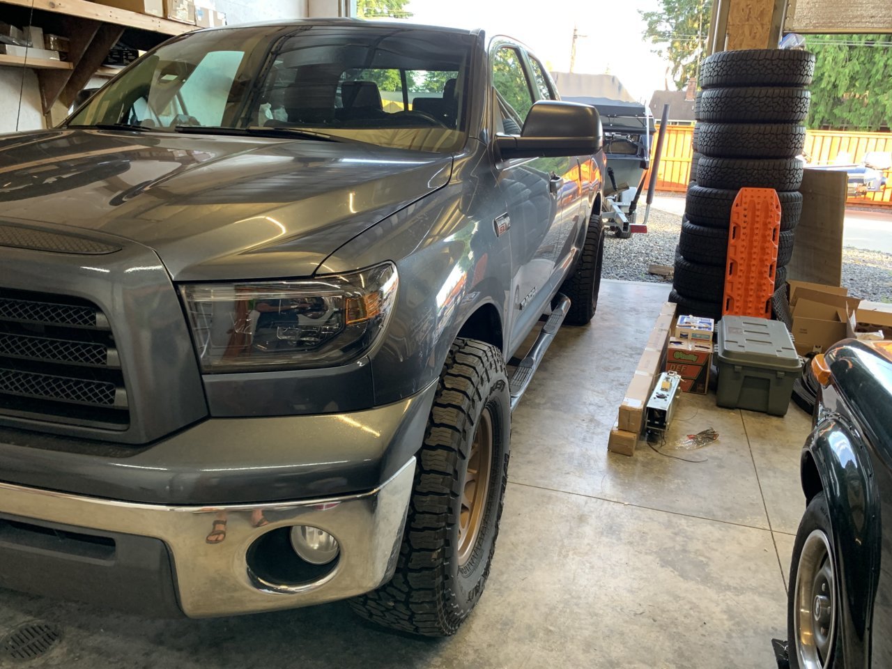

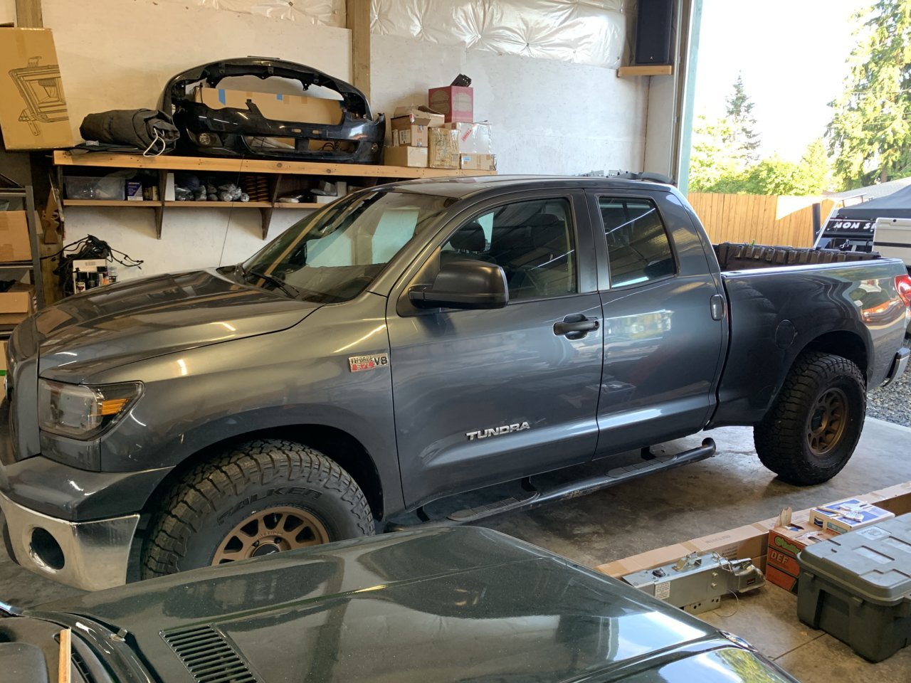

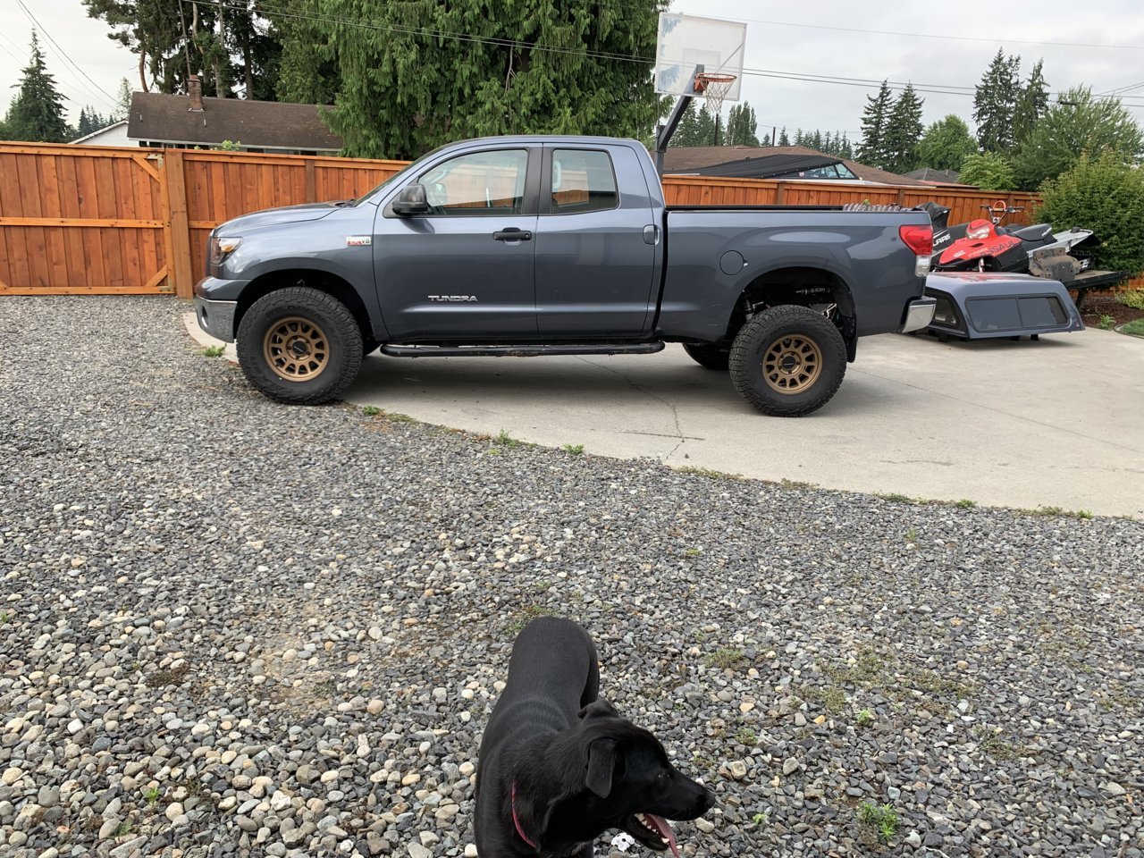

    Finally got it all done, went with option 2 on the leafs, bit of rake…
    @TXTundra2722 was right, it did move forward in the well (hadn’t checked the night before) and was rubbing on the bumper, before I could tell my brother I had bumper shims he was already going to town with his angle grinder
    now I have room for 37s though!
    Here’s a before for side by side
    will post more pictures after my alignment today and get it all loaded up, hopefully the rear comes down a bit

    I’m stoked, drives nice. And finally looks proper height. Loading it up tomorrow with a bunch of gear for a week in Montana so we’ll see how much the rear lowers.
    I think Firestone is using monkeys with pipe wrenches as their techs cause they did a number on my tie rods and left a mess of anti-seize all over the place. Tie rods are bottomed out and specs aren’t exactly where I want them but that’s a problem for later. Hopefully my tires survive
    good news is she can still make the jump in! (Although she rides in the cab)
