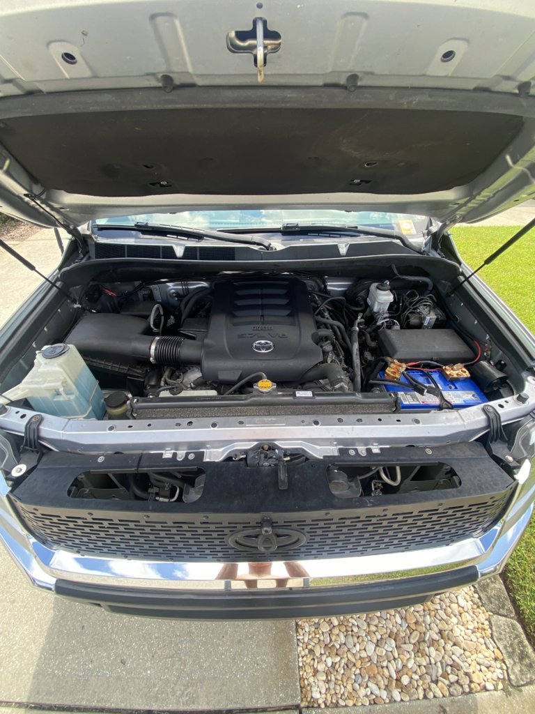

    First things First. Tear down
    I started with removing everything I wanted to paint.
    In the engine bay: Stillen CAI, Engine Cover, and the Fuse Box Cover
    Behind Grille: Radiator Shrouds and Horns

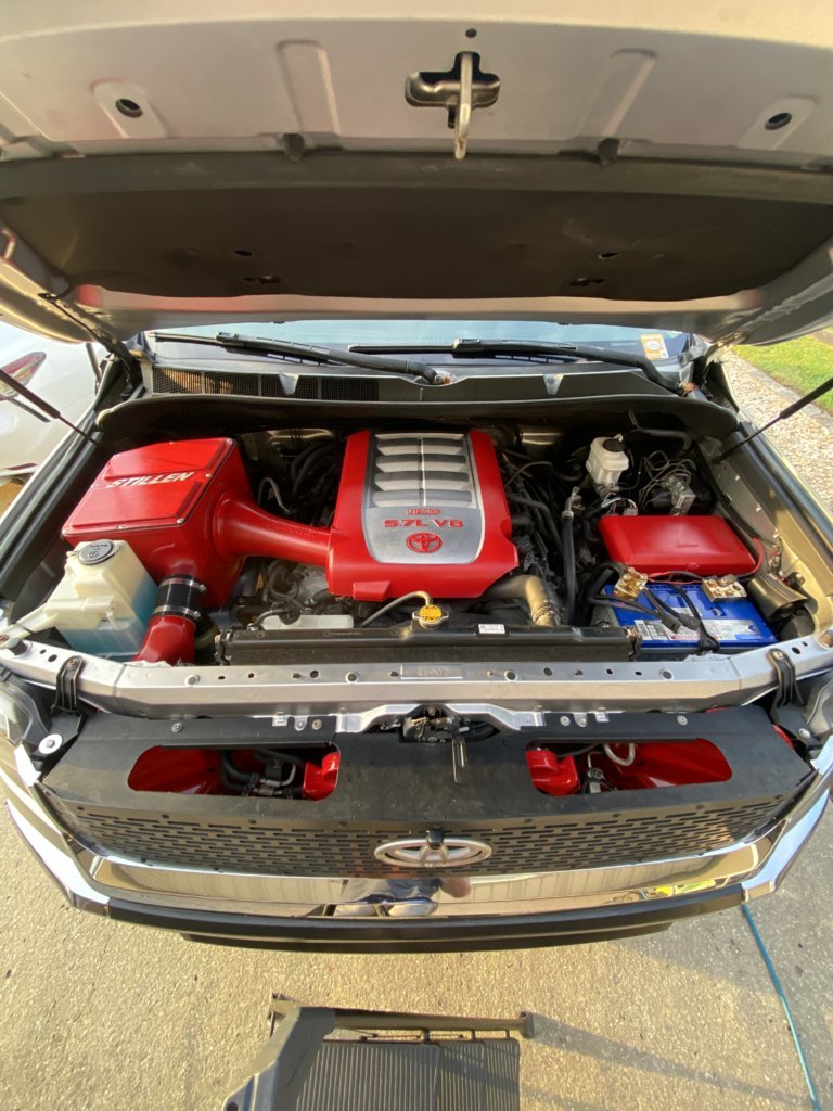

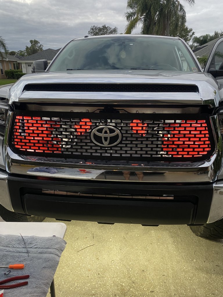

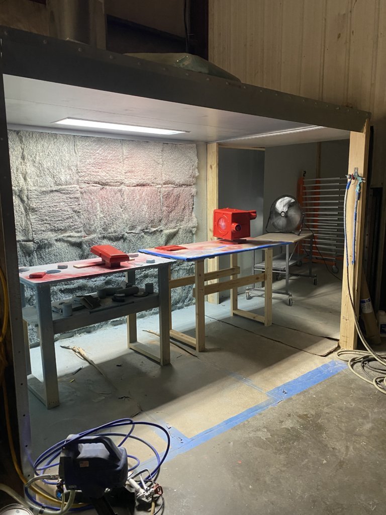

    I’m lucky enough to have access to a spray booth in a shop which made the process 10x easier.

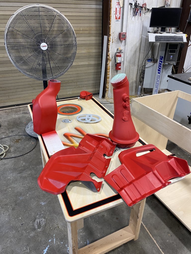

    Progress pics:
    After clear coat, I let them cure in an AC environment for about a week. Finally, I ceramic coated all of the parts and installed them.

    This was my first experience doing anything like this, and I learned a lot. Always follow the instructions, and don’t rush things. This took me 4 days total between removal/prep/paint/ and install (im a perfectionist). My lesson learned was about primer. Primer is a crucial part of the process for 2 reasons. 1 it covers up the black, allowing for less color to be used. 2 it determines the texture of the finish. The plastic was textured to begin with. Primer fills in the texture, so prime and sand to your liking and desire of the finish you want. If I was to do it again I would’ve done another stage of priming and sanding on the textured plastics to get a smoother finish. But it came out great (in my opinion) for my first time, I learned a lot, and was a pretty inexpensive mod compared to most others.
