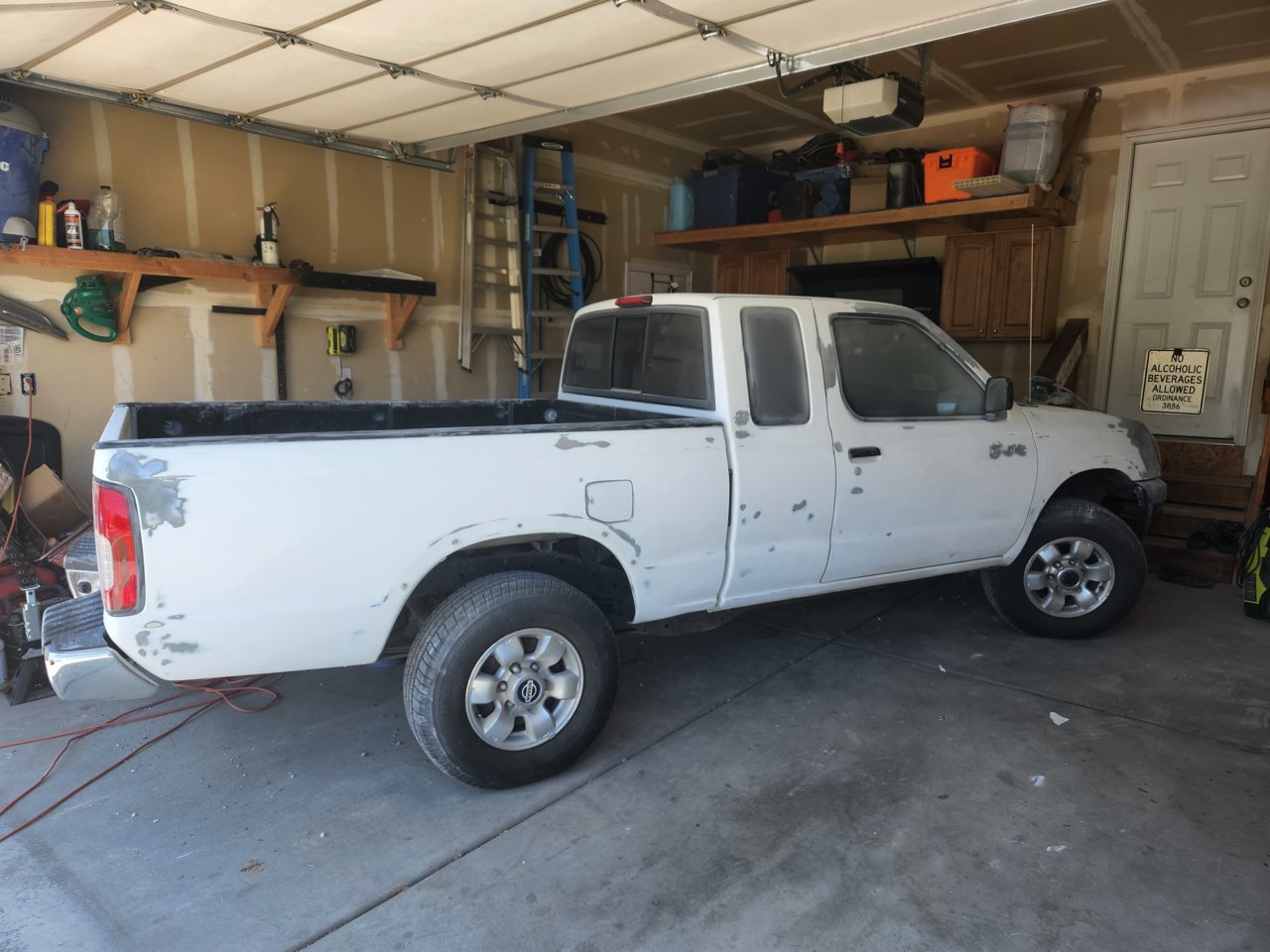

    Hey guys I have a 1999 frontier I'm painting myself. It had oem paint that is failing badly. Plan is to rip 180 over all the lose spots until all the paint is staying put while sanding, then start stepping up grit size gradually up to 400. Then I'm thinking epoxy primer sealer, and then single stage white.
    Concern I have is in order to get the peeling chipping paint gone I'm having to use 180, which in spots is burning through to bare metal. Not everywhere just lightly in spots. Will the sealer be enough to correct for this? I don't want to use a bunch of spot self etch primer and then seal and end up with a bunch of poke a dot looking spots showing through lol school me on this guys

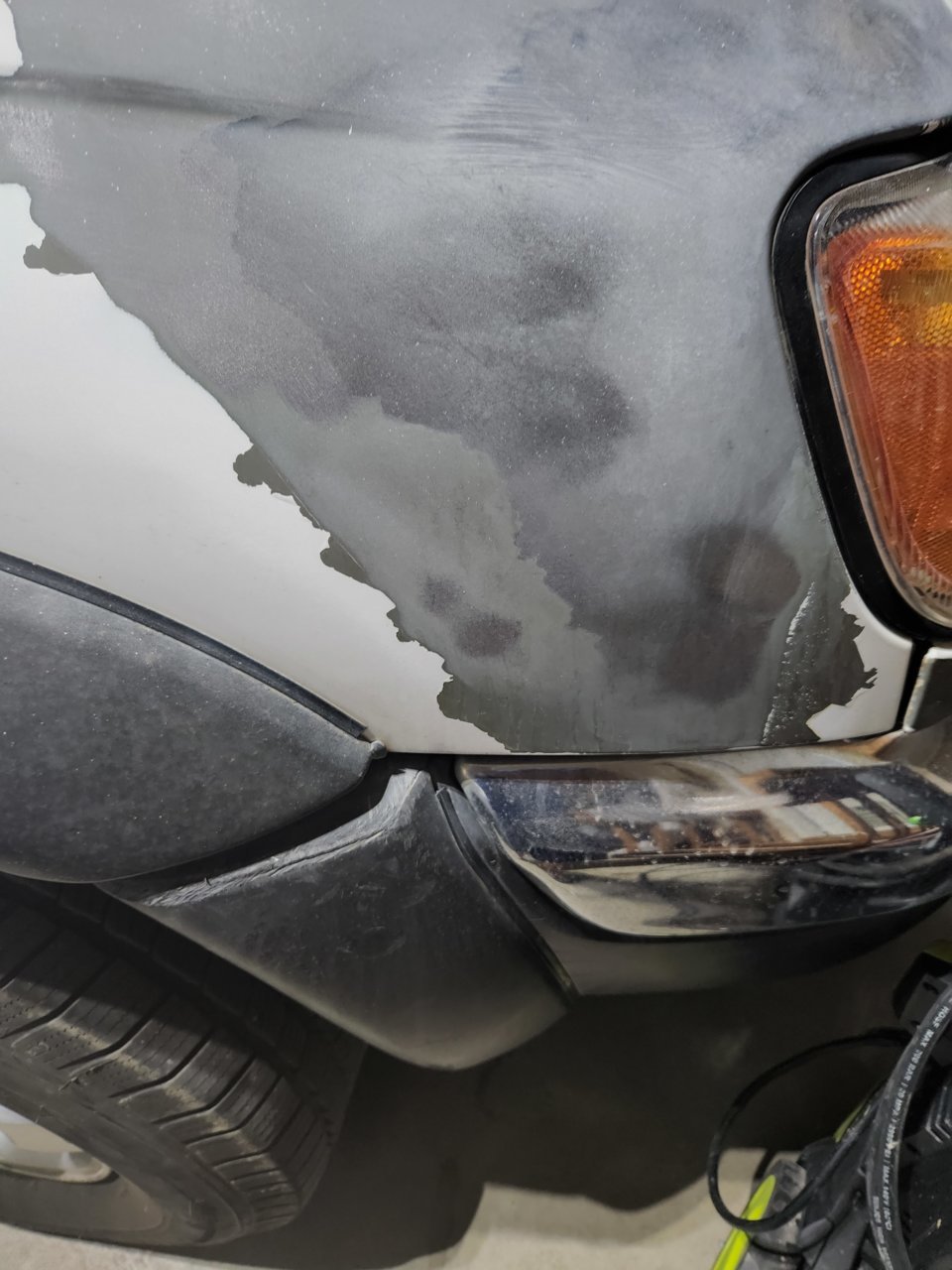

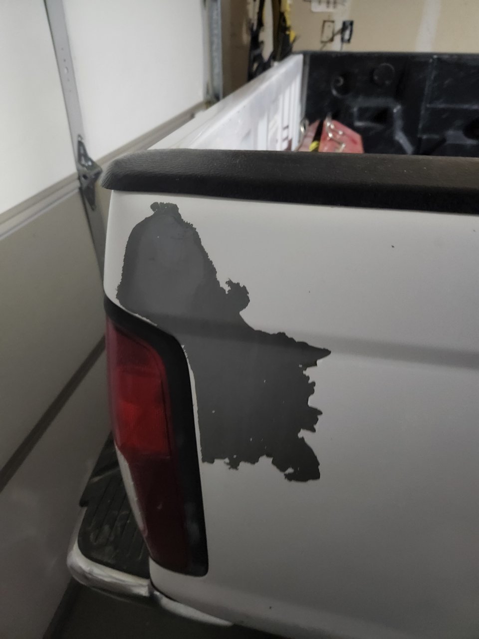

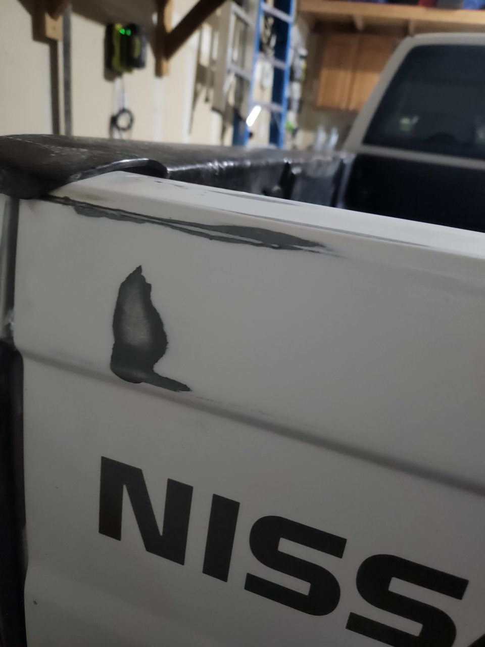

    This is the truck in question. 206k will be my sons first truck and is my house project chore truck
    Burn through shots
    Picture of peeling im dealing with prior to sanding

    Do you think the burn through will be enough to require a bondo float coat? If so that's fine just trying to avoid it lol I hate bondo haha

    Also I am going to be disassembling lights bumpers grille etc to strip everything down the sanded spots in the picture are just test spots to see how the peeling paint was going to react to sanding.

    I wouldn't. Multiple coats of a filling primer should fill it nicely.

    @Retired...finally is right. Just a filler primer should be ok. That single stage white is gonna hide a ton. Plus if your youngster is like I was, he’ll make new memories that require ruining the new paint.

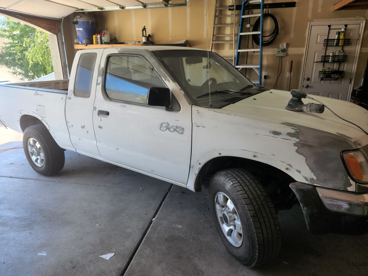

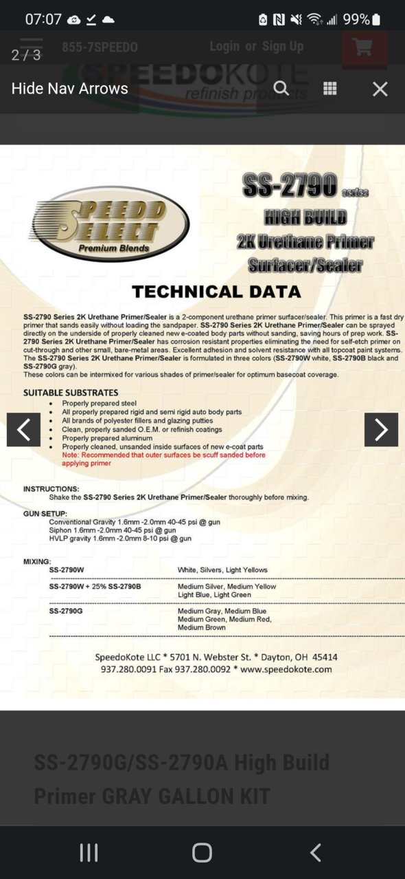

    Found a high to medium fill primer and sealer in one product. And it eliminates need for self etch primer as well. This will make things infinitely easier. upload_2022-8-29_7-8-10.jpg

    Everywhere there's gray burn through is where the paint was peeling

    Yea the primer I'm using is a 2k primer /sealer. It says in the techspecs I posted that it eliminates the need for self etch primer altogether. Also I'm parking the garage til finished so I should be good.

    You’ll want to etch any area of bare metal bigger than a baseball. The tech specs say “small burn through areas” and that’s where they’re drawing the line. That fender needs some acid etch fo sho. SEM makes a good spray can one.

    Ahh good to know. Yea then I'll need to etch prime the logo spot on doors and tailgate, front fender and rear bed corner . Good call
