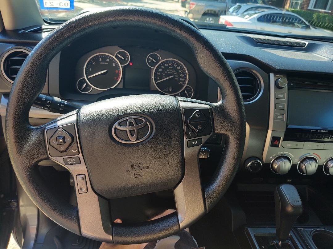

    Ok. I painted the steering wheel trim. Thinking the next item I want to tackle is the cup holder trim and all the trim around the shifter. Has anyone painted the chrome trim? If so did you scuff it and primer it? I have considered the AJT equipment but don’t know if I will like the fake screws they have.

    SEM trim black is what I use. It says you can use on chrome. Vent rings and that cup holder gotta go.

    I took of negative battery cable and removed the airbag. 4 screws hold those switches in and 6 screws hold that cover on each. I wiped them down with rubbing alcohol and gave them 5 coats each. The paint doesn’t say matte or satin. SEM Trim Black part number 39141. Got it from O’Reilly auto parts. About $20 a can. It is about $16 on Amazon. The whole project took about an hour.

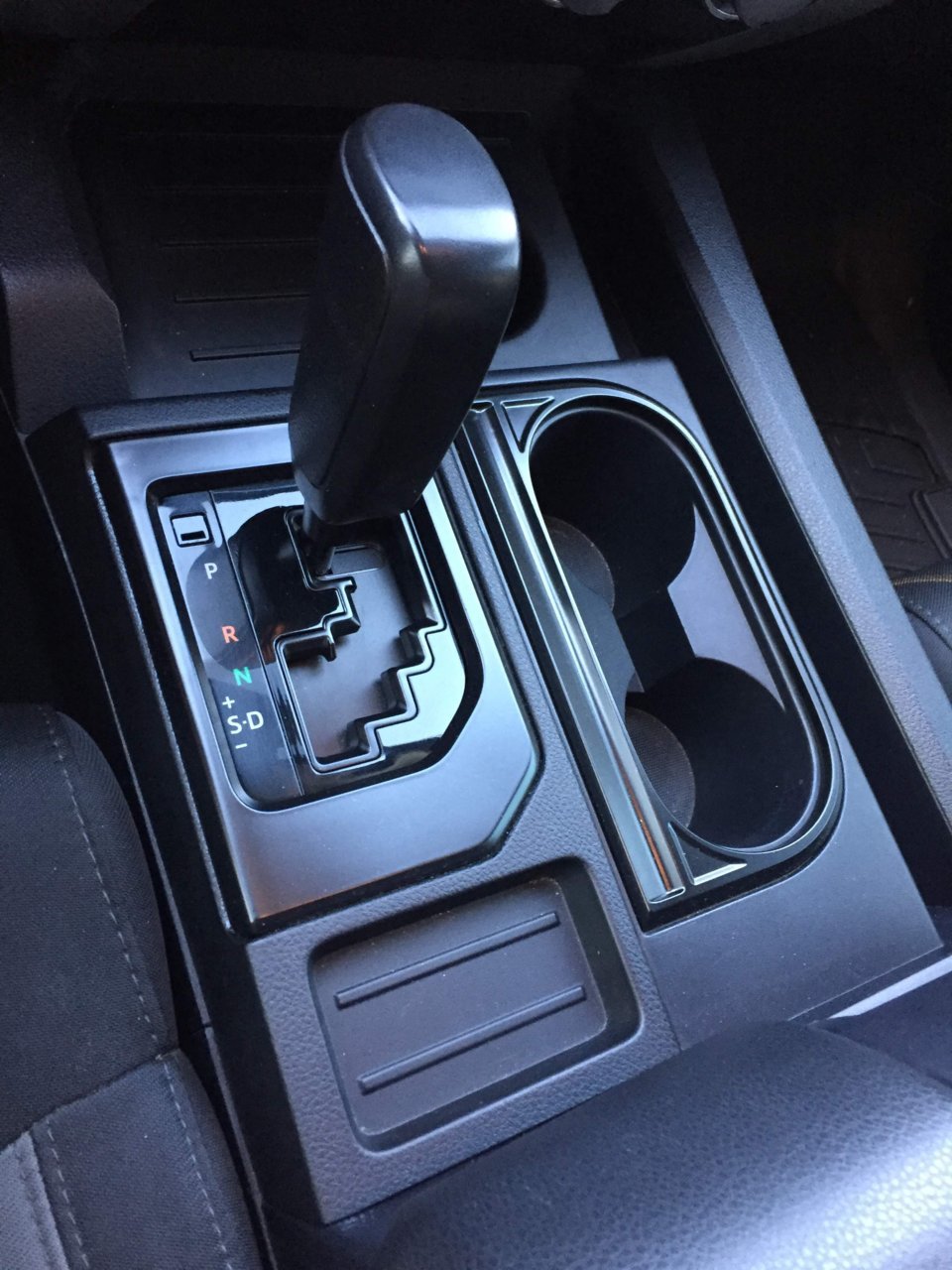

    Got the cup holder trim, chrome shift gate and shift trim removed. Man drilling out those plastic welds was scary. I thought for sure I was going to poke through the surround. Anyway they are now painted and drying for reinstall. Pics to follow.

    All back together.

    I watched the video on AJT for removal of the shifter surround. It took the longest. The shift gate has about 6 plastic rods that were melted to hold it in place. I used my Dremel tool and wore the rounded piece off. It was very easy. The cup holder chrome you gotta take the whole console piece out. The AJT video explains how to do it.

    That was simple. Remove the negative battery cable. Remove access panels on either side of steering wheel (one is around the cruise arm). This exposes 2 #30 torx screws to remove the air bag. Once the air bag is out of the way you can see the 2 screws holding each switch. Remove these and flip it over and remove the 3 screws holding the cover on.
