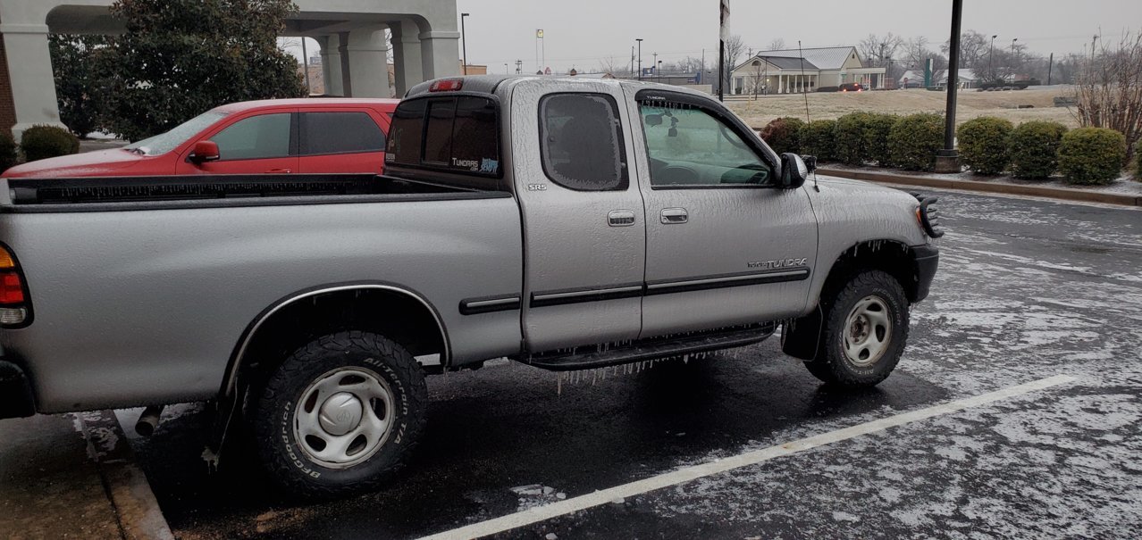

    Had some body/paint work done and the color doesn’t match. The shop said they’ll paint it again without charge but said they followed the paint info for my truck.
    Any suggestions on what paint brand to use for a better match? The new paint is a lighter gray, almost silver. Doors and fender were painted…
    Thanks!

    Thanks! Paint isn’t faded. Insurance work paint was completed on the bed a few years back. I’ll pass on the info. Appreciate it!

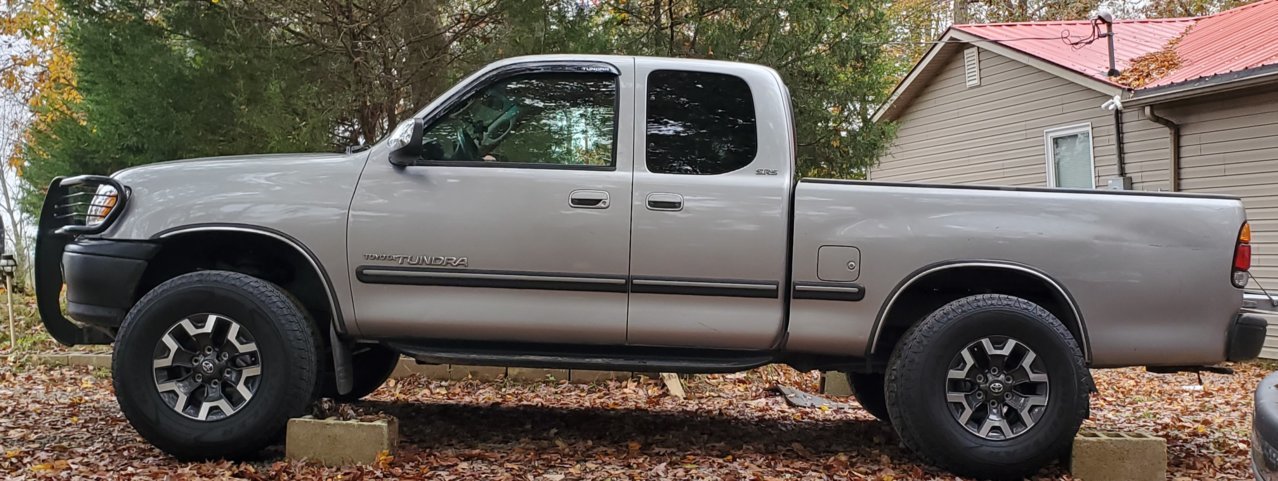

    What @gascap said. I have one panel that was resprayed. I can see the silver sky metallic has a c-hair more blue in it than the rest of the truck but only in the right lighting.
    I promise you that you are the only one who will ever notice it. You can kinda see it here in this picture. The passengers side bed is just slightly more blue than the rest of the truck.
    Ironically, this is also from the last weather event just like the one I'm experiencing now!
    Compare that picture of the passengers side to this picture of the driver side. See how it all has an undertone of "white"
    Here, I'll put them side by side for you.

    Looks like the bed is a tad darker than the rest of the truck. What I did to color match on my truck was to pull the fuel door and match to the color on the inside where its not clear coated.

    @Tundra2, issue is I notice it lol. Mine is a lot more noticeable than yours. It’s basically a different color when the sun shines on it.
    @Jack McCarthy absolutely right. The new paint is lighter than my original paint.

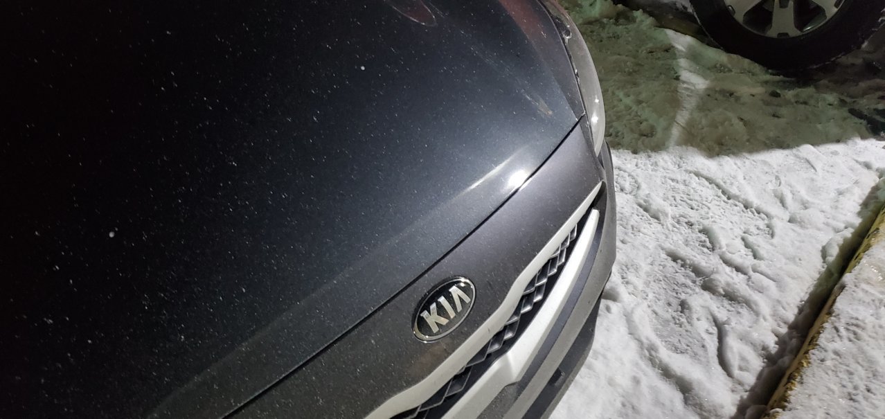

    Now this would bother me. This is a Kia in the parking lot. Metal hood is darker than plastic bumper.
    Such an easily discernable contract would not sit well with me

    That's a very hard color to match, lots of factors will affect the final color, such as air pressure and solvent to paint ratio. Looks pretty good, but if you aren't happy and they are willing to do it again, see if they can adjust.

    In person, the difference is very noticeable on mine. Basically the same as what’s buggin you in this pic
