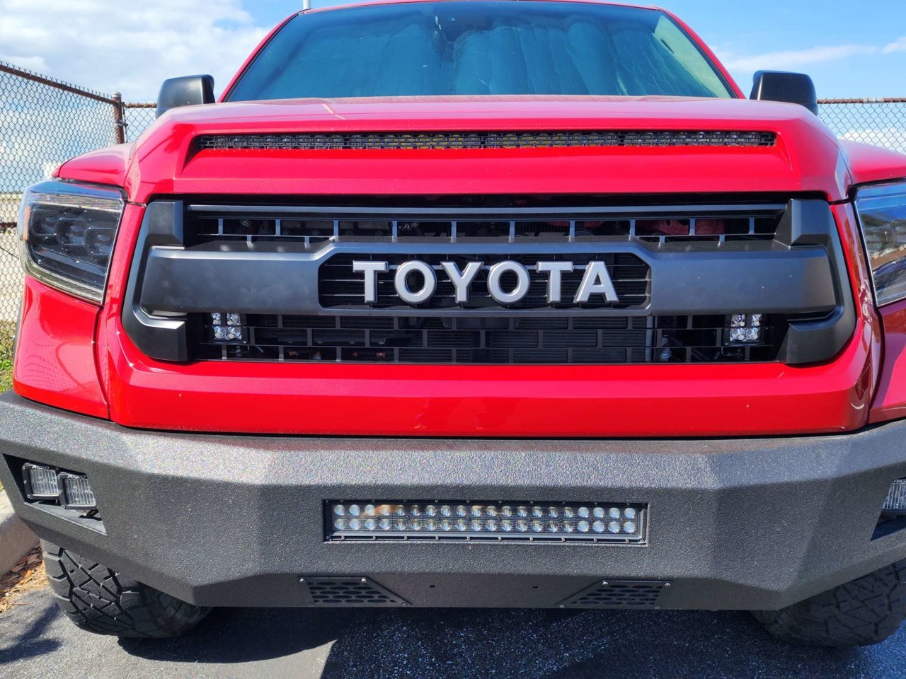

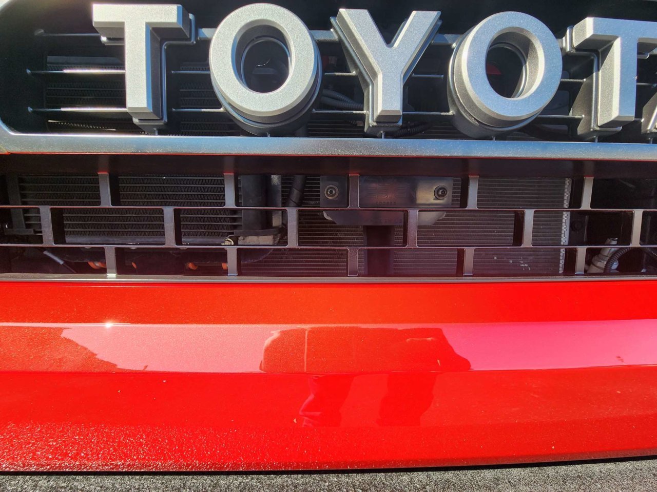

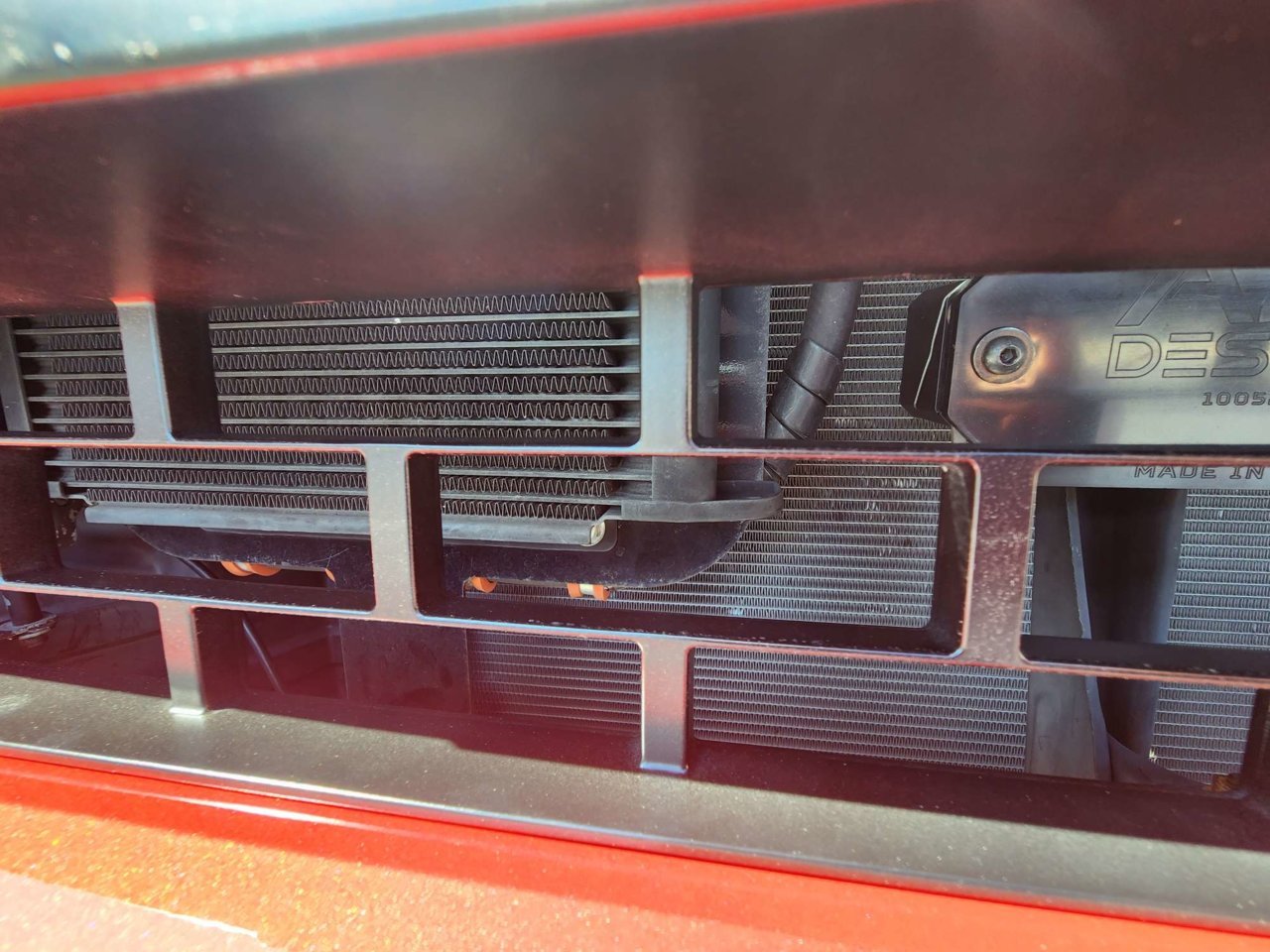

    So looking at it, I won't be able to get the other 2 pods in due to the transmission cooler. It's right at 2 inches from the edge of the cooler to the grille. The Rigids are 3.2" deep so the heatsink is too big. With the TSS sensor, I would have to be on either side of it or lower. I don't even think a single row bar is shallow enough when it's in the mount and aligned with the bottom grill opening. I have been interested in an amber or yellow for when it's foggy, but not too much out there on the street legal side of it. Rigid does have 6 inch bars, but I can't find the depth measurements of them. I was even looking at something like the BD Sport 2 or Pro....not sure how they would look though. I haven't tried to Photoshop them yet.
