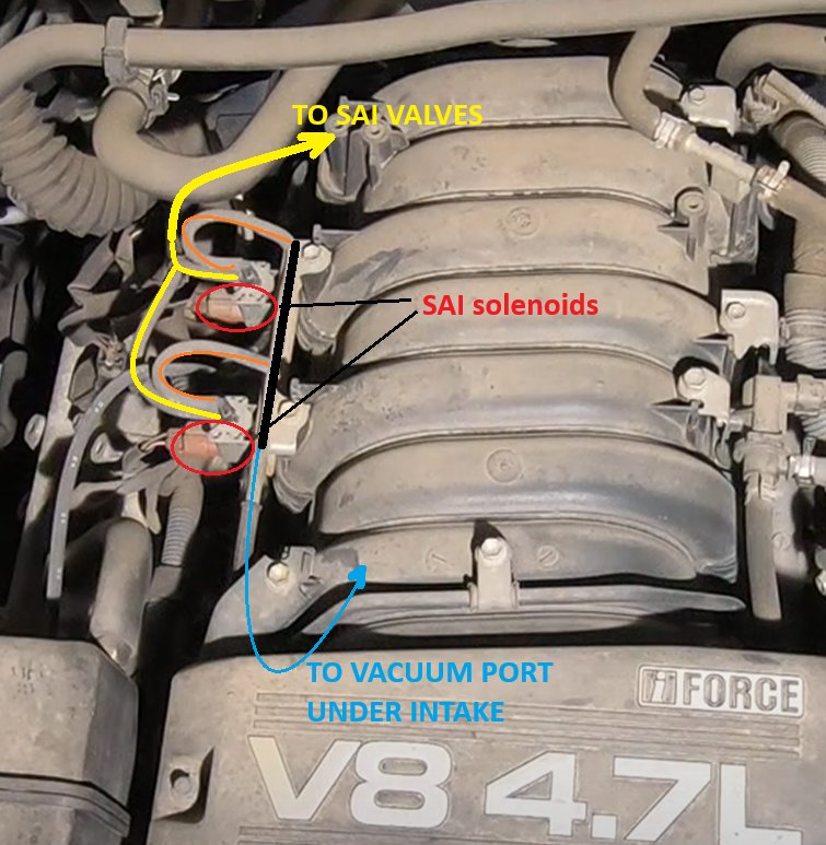

    The SAI system has two valves, on the back of the head. They are triggered open/closed when the SAIS pump is running, which is only during cold starts. This open/close function is controlled by the two solenoids (the look for the orange boxes, circled below, for their power harness), those valves are sitting over the passenger valve cover. You will notice both of those solenoids have a short vacuum hose attaching themselves to a shared metal rail (see orange line below). Each one has another vacuum line (yellow line below) that runs from the solenoid to your SAIS valve. The sole purpose of that solenoid is, when the SAI system kicks in, they are commanded to open, which pulls vacuum from the intake (blue line in the image) back to the valves, to open/close them as vacuum is added/removed.
    There is a VERY solid chance you fucked up, depending on what you were doing maintenance-wise, and either (A) failed to hookup their vacuum source or knocked it loose, (B) hooked up and/or disconnected the solenoid's vacuum lines incorrectly, (C) detached the vacuum lines that run between the solenoids and the valves at the back of the heads, or (D) something else I'm missing.
    Let's think about this logically.
    You have codes indicating both valves are not in the position that's expected. I suspect based on the symptoms, BOTH valves slammed shut. We could deduce from that. whatever the issue is, it impacts BOTH valves. Looking at the picture below, think about this. What one failure could cause both the valves not to open/close as expected? The solenoids are using vacuum to trigger the valves. Is there anywhere in the system they both grab vacuum?

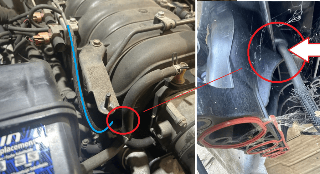

    If you guessed at the blue line, you're a smart cookie. That hose provides vacuum to the solenoids, and it attaches up under the intake, above the 1st cylinder on the passenger side.
    tl;dr - the first thing you need to do is validate your plumbing, to make sure the solenoids have power AND moreso, verify the vacuum hose plumbing. Specifically keep an eye out for that hose in blue, which you can see if you take off the iForce engine cover.

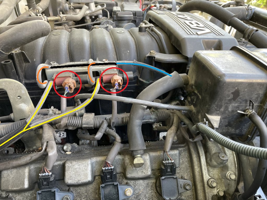

    Side view of all this, trace the lines. Blue line pulls vacuum from intake, feeds the black rail. Black rail feeds the orange vacuum lines to the solenoid, where the vacuum stops. When the solenoids are commanded to open (via those electrical wires), they open that vacuum to the yellow lines, and that vacuum then triggers the valves - makes sense, right?:
    Here's where the hose I'm outlining in blue connects to the intake, i.e. where it gets vacuum to force the rear-of-head valves open/closed, those same two valves the OBD codes are referencing.

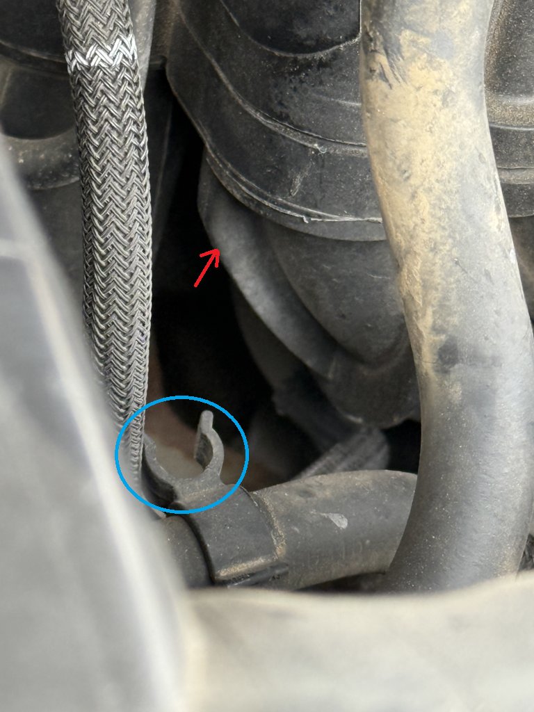

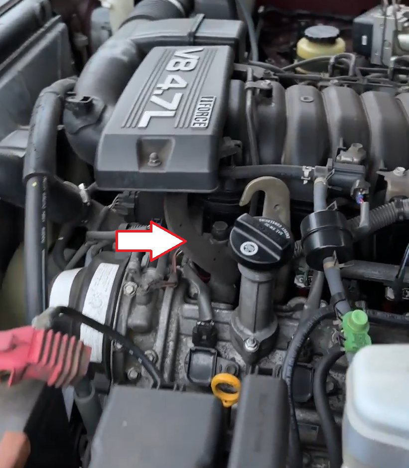

    I removed the cover and I still can’t see where that line ends. Let me attach a photo so you can see what I’m seeing.
    I can’t see where the hose attaches to confirm it’s on there snug. Looks like it’s going up though so I’m assuming it’s a good connection.

    Yes, it looks like that hose is probably plugged in. The bib it connects to points downward on the other side of this ridge I'm pointing at. From the right angle, I can absolutely see the end of the hose on my truck. You may need a mirror.
    Also, that hose should be popped into the clamp I circled here, I believe.

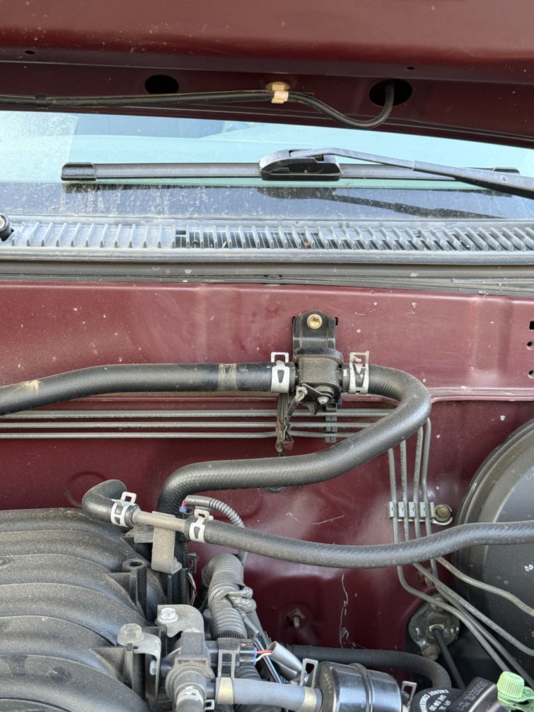

    Sounds almost like a large vacuum line is loose, that pumping/thumping noise. I thought the brake booster at first, maybe it's one of the PCV hoses? There's one here, I'm pointing the arrow at it. Make sure it's tight on both ends.

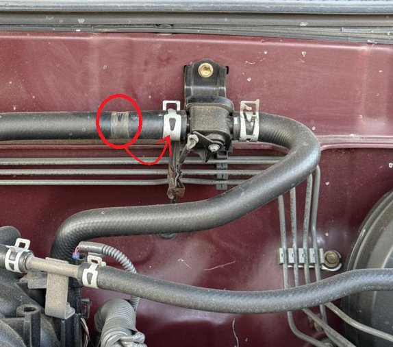

    BTW, you need to fix the coolant hose clamp, at the vent control. Look at the hoses across the firewall, the small black box. Hose coming out toward the center is not clamped. That's a disaster waiting to happen.
    But yeah, check this foam-wrapped PCV hose, and there's a matching one on the other side.

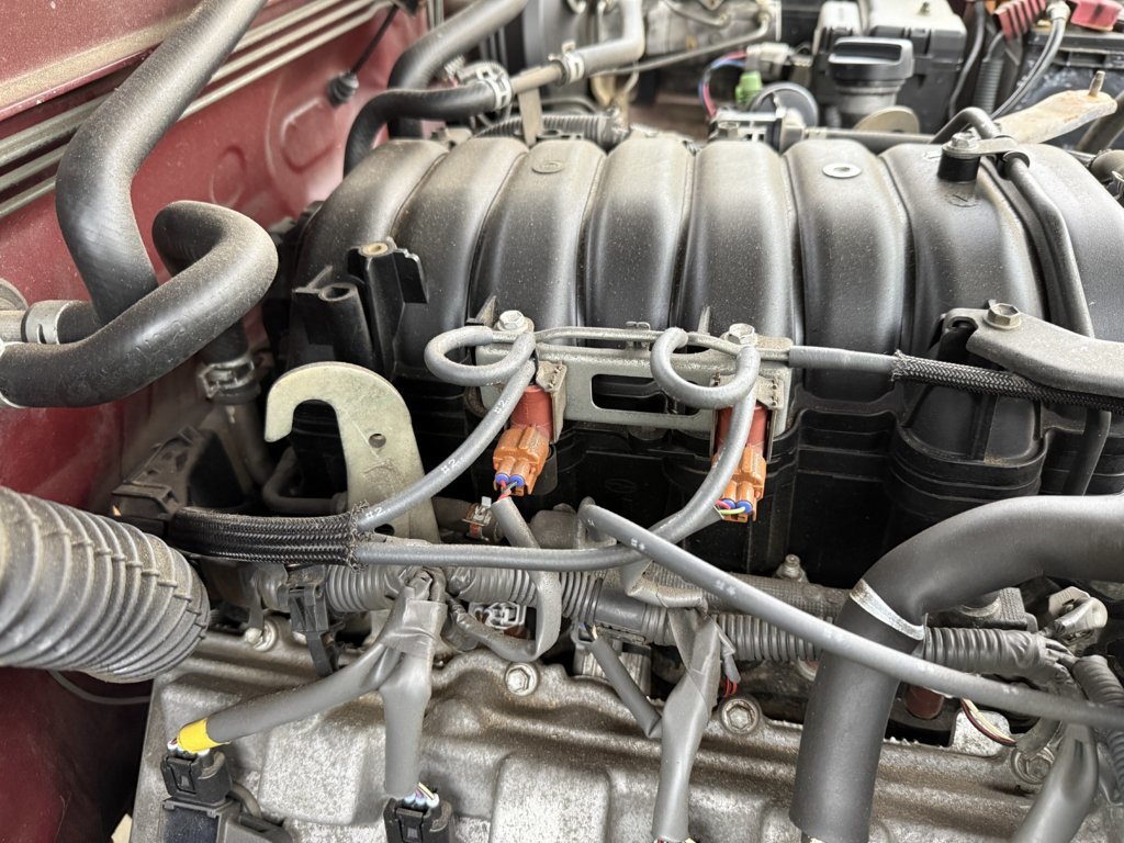

    Checked all the hoses you said and they all seem good. The light hasn’t come back on so I’m thinking it was a fluke? I’ll keep my eyes and ears open.
    Was this the hose you were saying wasn’t clamped?

    Correct, and I clearly see where you've moved it back to the right place, good on ya!
    You really DO NOT want to have that hose pop off while driving down the road, or you'd have coolant spraying all over your engine bay. The coolant hose is probably chemically attached to the heater actuator valve bib at this point, but not worth risking having it improperly clamped and flopping off.
