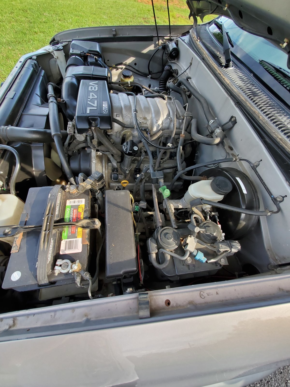

    Make absolutely sure you have all your hoses hooked to the proper places.
    There is a diagram on the hood or here is a vague picture I have if it helps.
