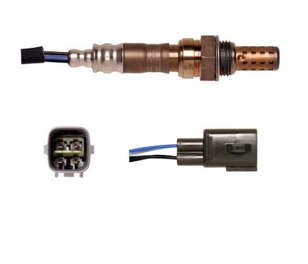

    I'm not suggesting to run out and spend $60 ea for sensors but if it was my Tundra, I would be changing them out as soon as I could. Same for any other maintenance you might not have done so you can create a new baseline of whats been done. Buy from dealer or at least from reputable source. Surely you've seen comments concerning Amazon and Ebay knockoffs.
    Denso sensors 2000 AC SR5 4x4.... Search Results | DENSO Auto Parts....
    With your 2000, the harnesses for the rear O2's should be same link. For kicks and grins, swap left side to right side and vice versa. If left is indeed bad or squirrely, code then should follow and be 430 code. At end of day, you need to consider changing all four for reasons already mentioned.

    Sounds good. Managed to get upstream denso sensors at rockauto on sale for $26 each. Downstream mention coming with a gasket but the upstream don't, do the upstream need a gasket as well?

    The upstream simply screw in and should come with a dab of anti seize applied.
