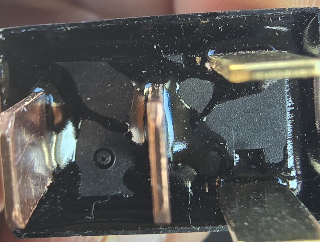

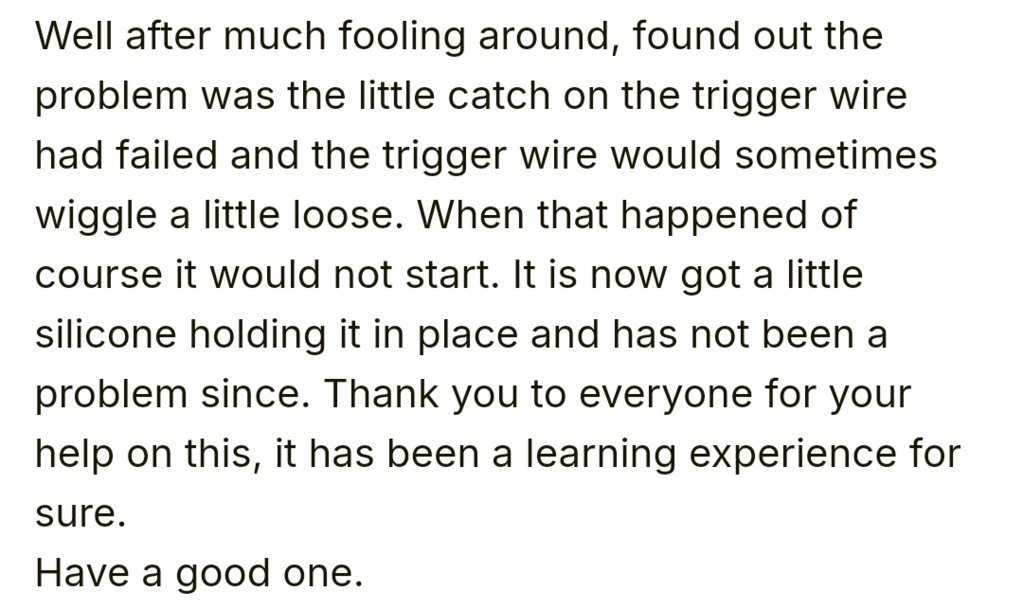

    This was on TS or TT from a while back that had similar issue.
    MT4runner and blackdemon_tt[OP] like this.

    Once I "glued" the starter trigger wire I've had no start issues. Knock on wood!
