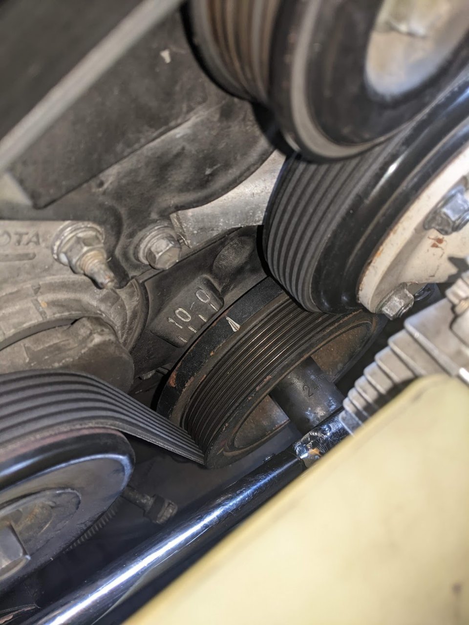

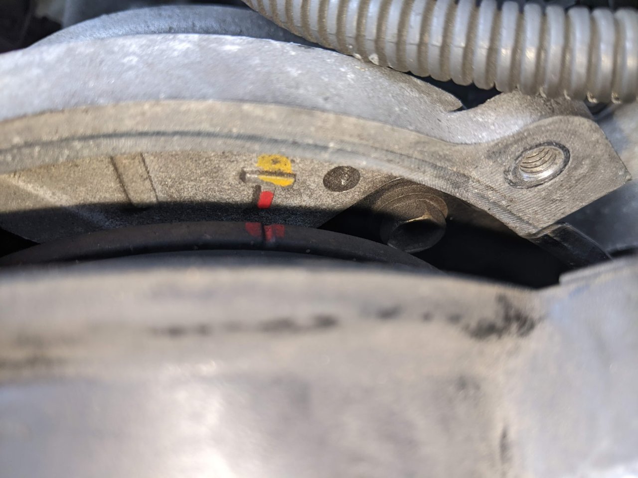

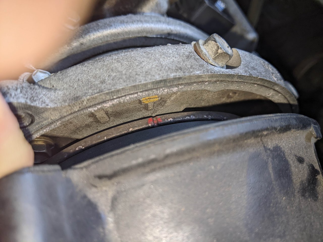

    Looks like the mechanical timing is off two teeth on each cam. Compression was good, 181-190. Ordered up all the aisin kit (no way I'm resetting that and not changing out everything) and other associated items. Long weekend coming up to knock this out.

    Ding ding ding. We have a winner.
    The 'doesn't misfire under load' was the deal-sealer for me, I'm glad you noticed that symptom. Reminded me of this guy (long ass read), who has the VVTi version of the 4.7, and a step he forgot when doing cam seals led to a condition where his timing was slightly off. IIRC, if he gave it a little gas, misfires would disappear.
