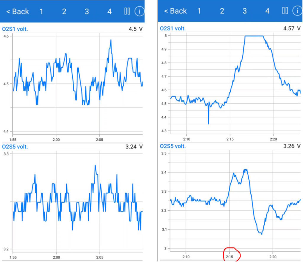

    I then used Car Scanner app on my Android phone + ELM327 dongle to log AFR O2 voltages on B1S1 and B2S1, and during engine idling, I pressed the brake pedal to simulate a lean condition (this idea is from several Youtube videos).
    My O2S5 voltage (Oxygen sensor 5 Wide Range Voltage, I don't know why the software shows sensor 5 voltage instead of sensor 2, but I assume this is the B2S1 AFR sensor, as other sensors are disabled in the software) consistently hovers over ~3.25v during idle, and goes up to 3.4V when I pressed the brake pedal, then goes down to ~3.1V when I release the brake pedal, then it will go back to ~3.25v after it "stabilizes" for several seconds.
    My O2S1 voltage (Oxygen Sensor 1 Wide Range Voltage) however consistently hovers over 4.5V during idling, and it shoots up to ~5V after I press the brake pedal, it probably went over 5V as the software recorded a flat line at 5V for several seconds. Then the voltage drops to 4.5V, but it never went below 4.5V (like B2S1 does under 3.25v) and its response seems slower compared to B2S1.
    I think my O2S5 (or B2S1) is behaving normal. But my O2S1 (B1S1) is not.
