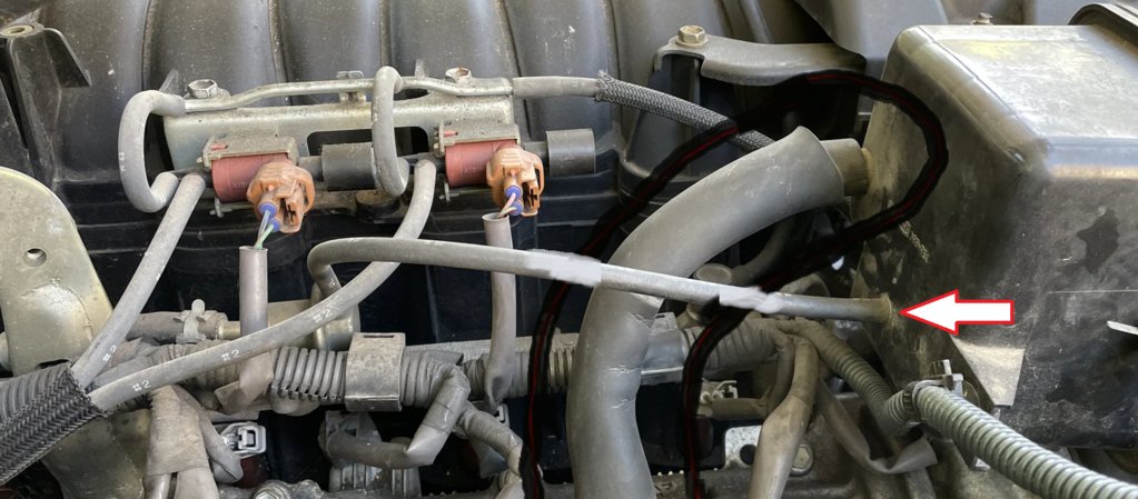

    The vacuum hose you'll really want to verify is this one, cut ¼" off each end and replug or just replace. Just for shits and giggles, try replacing it, I believe it's a 4mm ID vacuum hose, you can get in bulk at the auto parts store.

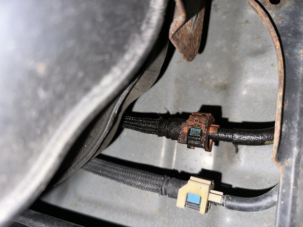

    So I replaced the hose as you suggested. And tried using the carb cleaner trick to find the leak but to no avail. However I was looking under the truck discovered that the quick disconnect at the fuel tank is weeping. Wondering if that’s contributing. Is this any easy fix? I am not sure whether it’s the supply line or return. I am guessing that it is under pressure.

    Wow, that's a killer find. And yes, 100%, absolutely I think you just found your problem! Any leak in the fuel lines would cause this, because it would detract from pressure in the system when hammering it hard. Any time you jam on the pedal, that fitting would've been leaking more, and you're lucky it wasn't in the engine bay and didn't start a fire. I'd have NEVER thought to look or even suggest looking for that!

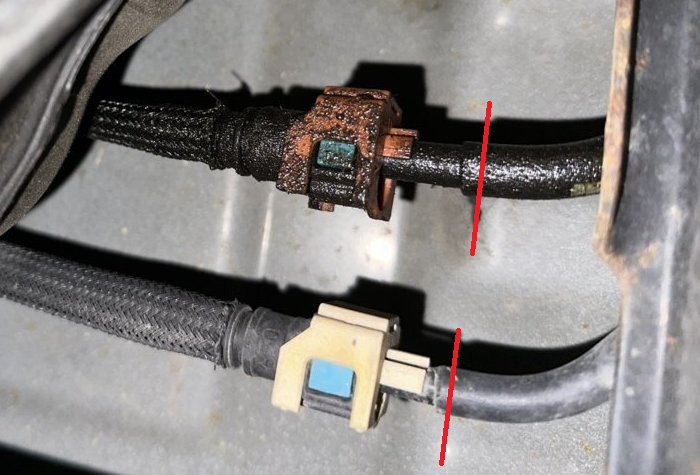

    Note the top fuel line fitting doesn't appear pushed in all the way compared to the other, see my marked up version here, note the hip to the left of the line on both, although. I'm fairly certain both are quick-connect fittings, and should latch in place when pushed on. If you push it in does it not latch? Push it all the way in, and twist a bit, see if it clicks in, then tug-test it.

    I had the P0171 code. Replaced MAF and (4) sensors, still got the code. Checked the hoses and poof. My air box has an large (3/8") upper hose and the (1/4") you show. The upper was cracked on the airbox end. Tape for now and all's well.
    It's an odd hose with large/flared ends. Not sure why, but will try to find it's brother.
