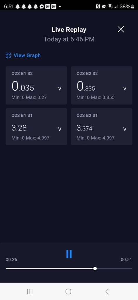

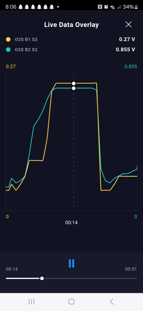

    Connector to the A/F sensor on driver's side secondary sensor B1S2 got pulled out and spliced back together on my 2008 4.7. Replaced 2nd sensor with new Denso and same results. Readings from all other sensors seem normal, movement coincides with B2S2 but voltage is way low.. could this be an issue with my ECM/ECU/PCM? Thing is driving me a little crazy trying to pass inspection and it's my only code with occasional P0136 with the p0137Screenshot_20241204_185124_RepairSol2.jpg Screenshot_20241204_200656_RepairSol2.jpg

    according to your photos, the voltage ranges are normal.
