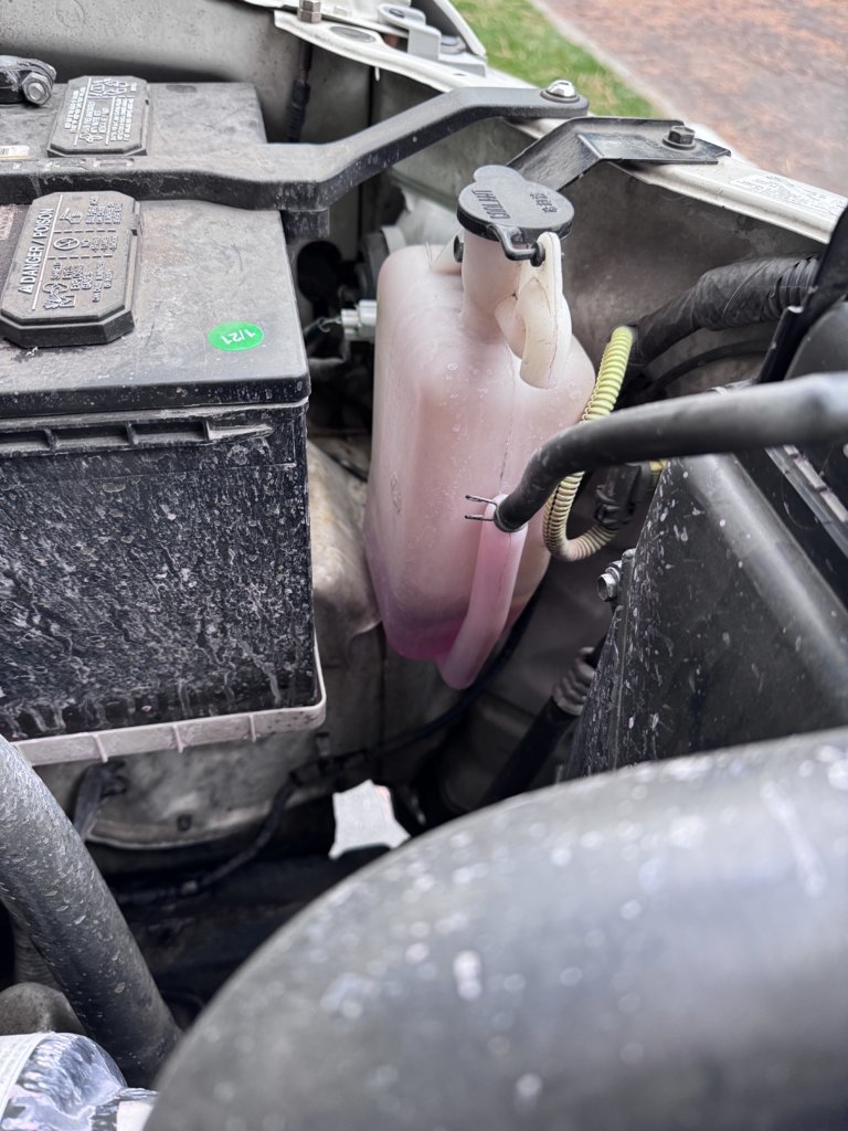

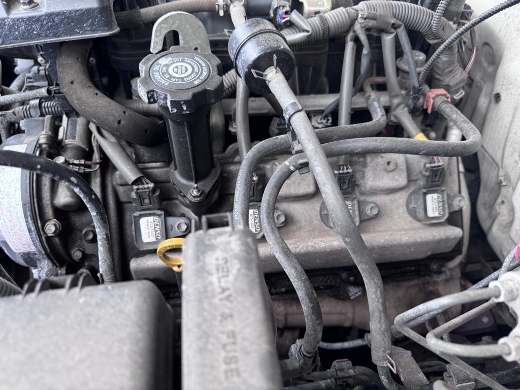

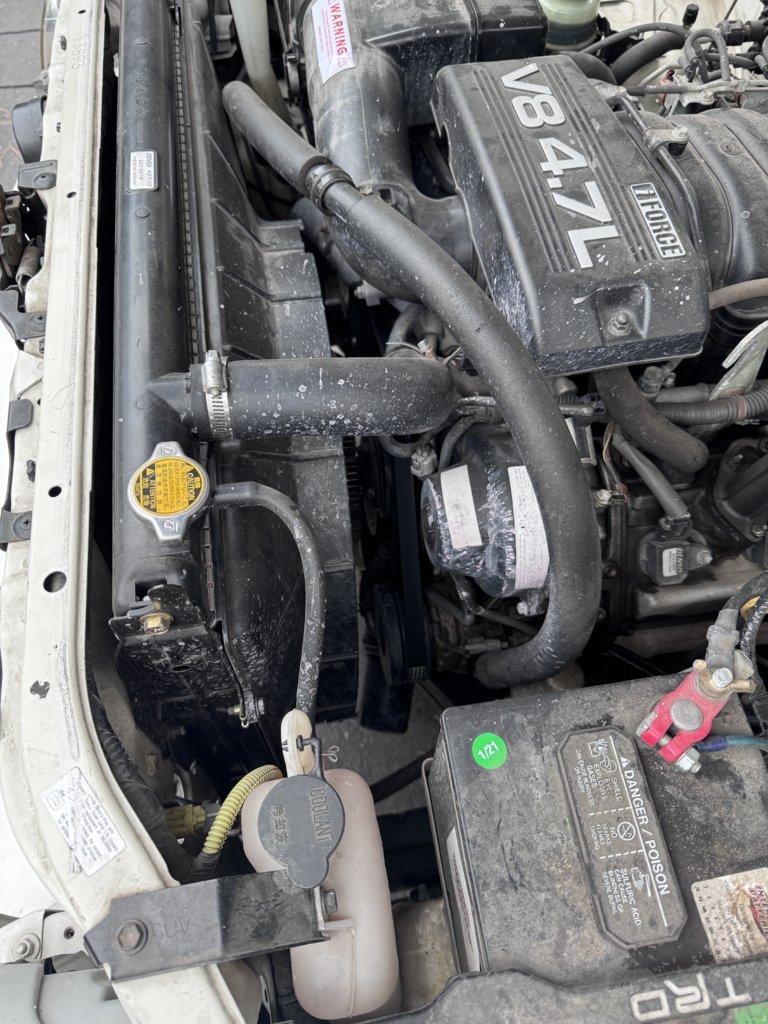

    We just finished up a little cold late fall camping trip and I noticed I had some issues. Here's what's at play:
    2006 Tundra 4.7 with 221K miles towing a 4900lb 23ft travel trailer
    new OEM radiator cap July '21
    new Denso radiator & hoses Dec '21
    new Tstat Dec '21

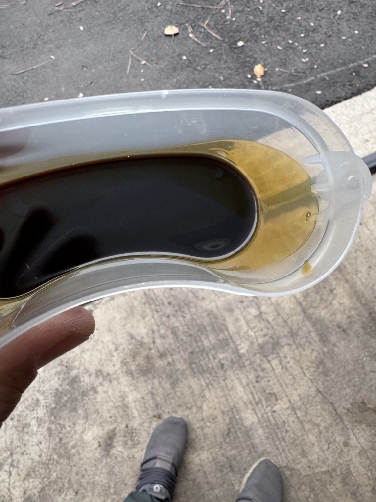

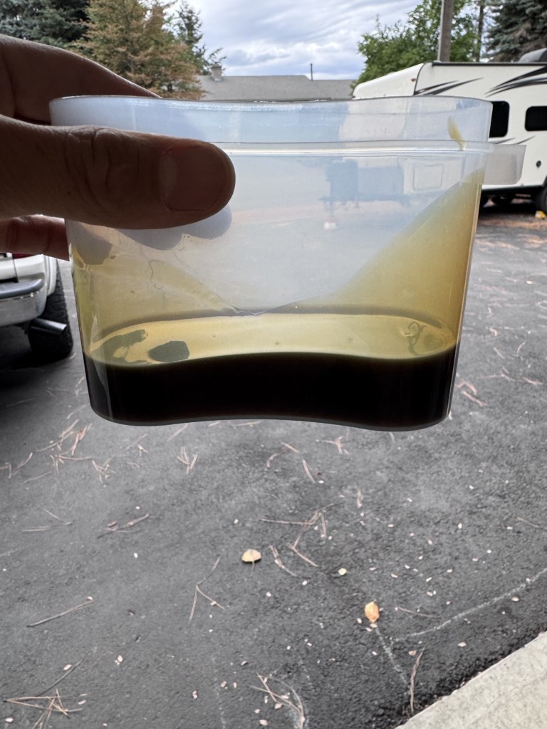

    Have noticed being low coolant a few times and haven't been able to nail it down. While towing this last week for about 160 miles, only 1 grade of which was pretty small but was averaging about 55-60mph most the trip except the last 30 miles being like 15-30mph. Anyways, when we arrived and I stuck the camper where I wanted I noticed my temp was pretty high but not in the red. Filled the radiator the next morning with about 1-1.5qts of water (all I had) so it didn't seem like it was THAT low on coolant but who knows. Overflow reservoir was very low as well. I noticed a bunch of coolant all over the driver frame rail and wheel but couldn't pin it down to a leak anywhere. Got home today from camping and noticed that my overflow reservoir is full and bubbling/boiling.
    I pulled an oil sample and it looks fine.
    Temp gauge when I got home was normal as well.
    I haven't peeked at the water pump ( honestly don't know where it's at)

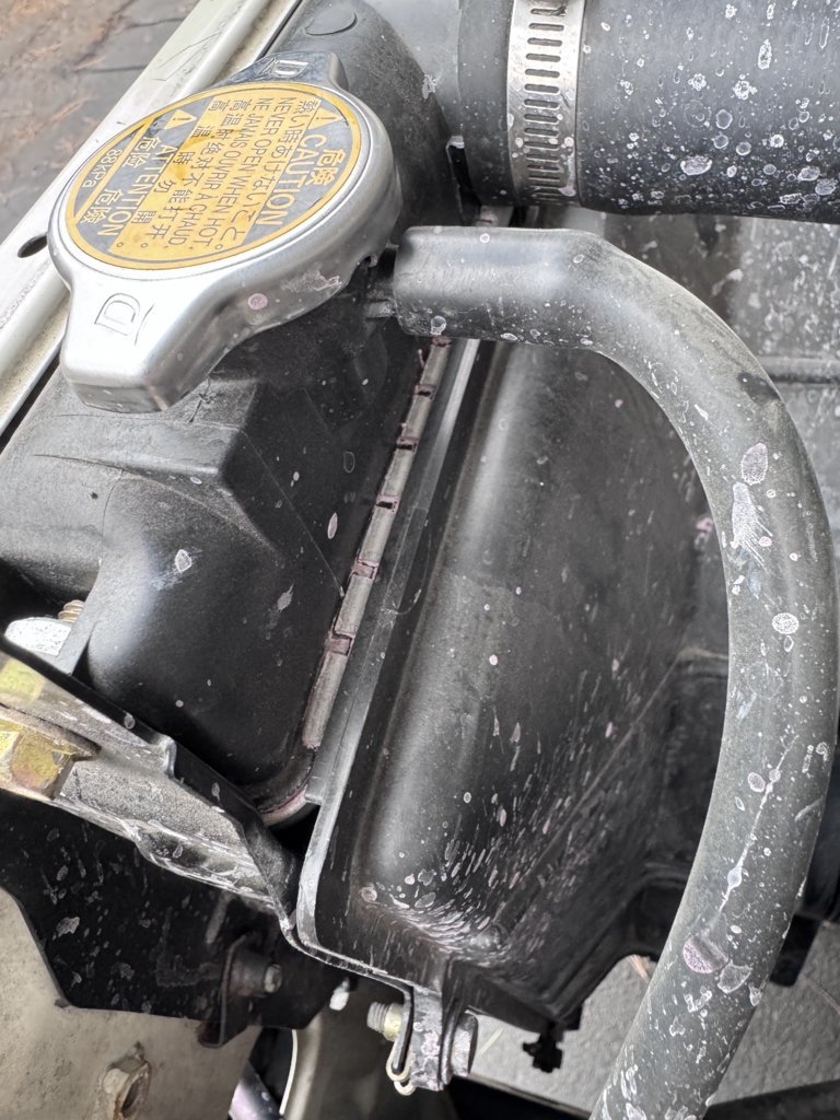

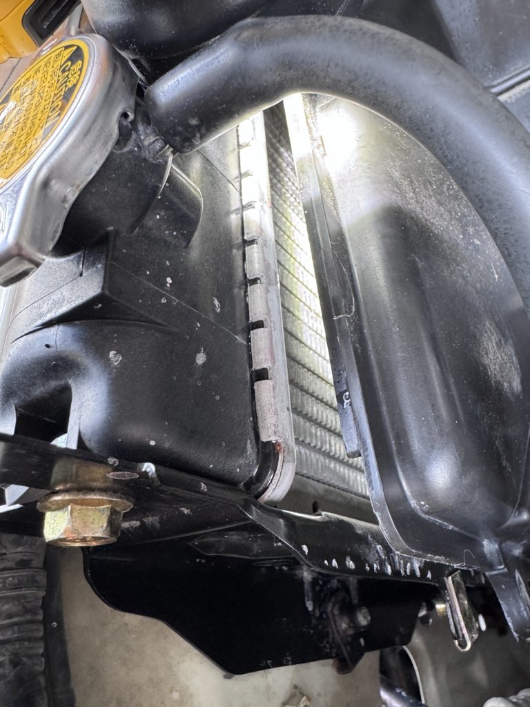

    Radiator top tank crimps look fine, there is some coolant by the cap but I think that's spray from the overflow tank making a mess at speed.

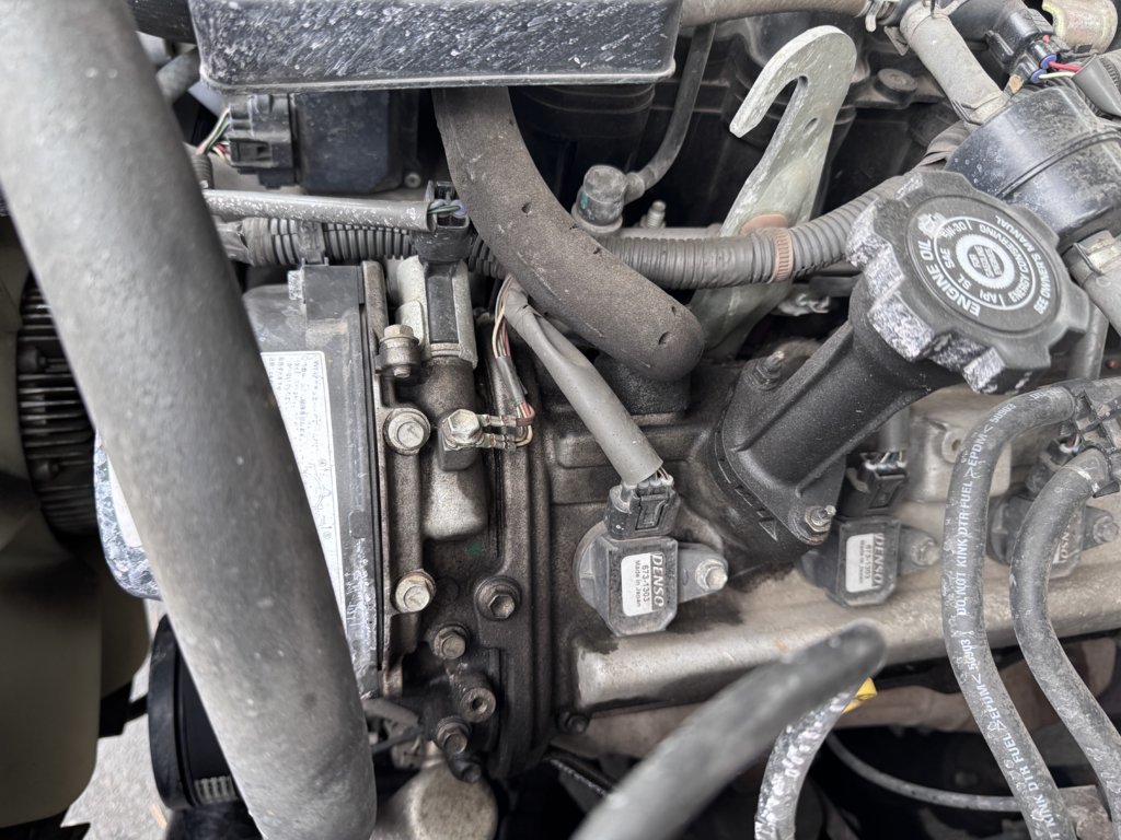

    There is oil leaking from the driver side valve cover which is on my list of To-Dos but I wouldn't think that would affect this.
    There is also oil buildup in front of the oil fill tube which I'm not sure where that would be coming from but again don't think it's related.
    I wonder if it's just too much for the truck to pull or if my radiator is blocked or if I have another issue that I am too stupid to realize. Any ideas, thoughts, or help would be much appreciated. All this in the midst of my wife's Sienna having a cracked upper oil pan and now getting a timing cover reseal and the works.
    Here's some pictures cause I know you guys love pics!

    Crackie towed my 4,800lb, 24 footer just fine. Took that shit like a champ. :muscleflexing:
    The most glaring issue that I personally see, is that you don't know where your water pump is?!?!?!? :eek2: Get to know your rig. Intimate knowledge of your vehicle could save your life one day if stranded on a trail, or the bush.

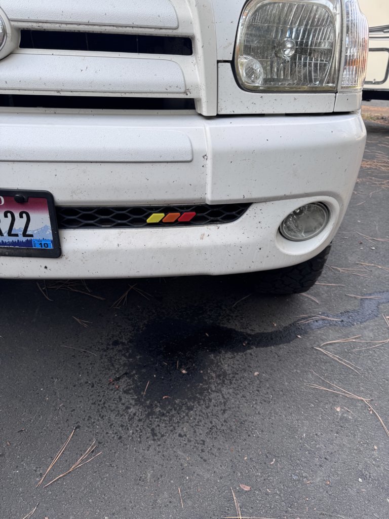

    Overflow reservoir boiling, or... overflowing? :monocle: Your engine should be running around 180 degrees Fahrenheit. Your water, and definitely your coolant should NOT be boiling in a pressurized system such as your cooling loop.
    The splatter pattern looks consistent with at speed overflow reservoir... overflow, and the air blowing the coolant around.

    A partially blocked radiator you’d most likely feel it getting warmer at the bottom and less resistance when squeezing the top hose when the t-stat opens.

    Clutch fan? If unaware of water pump location, when was the timing belt last serviced and by who? Should have gotten a new water pump then.

    Just do a clutch fan test to completely rule it out.
    when the truck is hot, turn it off and go try and spin the fan by hand. It should spin a few inches, a 1/4 turn at most.
    If it spins freely it's done and you need a replacement.

    You can also test the fan by putting a piece of paper on the front of the radiator while the truck is running and the fan should hold it in place. If it falls, the fans doesn’t have enough pull. Assuming you can easily get to the front of the radiator. I’m not sure if 1st gen layout.

    While it’s obvious that coolant is coming out of somewhere near the overflow tank, I’d suspect the fan clutch too. Mine was super super weak.
