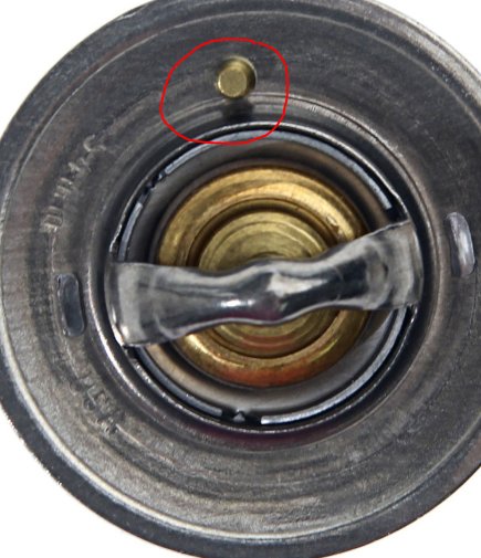

    Did you do the work? OEM parts? The thermostat has to be installed a specific way.
    I'm trying to remember but I believe this part has to be on top when installing. I'm not sure if this would create any issues or not. I just remember reading this at the last minute as I was installing mine.

    The thermostat is upside down I bet, and not letting coolant pass through. Mistakes happen to everyone, unless your mechanic is one of the lizard people or something. Have him double check.

    Yeah, sounds like coolant isn't moving through the system until you let it flow into the heater core. Could be something as simple as a bad tsat from the factory. You can check it by putting it in a pot of water on the stove and bringing the water to a boil to see if it opens.

    I'd pop out that thermostat and see if it opens up when you boil it on the stove. And make sure it's in correctly.:hattip:
