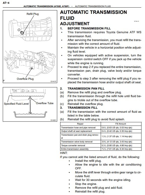

    I noticed that my overflow plug is leaking. If I use my hex head driver to remove it, how much tranny fluid will leak out? I just want to replace the gasket but want to be prepared. Finally, what is the purpose of the overflow plug? American cars do not have them??

    You should only lose the amount that is above the "Specified Fluid Level" !

    2005 Tundra
