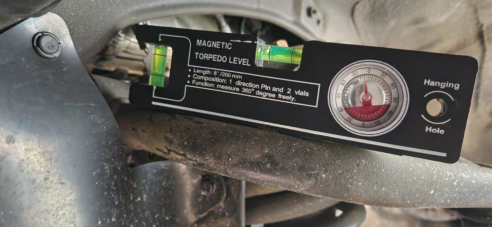

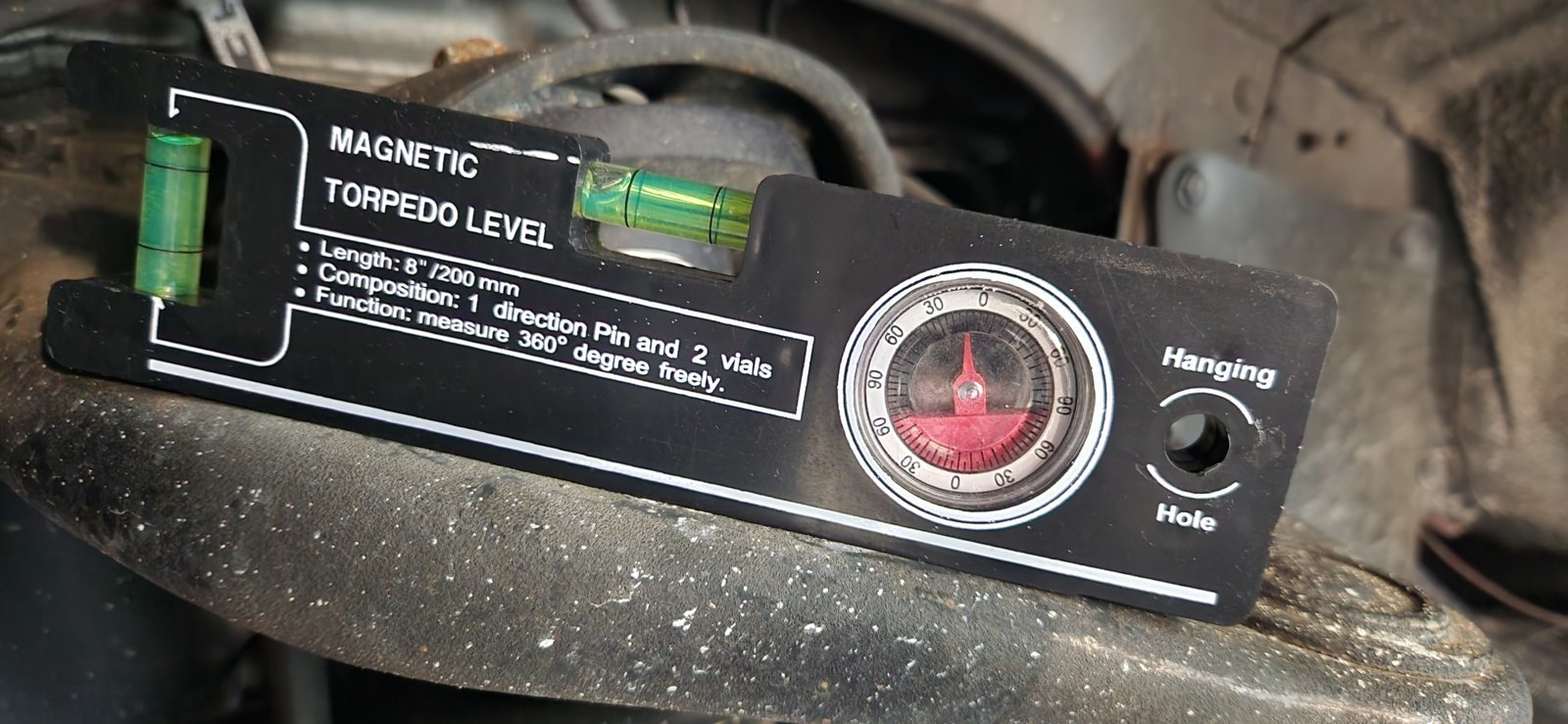

    20231016_111533.jpg 20231016_111542.jpg 20231016_111626.jpg Thanks @KNABORES these are helping me understand the purpose of an aftermarket UCA.
    @Hbjeff, here is a pic and the angle that the OEM UCA is sitting at rest on the truck. Looks like 9-10 degrees, depending on where I put the level. Is that bad/good?

    Do you have your alignment numbers? That angle is definitely steeper than stock, hard to tell from the zoom how much
