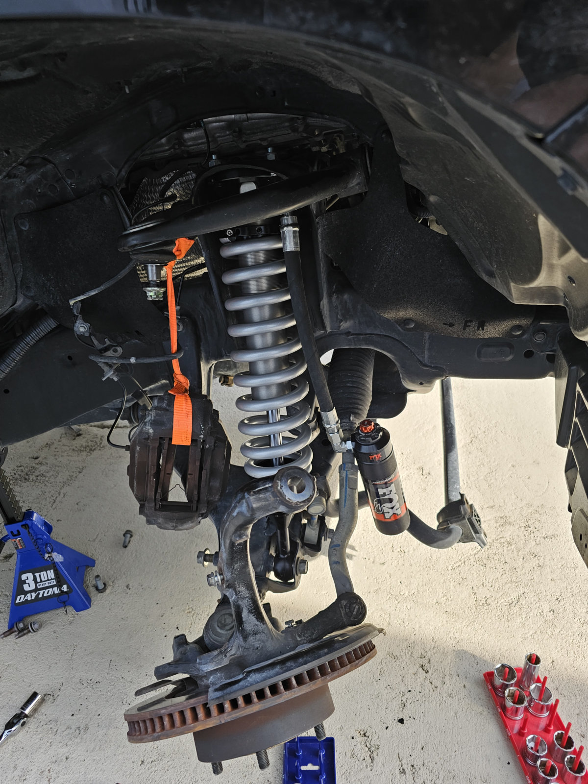

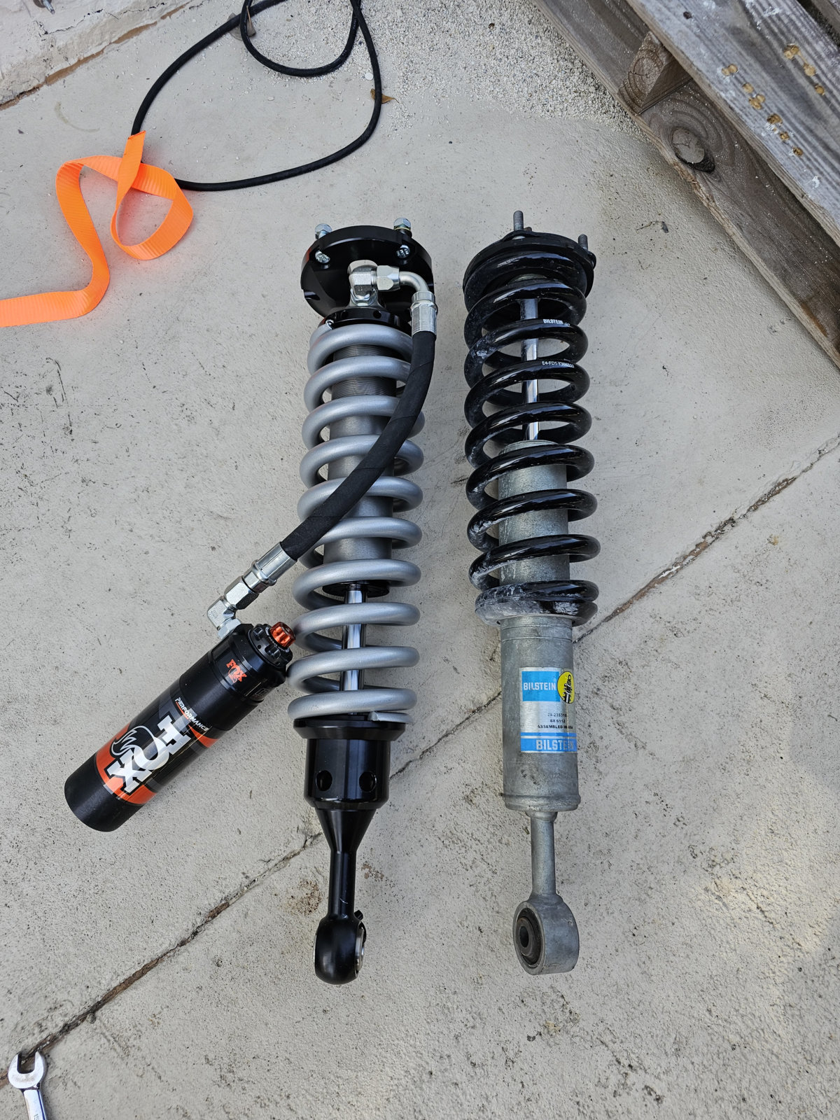

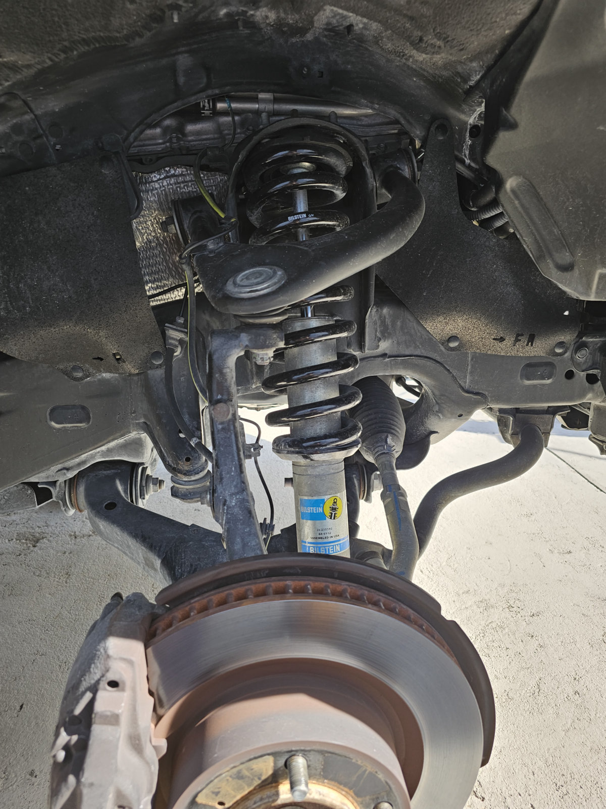

    Installed my Fox 2.5 Performance Elite F/R today. They replaced the Bilstein 6112/5160. Overall a better ride. Not as stiff and takes smaller bumps/potholes way better. So far the only issue is that I got more than 2" of lift. Originally my truck sat at about 36 3/8. When I did the 6112 it sat at around 39 3/4, even that was a little bit over from what Bilstein said it should sit at which is 2.7". The Fox are sitting at the same height, nothing changed. The collar was set by Fox at 1/2 down for the pass side and 1" down for driver side to account for lean. Front end is now level but above their stated height.

    It’ll probably be a little closer to the same height after a few hundred to a thousand miles once the new springs settle some
