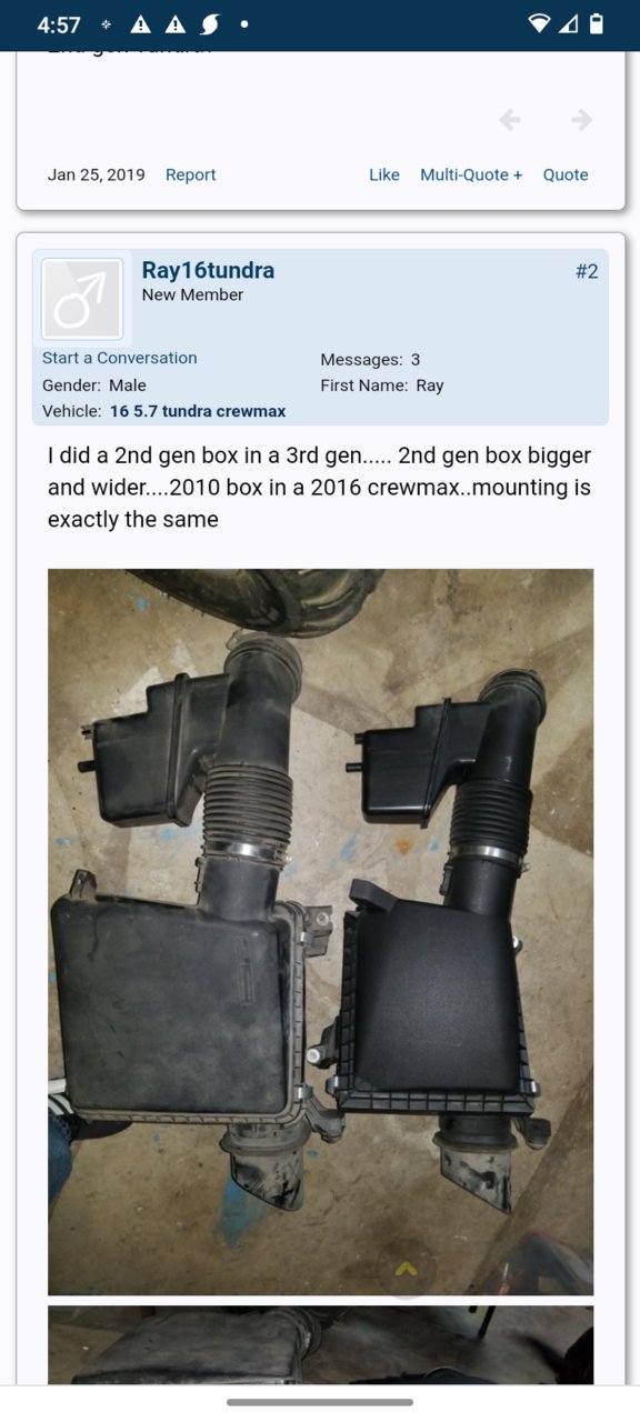

    Depending on the year model you have, there are model years that have larger air boxes than others which still fit and bolt right in.

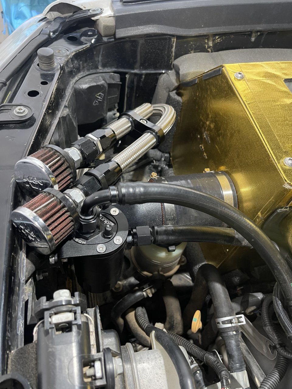

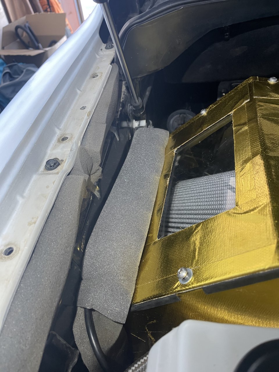

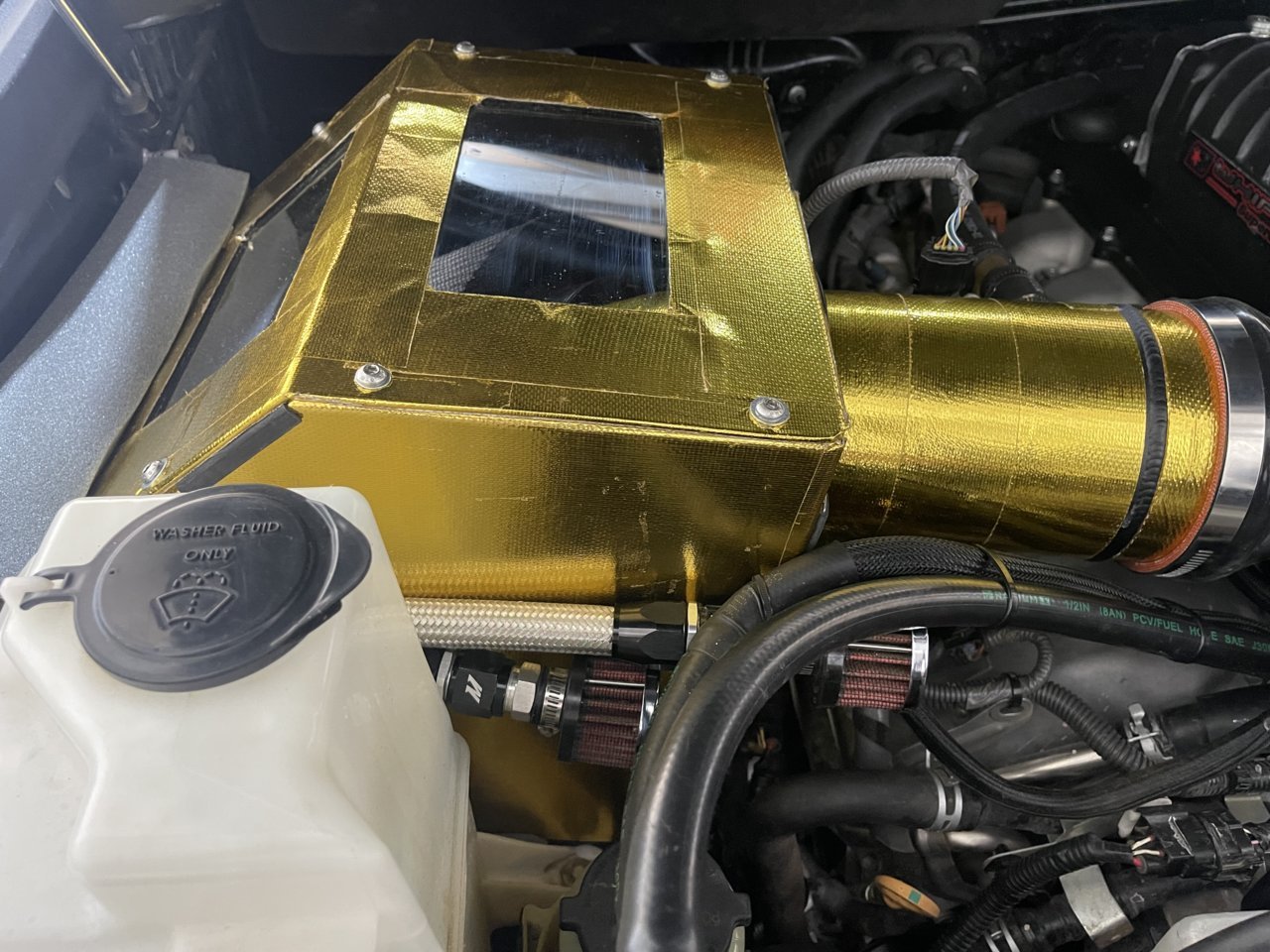

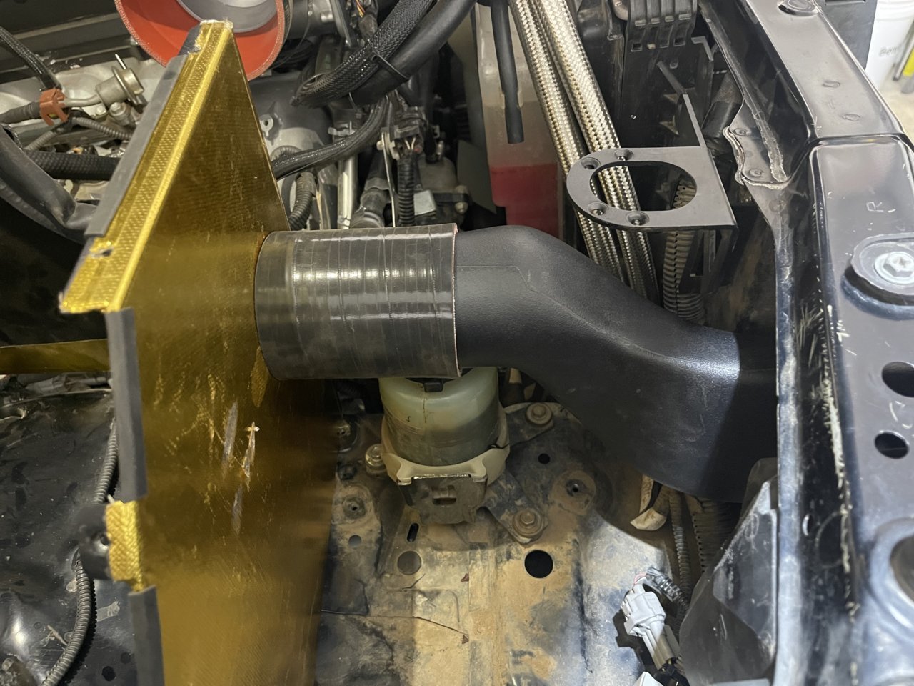

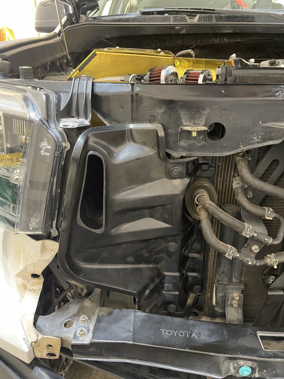

    You could add the stillen pipe to your box. I just did this with my Prospeed box and it made a significant difference in IAT temps.
    TRDblvd, TX210Tundra, biebs96 and 7 others like this.

    Are those secondary air injection filters I'm seeing? I have bought a set of filters already, but haven't got around to investigating what inside diameter size the stock connection is. Do you by chance know or have a memory of the connectors you used?

    Yes exactly lol I also have the sabm. Just for reference in data.
    Stock prospeed box- 60*+ above ambient
    Sealed prospeed box- 30* above ambient
    Sealed prospeed box and stillen tube- 10*-14* above ambient

    The tape definitely helps especially in delaying heat soak like you mentioned. I'd also recommend a few layers.

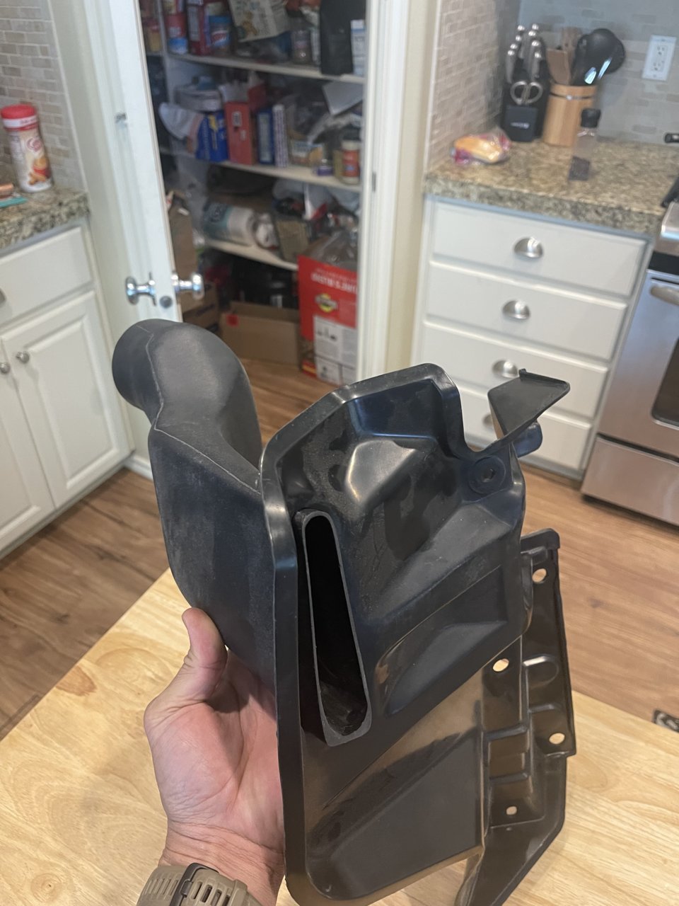

    The boxes are bigger but the air input from the fender is what it is and that is where "more" air will result. Getting a larger opening into the air box is the key not the size of the box

    Until your filter begins to become filled with filtered debris. Then does the size of the filter not matter and allow for more air to flow longer? Pretty sure there is a reason to upsize.

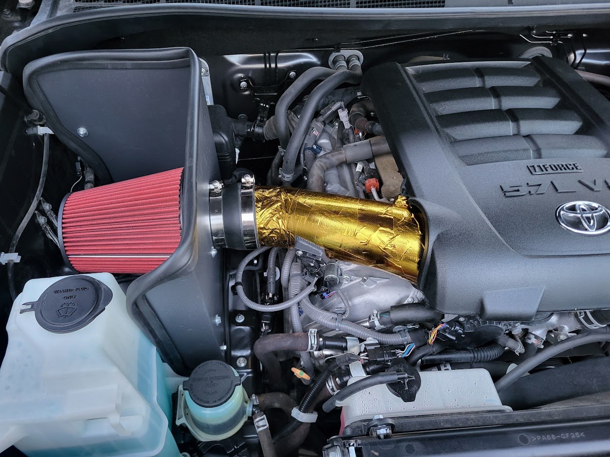

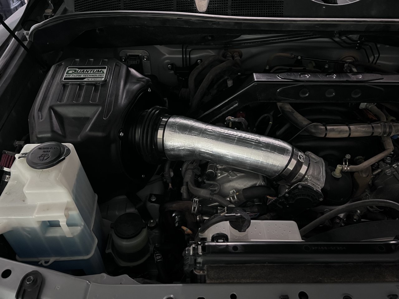

    Got the CAI installed. Heat tape hadn't arrived, and was on a tight schedule, so just installed it stock. The scoop is a joke. Put it on the hood with the supplied tape, and after about an hour on a dark gray hood at 98 degrees, it warped and wouldn't sit flush on the hood.
    CAI sounds awesome, but no noticeable increase in performance or mileage so far. Will have to get the tape installed next week and get back to my normal commuting schedule and see if the mileage increased.
    Install was easy and straightforward.

    Worked on the CAI some more tonight. Took the tube out and applied some decent heat tape to it. When opening the hood after it's been running a while, that CAI tube was HOT. Hopefully the tape helps things a bit.
    After a few hundred miles on it, gas mileage average actually decreased. Probably due to the increased air intake temp. Or the fact that when you stomp on it, it makes an impressive and almost obnoxiously loud sucking sound. Kinda' fun to stomp on it. I've ran CAI kits on many other vehicles, and have never had one be this loud. Luckily, it is only insanely loud when it is at WOT. Under moderate acceleration, it sounds good and turns heads. At WOT, dogs start to howl and children cry.
