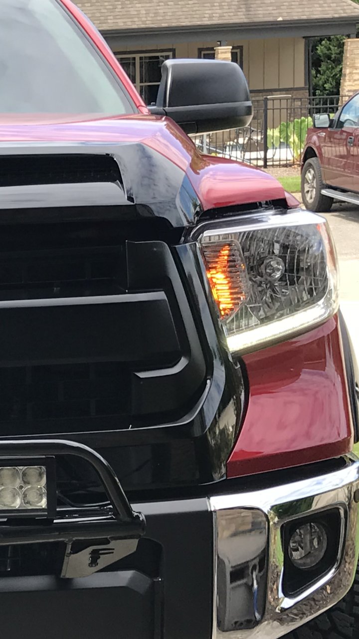

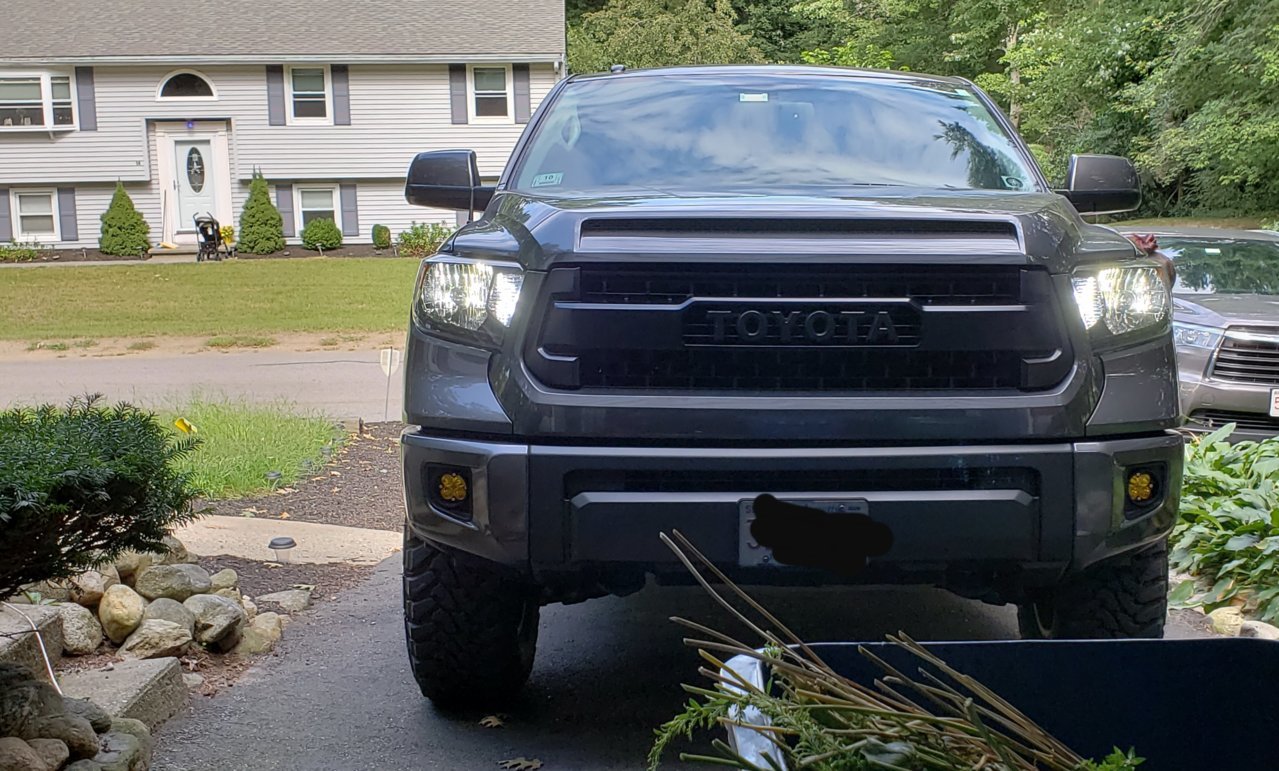

    Just swapped out my orange drl bulbs with LEDs. I never really liked the orange look so I was glad to find LEDs to simply plug in. I won’t really know the true brightness until tonight but so far I like them better72CF8A38-0BEF-4282-B69C-FABF3DC0244E.jpg49CF984A-C2E1-4FFC-AF67-C536613C29DD.jpg

    Disregard the orange light swap. Got in this morning to go to work and had no blinkers. Re installed orange bulbs and will keep searching

    There is a store near me that sells a LED light that when in daytime running light those are white but still blink amber for blinkers. They were to expensive for my taste so I never bought them for my 2013. That kind of option is out there FYI.

    This may be a dumb question. Did you try turning the bulb 180? Aren't LEDs polarity sensitive?

    Just did mine. Got the switchbacks from headlight revolution. Had to wire a resistor in to make them work right.
