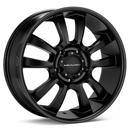

    I think I'm going to go with KMC Skitch's.
