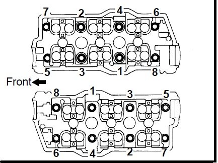

    Just trying to save you some coin! Correct torque on valve cover bolts on our '05-'06 is in INCH LB, not FT LB - important distinction there, you don't want to snap a fastener - and you're aiming for 53 inch lbs per the FSM which is in the ballpark of 4.5 ft lb if my math is on-point.

    I wouldn't call it special but personally I choose to adhere to the "uniformly" procedure mentioned in the FSM. It's similar to alternating when tightening tire lugs or even cylinder head.
    cylinder head bolt sequence as an example....
    JQ3[QUOTED][OP] and shifty` like this.
