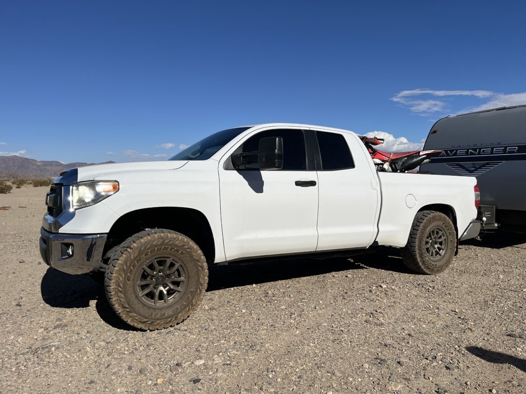

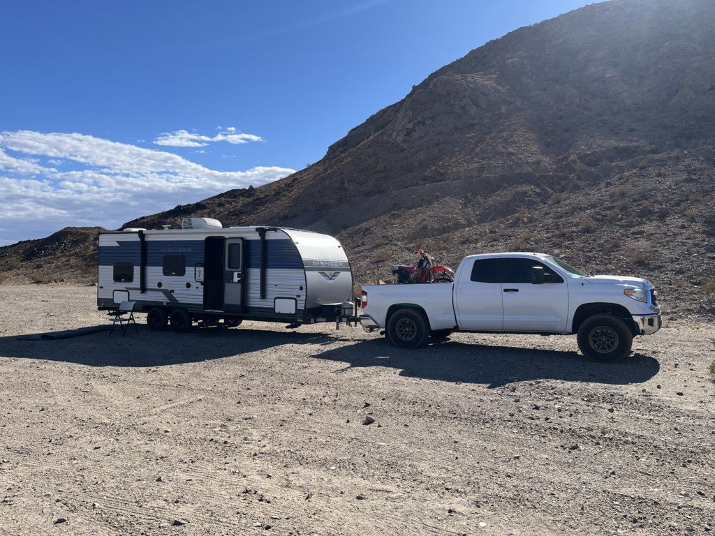

    Different kind of horses for me…
    I’ll regear eventually and possibly to the RAS for the rear, but it works for now. To @KNABORES point, everything a stock truck does, a lifted truck does worse except looks better when doing it. My 2014 has been lifted for five years and I have no regrets.

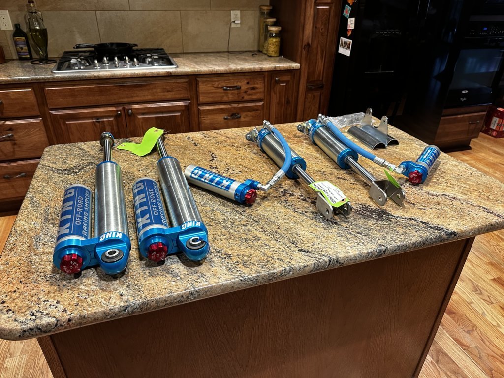

    - As others have said, a lifted truck is not as optimal for towing. That being said, you can do some mods to minimize the impact. Using an adjustable front shock, lower the front back down a little. Maybe only go 1.5-1.75" (this is what I did). Keeping rake is a really good idea with the tundra and the traction control. When towing with my 2012 Tundra my front end traction control would go off all the time in corners no matter the speed when the truck was level. Once there was at least .75" of rake, no more problems. Toyota has some of the most sensitive traction control on trucks that I have ever driven.
    Stock with heavy load:
    Front lifted 1.75" towing similar weight:
    -smaller tires...at least drop to a 33" since dropping the front end is a good idea. Re-gearing is expensive and you most likely will never recoup the costs. The driving experience will be a lot nicer though.
    - Performance shocks are a two edged sword. When set up properly they are amazing. My King 2.5's are set up a little stiff when empty but when fully loaded the truck handles amazing.
    with adding heavier tires (52 vs 58 lbs), 265 vs 275, and lifting 1.75" it took my fuel economy down 1-1.5 mpg.
    Having a performance shock does mean added maintenance. You should have a N2 fill kit at a minimum and check pressure every 3-6 months. Rebuilding a king shock is rather easy. It will take you longer to pull them off than rebuild them....or you can pay to ship and rebuild them. I would also look locally for a shock rebuilder.
