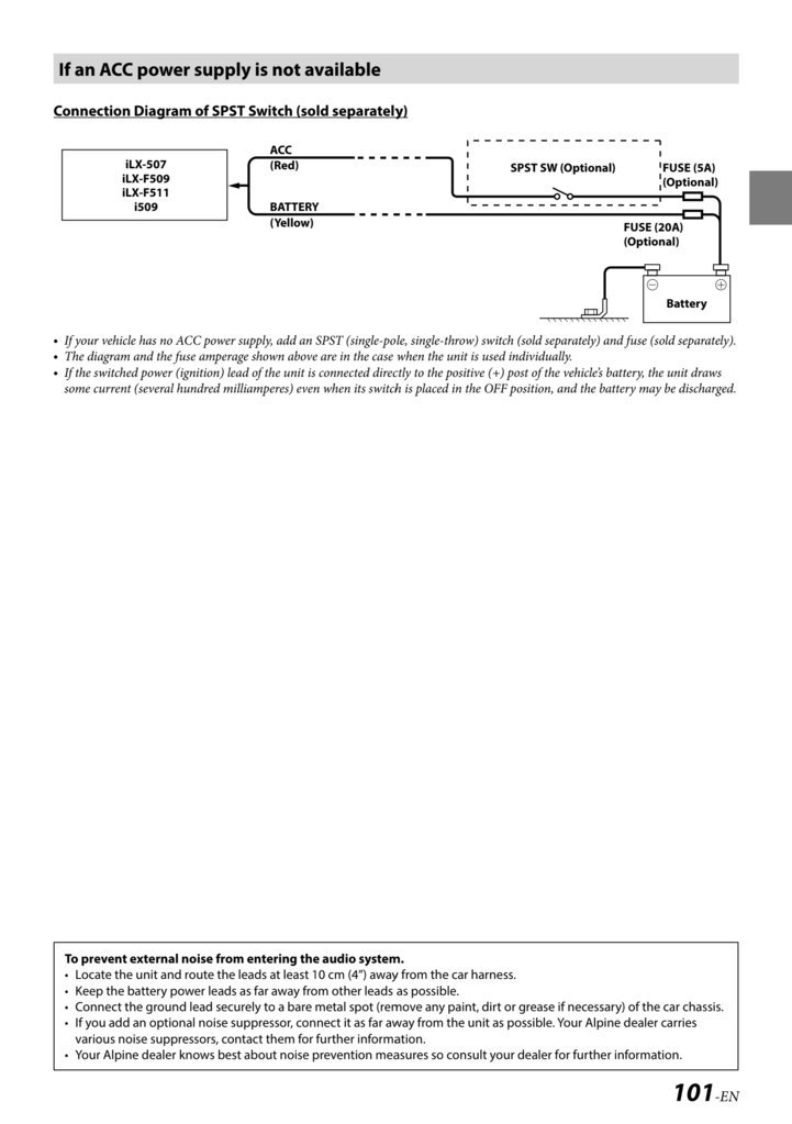

    Only ON/OFF is ignition keyswitch. Would it be impossible to add a simple in-line switch between one of the power leads of the harness, to minimize batt draw while parked w/ACCESSORY On [ex: need to be able to operate windows but dont want audio ON]

    All good points and Im still leaning toward the 507. As far as amp draw by the 507 when "OFF", the OM states small ["several hundred milliamperes"...continuos memory circuit?] draw is still an issue. For most peeps that drive more than 1x/week, likely not an issue. Im concerned about parasitic amp draw since I only drive 1x/week or less.
    OTOH, any chance the Tundras' ECM doesnt like an 'appliance' outside its ACC/ON/OFF switch? In that case, maybe just as well wired dIrect to ACC/ON/OFF as most installs do.
    Here's the Alpine OM page on that:
