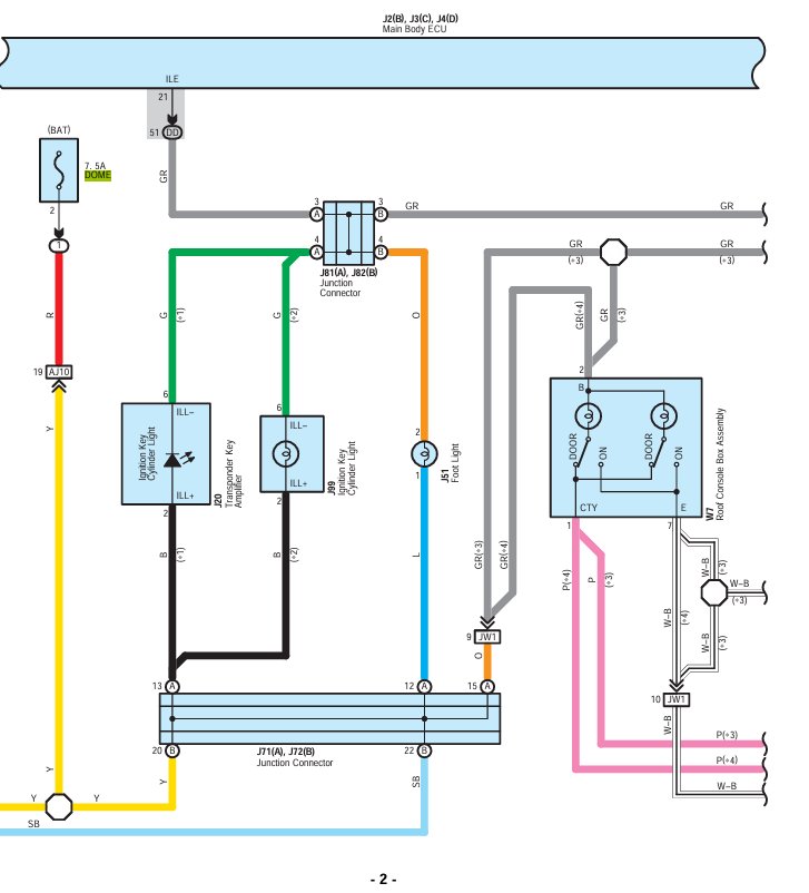

    Okay, so my 2008 crewmax has working dome lights, but my passenger front bulb will not come on with the door lights. The bulb turns on when you click the light on manually, but not with the door. Again, it’s only this one bulb doing this. Any help is appreciated!!

    That is odd since both bulbs share the same feed.
    Did you try another bulb?
    I know those contacts can be a little tricky at times..
    It would seem more likely to happen the other way, come on wiutht he doors but not with the switch.:confused:
    Perhaps taking the console down and cleaning the switch and bulb contacts with contact cleaner.
    Inspect the circuit board as well..
