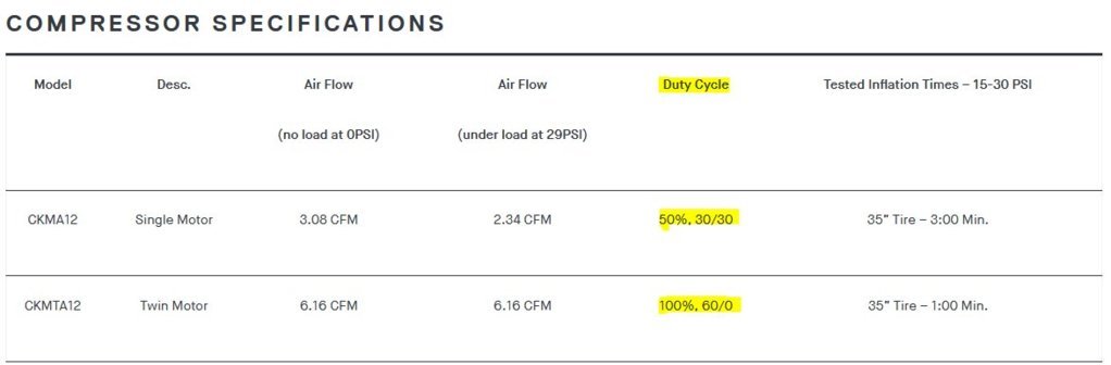

    After lamenting the drive for the annual fishing with the high school buddies I recently installed a pair of Firestone air-bags to counter the load of gear and 5 adults. The good news is they performed perfectly!
    I bought a basic kit that didn't include the compressor and am trying to plan how to proceed next. I can either buy the bluetooth kit that only serves to fill the bags and be done with it OR the other idea was to add a small ARB onboard compressor that I can fill the bags, top a truck tire or really anything.
    Just curious if anyone has experience with the smaller ARB compressors (not the duals or the brushless systems) and has an opinion to share good or bad?
    Thank you in advance!

    A single could handle airbag duty, or topping off a tire. However, if you're airing down for example, and trying to pump 4 tires back up to pressure you're going to run into some heat soak, and will likely need to cycle it.

    The single ARB would work just fine for filling up your bags and your tires. The twin ARB is mainly a convenience item for most people unless they are running power tools or constantly using the compressor without shutting it off.
    If you run the single ARB for 30 minutes straight, it will need 30 minutes of downtime before it can be used again. The twin can be ran continuously. I don't see you running the single for very long and constantly needing to use it in your circumstance.

    You both nailed it perfectly as it'd just be a means of primarily inflating bags with a little flexibility. I don't take her offroad a whole lot so topping up to a single tire inflation would be all I need out of it.
