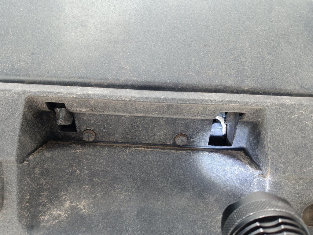

    I broke mine on my 2010 about a week ago (second time in the last two years), so I ordered a metal one this time. Factory one is cheap plastic!
    Meantime I can easily use a flathead screwdriver to open it. If you can see in there it's super easy.
    I also have a tonneau cover and it's no problem. If you want a video let me know.IMG_20250104_112250.jpg
