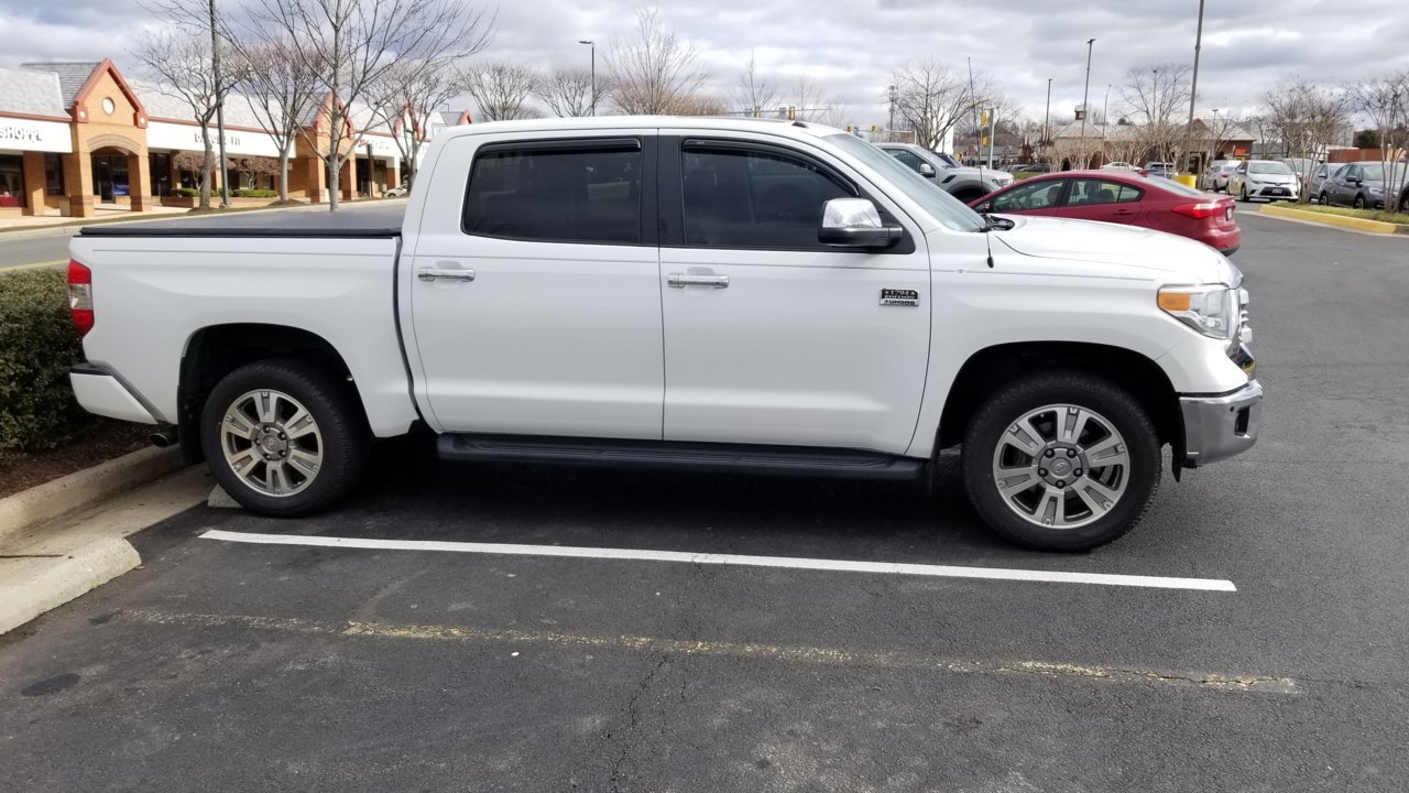

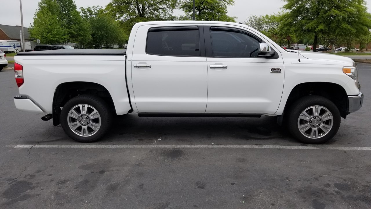

  14. May 18, 2020 at 6:34 PM
    Seafury
    Seafury [OP] Kickin names, and takin ass!
    Jan 22, 2020
    #41619
    603
    Agent K
    SC Low Country
    2014 White 1794 "SnowWhite aka the Frost Queen"
    Bilstein 6112/5160, 3 CB front shims, SPC UCA's, CB +3 rear Shackles, total 3/2 lift, Dif drop, CB Carrier bearing drop, Fortin Evo One remote start from Tech12volts PnP, AMP research Powersteps PnP, Vent shades, Tinted windows, Black/Red lined cupholder inserts, Proclip USA dash phone mount with Scosche Magic Mount wireless magnetic phone charger, Stock wheels/tires for now.
    I agree. These aren't great but she's my baby!
    This is before.
    This is after.
    Pics suck. It's much bigger in person.
    So she told me anyway.... Lol.
    Drives awesome, looks awesome, finally looks and feels like a real truck should.

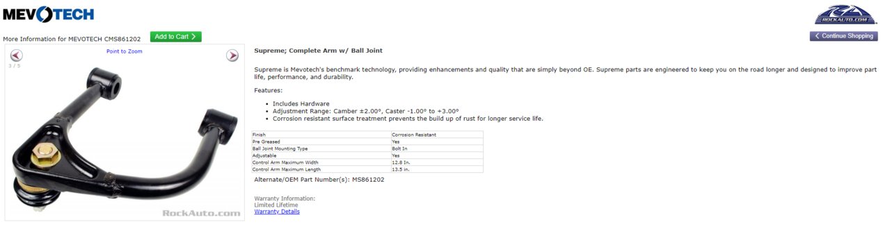

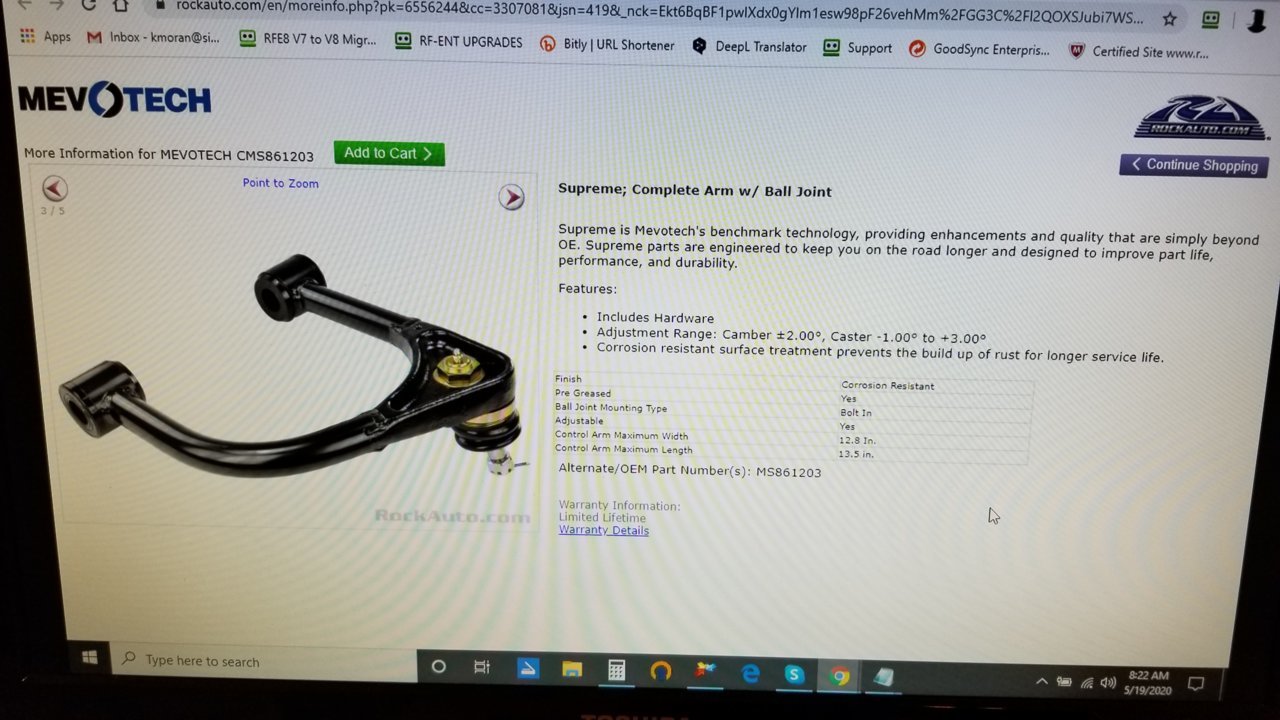

    Update and report on bad vendor.
    Do not purchase from Rockauto.
    They do NOT stand behind their parts.
    They sent me right side SPC UCA with gen 2 greasable ball joint, and left side with gen 1 non greasable ball joint. After going back and forth with their horrible online only return system, No phone support at all, they told me to bad, the manufacturer can send whatever they want.
    Their listing pic shows greasable ball joint.
    That's what I paid for, that's what I expected.
    They refuse to make it right.
    So I just called Capital One and issued my first ever charge back.
    I warned them there would be repercussions for burning a first time customer.
    Do yourself a favor and stay away from Rockauto.
    I will never so much as look at their website again.
    Cheapest prices mean cheapest service, or lack thereof lol.

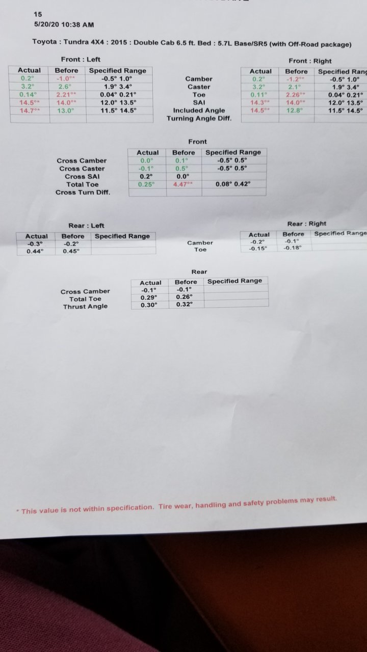

    So I paid a "trusted" shop to get it aligned today.
    That was fucking painful.....
    Drives real good. Here is the spec sheet. I asked for the alignment specs I found on socals sticky. Thanks dude!
    As mentioned the front cams on the lower control arms where frozen. They could not break them, they had to cut them off, but they were able to airhammer out the remaining pieces of bolt. They also replaced the rear cam bolts, all with parts I bought from Toyota.
    They claimed they antiseazed the shit out of the bolt bodies so they will never freeze up again...
    I think I over paid by a hundred or so, took them about 4 hours, but whatever it's done now.

    Best I could find was $275 per lower control arm. No I could not do this at home in my townhouse parking space. I had to borrow a buddies shop (1 time deal) to do the install, and we could not remove them there, so no way I could at home.
    Cam bolts same deal, no time to wait on orders, and I needed the bolts not just the end nuts, bolts were frozen in sleeves.
    No, no other ball joints or steering bushings were needed, the truck is a 2014 with 57k miles in great shape, no rust even, except some on TRD exhaust. Don't need to buy shit I don't need right now.
    I was budgeted for about $300-350 for alignment but shit happens.

    So your running one greeseable and one non greeseable UCA?
  25. May 21, 2020 at 9:44 AM
    #25
    ckkone
    ckkone New Member
    Feb 15, 2020
    #42674
    244
    SLC, UT
    Sorry to hear about the ball joints not matching. Its really not going to cause an issue, I'd probably just roll with it and when the time comes you can get replacements for under $150 (part no. SPC 25002). One thing about SPC is the ball joint they use is not the greatest, even the greaseable ones still have failures. I've returned a few items to Rock Auto and never had an issue, only problem is you might get sent the same item if you reorder.
    Might not hurt to call Mevotech directly and explain the issue, I'd be willing to be they would make it right.
    Mevotech 416-783-7800
    Sucks but Rock Auto does show the right side part number CMS861202 with the non-greaseable ball joint, they may have run out of the greaseable ones. So maybe not entirely their fault.

    Your right it will not cause an issue, it's just not what I ordered.
    Thanks for the heads up on reliability. I won't be doing more then VA snow and OBX beaches so I expect them to last a long time, we shall see I guess.
    My issue is the left arm which shows a greasable ball joint. The right does not show it, but I got one anyway. This shows a lack of concern, attention to detail, and care for your customers. They don't deserve my money.
    This is my first and last order from Rockauto.
    I will try calling mevotech but I didn't buy it from them so I doubt they will care. Rockauto also tried to tell me this is how it works, even the manufacturer doesn't garuntee greasable ball joints, you get what you get, but that's just not true of SPC, so they also lied to me.
    As mentioned I will replace it when it fails, or when my Chargeback clears and I can use the same money to order a greasable ball joint from some one else.

    I just thought of something.
    Should I do the zero point calibration for my traction control stuff after this lift?
    Drives fine so far FYI...
    Thanks for everyone's help!
  29. May 23, 2020 at 6:14 PM
    #29
    Tundra234
    Tundra234 New Member
    Nov 30, 2018
    #22402
    18,080
    George
    Florida
    2020 Tundra DC SR5 Barcelona
    Alot of them
    On the Tundras, the Zero point is one of the steps in the alignment process. I don't know if all shops do it or not. Someone posted a while back on things to check to see if you need a ZPC done. It's been a while so I would have to search for it. The greasable SPC balljoints are around $150 for the pair. They do Not come with grease in them, so keep that in mind.
