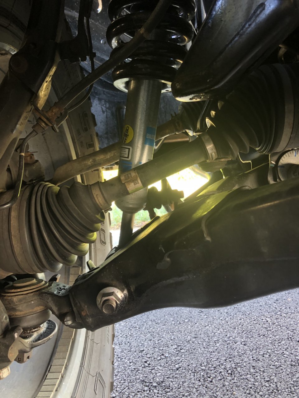

    I put OME medium duty coils with Bilistein 5100 set on the lowest height. From the ground to the fender it measures 43 inches in the front. From the hub to the fender 27 1/2. Does anyone know how many inches is this? I’m thinking about 5.

    The OME coils are longer they provide 2 1/2 lift due to the preload. Even if the Bilistein are at the lowest setting. Was told they don’t pair well together but you can make it work. My cv axles are flexed but I plan to buy extended travel one for lifted trucks.

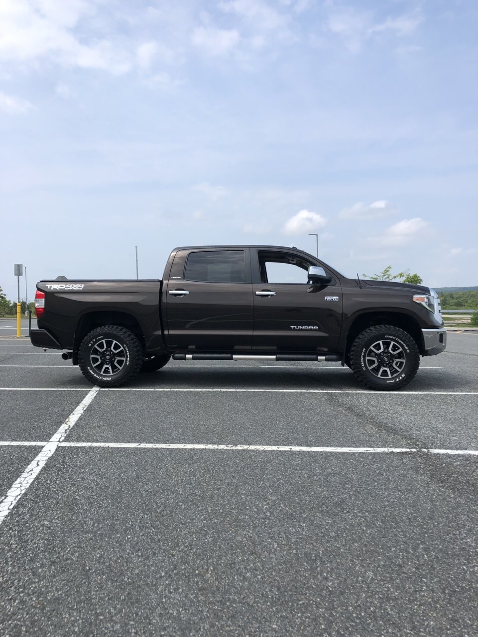

    I had a 2 inch spacer on prior that gave me 3 inches. This is the 3 inch photo, I didn’t measure it before the last mod.

    It definitely looks taller with the 5100s & coils than it did with the 3" spacer. Are those the 614 coils? 4.7 or 5.7? I'm looking at doing the 612 coils with my 5.7.

    Yikes. Most 4wd’s sit around 36” +-.5” to the fender with a stock tire. I believe I was at around 36” drivers side, 36.25” with a stock suspension and tires. 6112’s on the lowest setting and one shim on the drivers side put me at 38/38.25”.
    If you were running 35’s (or the 34.5” metric equivalent that most run) you are only gaining an inch to inch and half from sidewall height. That means you are getting 5.5” of lift from a coilover. Bad news for your stock components, especially CV’s. Considering the truck only has about 6” of downtravel in the front, you are going to be hopping over everything.
    If you are going to leave those coils in there, I would at bare minimum do a diff drop until you can get those new CV’s. And I would probably leave the diff drop in place even with the new CV’s.

    Idk I got a 2” lift and my hub to fender is around 24” I think you have a 5-6” lift

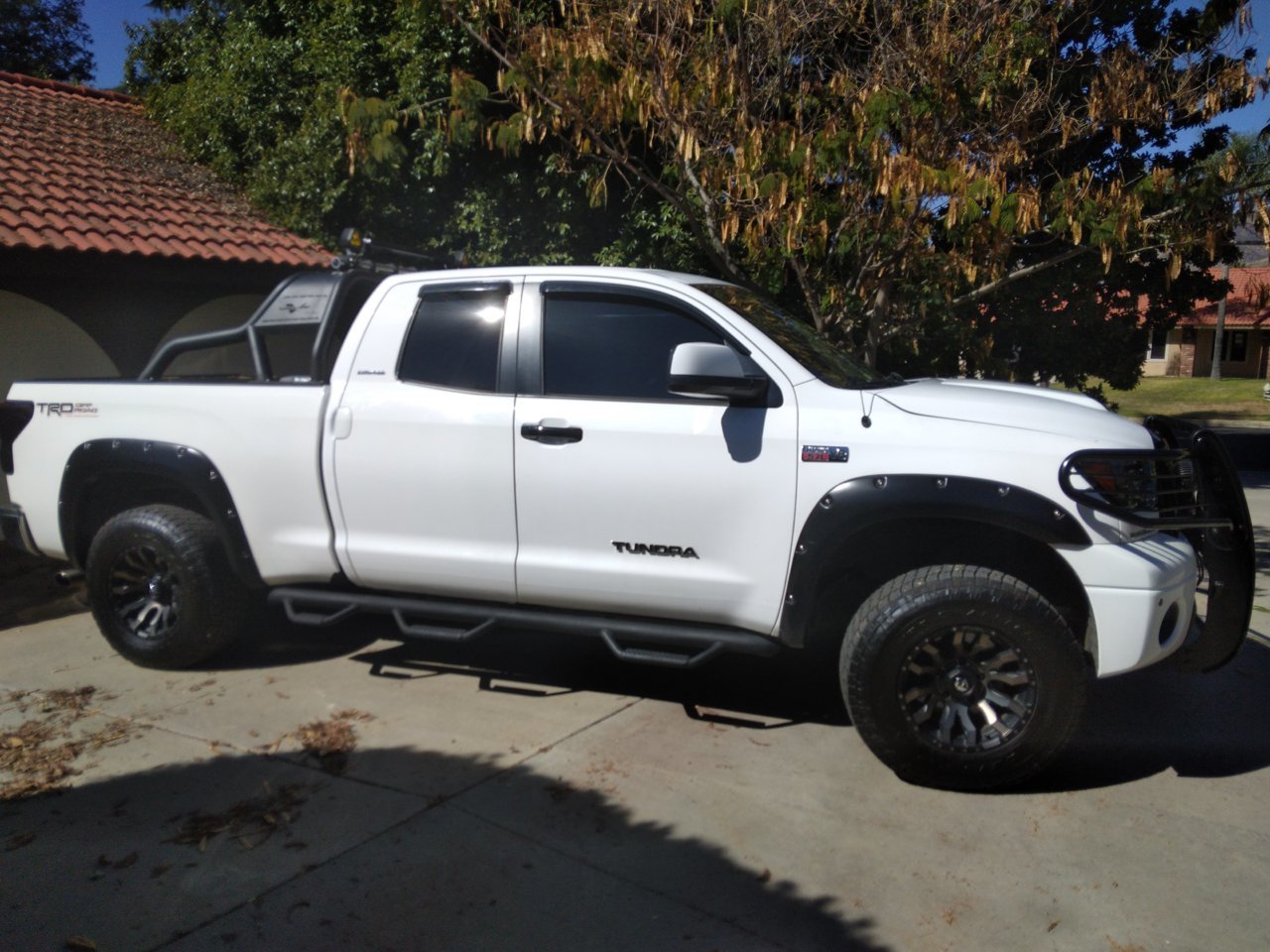

    OME nitrochargers and the 2612 coils ride/look awesome. Tried using other coils with 5100s and was too much of a pain to get the look and the ride just right. OMEs are designed to work together, and if you aren't going to load your front end up with weight, 2612s are a good choice. Looks like you are going for a higher stance though.
