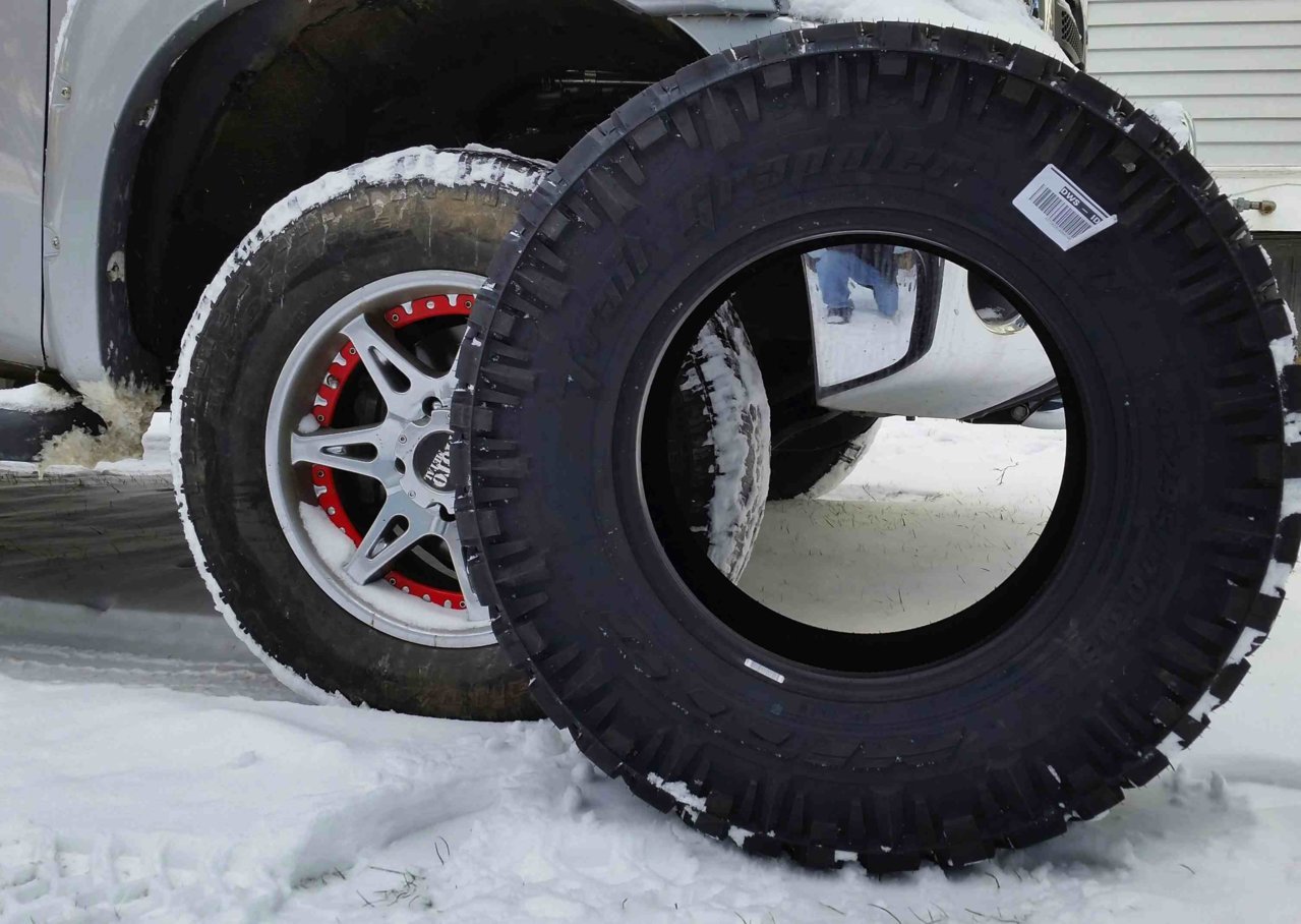

    I have 3 & 1/2 inches from the OME 614 coils. The tires were rubbing in the front. I had to take the small flaps off, then loosen the whole plastic liner, push in the liner (I think about 3/4 inches) then made another hole and rescrewed. The rear side, I was lucky enough not to have to cut the body mount. But it was verrrry close. These 295s are no joke. My fav pic of comparing 295/70/18 to the stock tires . . .
