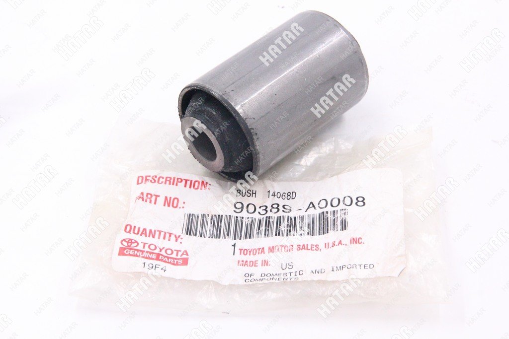

    To anybody with Old Man Emu leaf springs on their 07-21:
    Are you using poly bushings or OE rubber bushings?
    I went with poly for the “added performance” but I’m tired of the squeaks (yes they were installed correctly)
    I can quiet them with silicon spray but they squeak again in a week
    Thinking about swapping to the OE bushings, do they fit the Emu spring eyelets?

    You don't have the OME greasable bushings/shackle kit? An example below is for a Tacoma but pretty sure they make them for the Tundra Need the bushings also

    ARB gave me an ID measurement of 40mm on the dakar leaf spring eyelets, but I can’t find the OD measurement of Toyota’s bushing. Part guy at my local toyota didn’t have one to measure either. If anyone has this measurement it would be extremely helpful…

    Also, if anyone could provide the inner diameter measurement of factory leaf spring eyelets (07-21) that would tell me right away if the stock bushings would be compatible with my dakar springs…
