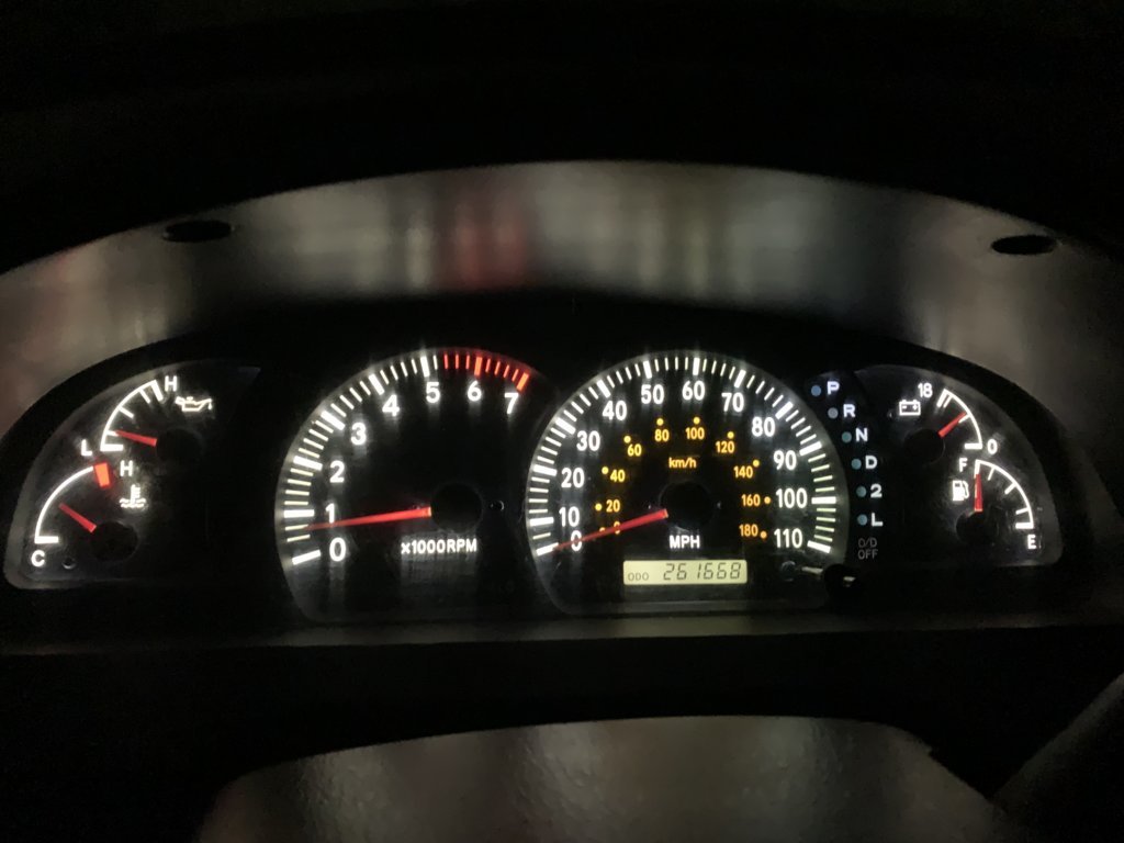

    My 2000 oil gauge at idle
  7. Jan 9, 2025 at 3:54 PM
    woodamsc
    woodamsc New Member
    Sep 5, 2024
    #122442
    83
    New Hampshire
    2003 Tundra v8 4.7l 4wd sr5
    boy that's a clean dash wtf
  8. Jan 9, 2025 at 7:27 PM
    BroHon
    Sep 19, 2023
    #104169
    2,477
    Bro
    Location: Bitch Mitten
    2000 SR5 AC 4x4 4.7
    Weight reduction, mostly rust.
    HAHAHA, for right now she's a street queen :rolleyes:, but that's about to change when we move more rural or even "remote"
    I keep stuff clean though, and Usually only drive to and from work atm.
