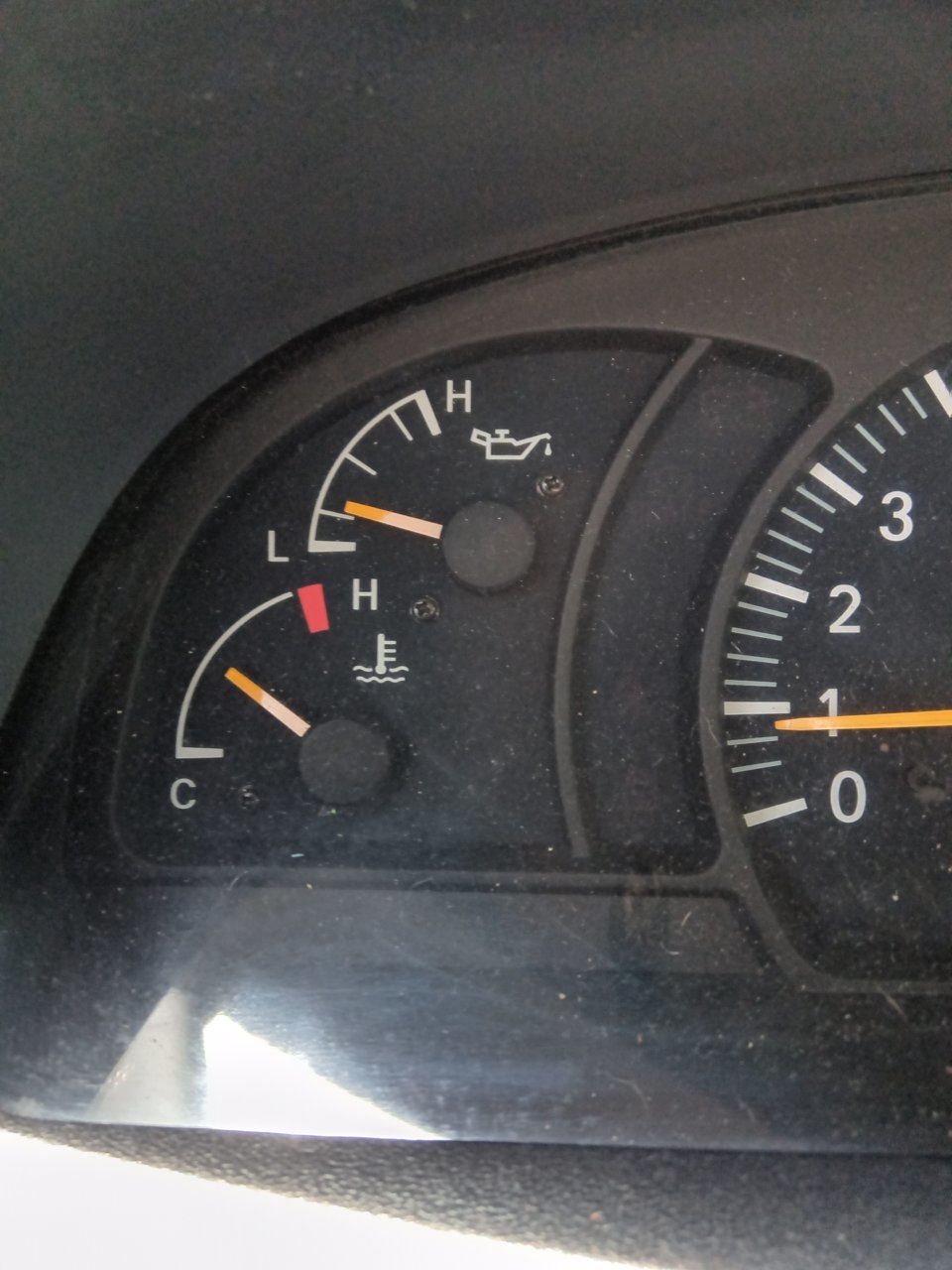

    My gauge used to hit at the very bottom mark when at idle in the heat.
    I put Rotella 15w40 and now it stays at a better place

    Understandable. My recommendation to everyone noting low oil pressure has been to move up to the next grade and observe.

    The real test is to put a psi gauge on and check what it really is.
    You may not have any issues. Thr dash gauges aren't the most accurate.
    I've gone to 5w-20.

    Yup. 2uz only calls for 6psi of oil pressure at idle so it looks low because it probably really is. I agree though that it looking that low causes concern to people.
