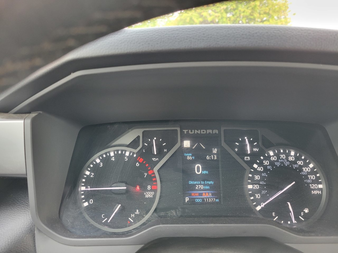

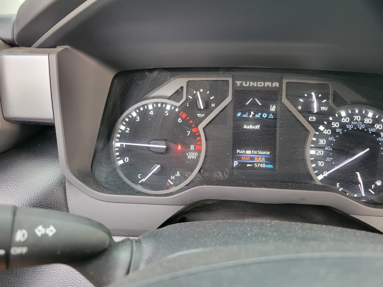

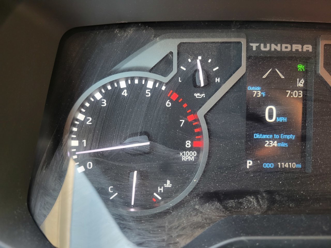

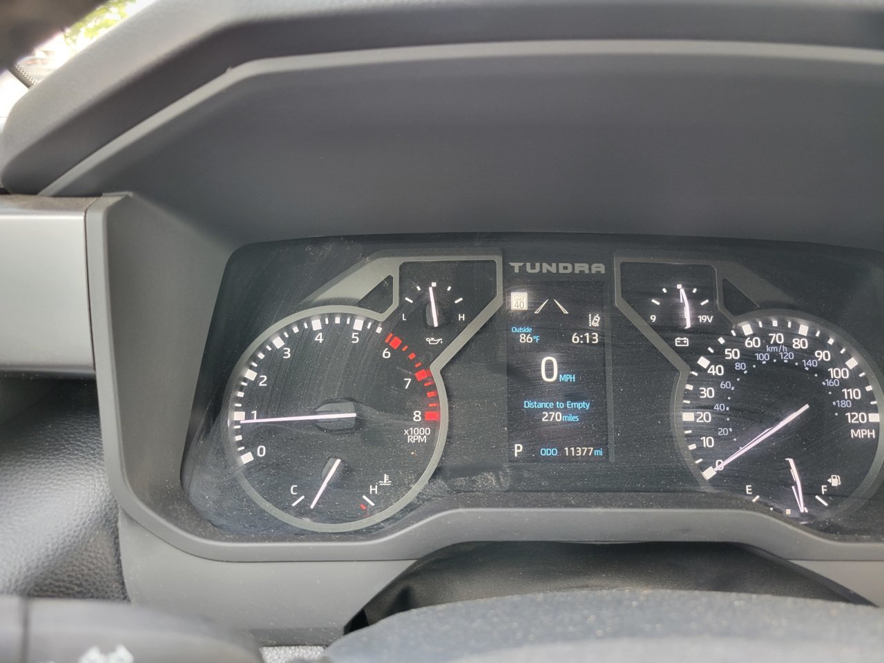

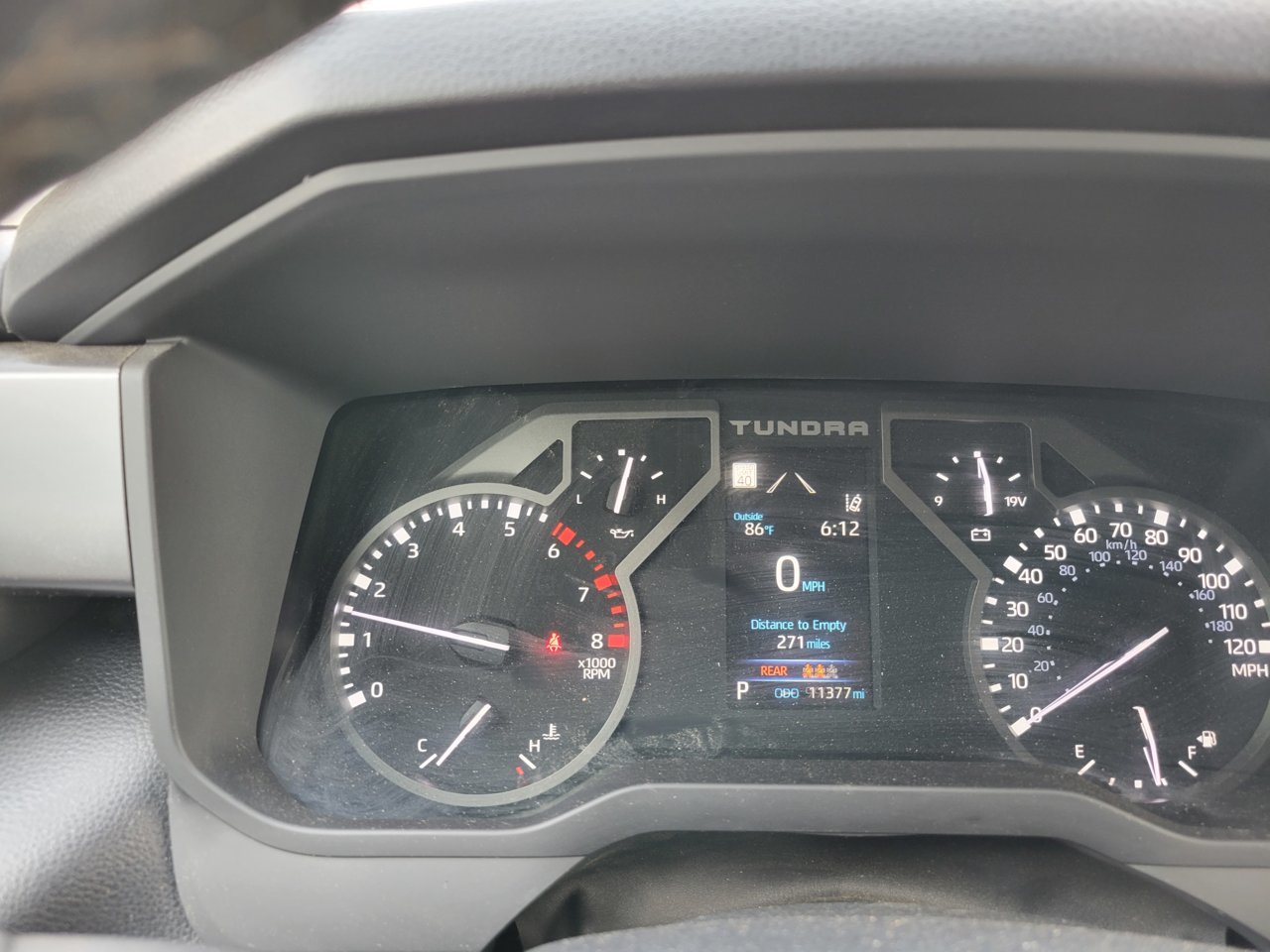

    Added pic 5 for cold startup
    20230615_181242.jpg 20230615_181300.jpg 20230615_181336.jpg 20230615_181600.jpg

    Good to hear, I took some pics of the tsb results and it came out just as you described.
