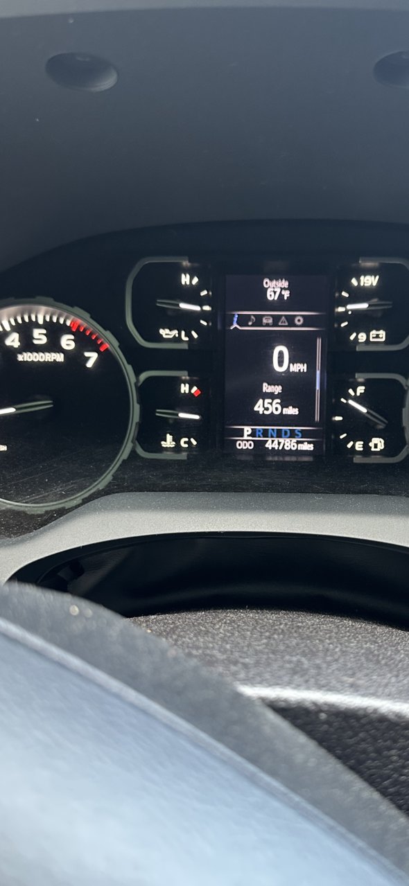

    Just curious about if my oil pressure is normal. When I start my truck it rises to about 3/4, then drops down to about just under half. I’ll rise slightly above have if I get on the throttle but most of the time it is below. I know it is barely even noticeable but it is still low. Is this just because of my oil heating up?

    Completely normal. That's where they all sit when warm, half to slightly under.

    When cold the oil pump will build pressure until the relief valve opens up, then the pressure settles into the normal range. Perfectly normal.

    This is where my 2020 (0w20) runs at Operating Temperature.

    Mine looks exactly like that.
    Side note, I like your F to E indicator. I wish mine was there more often.

    Haha yea it only cost me my left nut to get it there though
