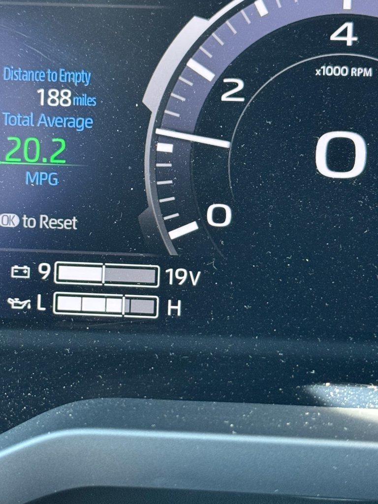

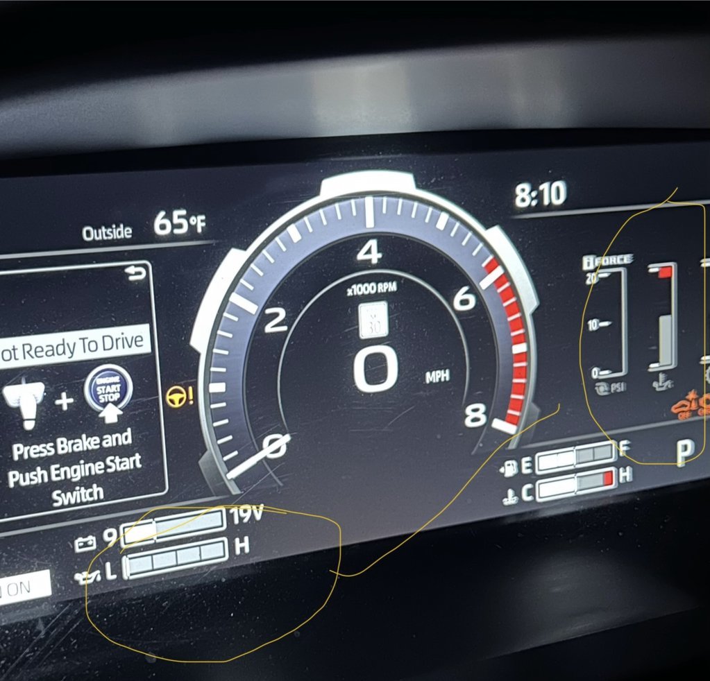

    I just went for a ride, interesting findings. First, what trim/display are you guys looking at? SR5 is different than Limited for example. If the upper trim ‘multi display’, are you looking at the oil pressure on the left below? The right is the trailing temperature view. I guess.
    The trailering view seems to stay static, at the highest temp achieved.
    My regular pressure view, to the left, definitely fluctuates. It never goes below 1/3 and there under normal load. But when given gas it goes up to 3/4.
    Pic 1 truck is off. Notice trailer view retains highest mark from last running. Also notice zero oil pressure since truck is not started.
    Pics 2 is truck idling. Notice left hand at about 1/3. It only goes to 3/4 with a heavy foot. I’m on original oil.

    You appear to be in the normal range. My truck is the roughly the same. The oil pressure showing no pressure is when the engine is off and under battery power on a hybrid. I wouldn't worry about it. If it shows fine on the dipstick, I believe you're good to go.

    Yeah mine seems normal, what I’d expect. I’m wondering if the folks with gauges that don’t move are reading the temp gauge by mistake. Or perhaps if the analog gauges are the difference.

    The right screen is also showing oil temp, not pressure.

    Yes. That is why I italicized the words ‘temperature’ and ‘pressure’. And in my second post wondered if folks might be confusing the two… the little symbols are similar.
