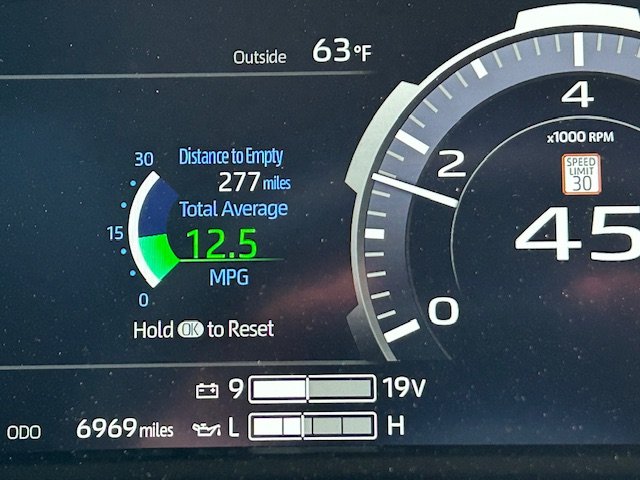

    I am concerned most of the time it is at 1/4. It is never above that. However what is concerning is when it goes to 0 - It does so if I am running 50, 70, 49 mph Etc and I come off the gas. Here is a picture That just doesn't seem right to me

    This is because you own a hybrid and the engine is currently off in this pic. When the RPMs drop to zero, it’s because the gas engine is shut off and running/coasting in electric only mode. Oil pressure will drop to zero in an engine that isn’t on.

    The engine is off. Notice how the needle on the tach is at 0 rpm. Can’t have oil pressure if the engine isn’t on… I’m pretty sure all hybrids shut the engine off even at highway speeds when not accelerating or coasting.

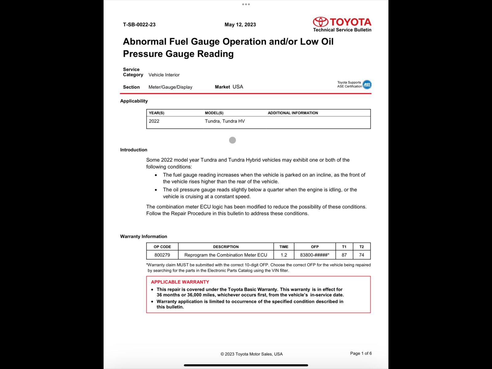

    with the engine oil up to temp (around 200*F) the gauge hovers around a quarter at idle. When idle fluctuates briefly and dips low, I will see as low as 9psi (very briefly) and averages around 12-13 psi (when viewing pressure with a scan tool).
    at startup and above freezing temps its more like 3/4 and around 70psi or so of pressure. slightly higher during a really cold morning.
    No TSB here, so if you have the TSB performed (computer flash for oil pressure and fuel reading fluctuations) you'll effectively get a dummy gauge from what I've read others reporting. Or should I say, a much less linear representation of what the actual pressure is.

    You hit the nail on the head. It is simply a software modification that will change how the gauge represents oil pressure. Presumably this has been implemented in all the later model builds. I guess enough people complained and or are use to watching dummy gauges in late model cars that read smack in the middle as 'normal' operating value. This is very common with coolant temp gauges, especially those that are digital.
    SnrDisregardo likes this.

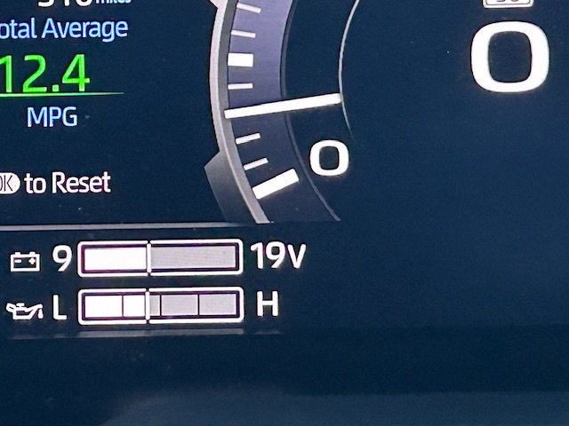

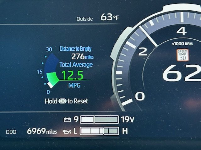

    Here are a few examples of my oil pressure.
    Idle, under 2k moving and over 2k.

    Before tsb mine was at about 1/4 pressure. After tsb it looks more normal at about 1/2 pressure
