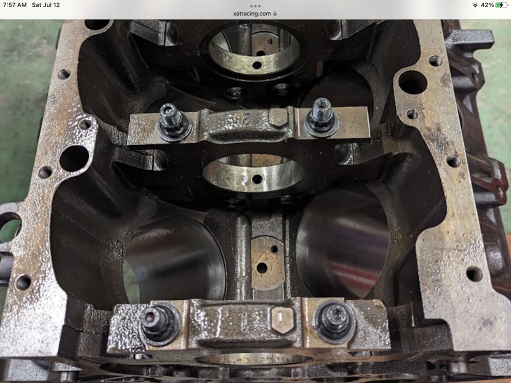

    Great mod. Best I can do is this picture. Unknown what year block this is, but it shows the location fairly well. They appear to be plumbed into the main oil galley.
