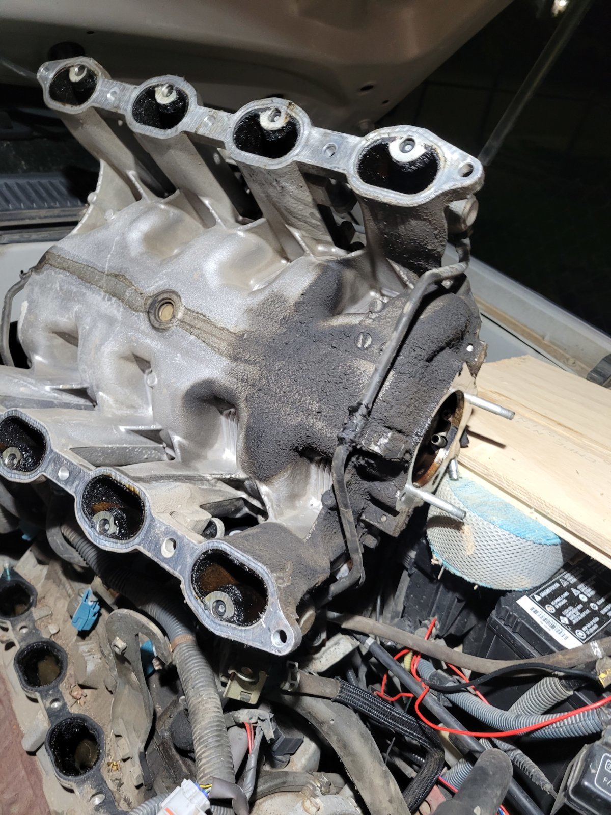

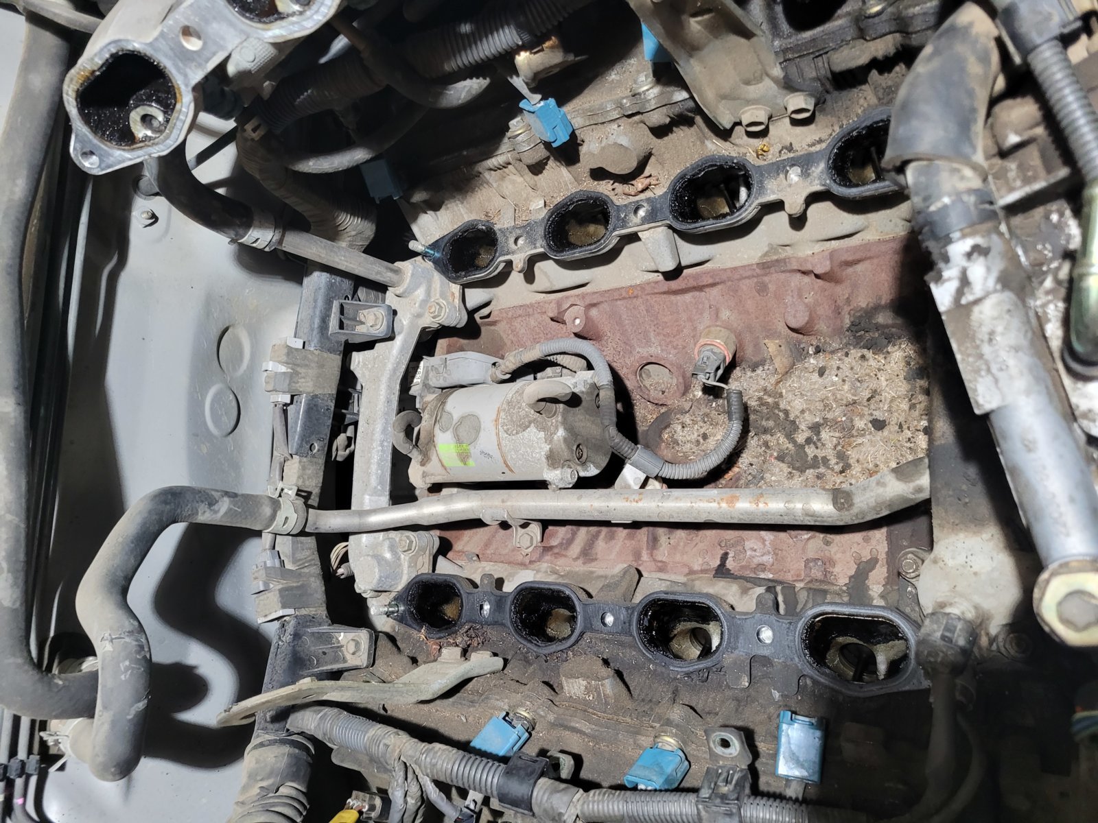

    Hi, I just took off my intake manifold etc. To replace starter, saw some oil in the intake ports, aside from replacing the manifold gasket and cleaning the ports, any other advice/ recommendations? I have been complaining about the fuel economy(~11mpg per odo full tank check) and feeling like the acceleration is sluggish, is this likely the culprit?

    You check your PCV?
    How'd the throttle plate look?

    Check air filter, Clean mass airflow sensor, bench clean the throttle body since it’s off the truck right now

    Some oil is normal, no it’s not the culprit. EDIT: I just looked again on a large screen, that's definitely a lot of buildup but looks more like it was airborn and stuck to the intake. Time to check PCV. It's due every 30k miles if I recall.

    Since this is a pre-VVTi, while you’re in there, you should replace the intake gaskets. You’ve been warned: only use Felpro or OEM here. Don’t make me tag the guy who replaced his intake gaskets three times already because several brands at the local parts store and/or RockAuto will blow out without warning. Rule of thumb: Aftermarket parts are shit quality since the mid/late 20-teens, so if you don’t want to do the job again, use OEM parts, OEM part quality hasn’t changed in the slightest.
    Other things you could do, some with the knowledge that the intake valley is a common rodent nesting area, and you don’t want to be in here again any time soon:
    • Wrap the wires in Genuine Honda Rodent Tape, their part number is 4019-2317
    • Clean out the valley really well, and if there is a ground contact in there (I swear there is, for the starter, right?) clean the hell out of it and apply dielectric grease before reinstall.
    • Consider replacing the starter if you have more than 150k-200k miles with a brand new Denso starter, which you can look up the p/n for at www.densoautoparts.com BUT do not buy it off one of the knockoff-prone stores like scAmazon or fleaBay.
    • If not replacing starter, you may want to at least do contacts and brushes

    Sorry, mis-read. Remove valve cover, inspect camshafts for wear. Scope ports. Are you producing white smoke or consuming excessive oil?

    If Im interpreting his lost , it sounds like his head needs to go to machine shop. OP, take off valve covers, post photo of cams.
    Could be a worn lobe, stuck lifter ( im guessing our motors use hydo lifters) . Im going to place my money and valve stem seal leakage. Based upon his comment on poor perdormance. I would do a full compression test or the /air compressor test to see if you can hear air getting by you intake valves during exhaust stroke. If any clarification is needed lmk. Or else its a pcv issue that im unaware of w our trucks. The FSM prob has a trouble shooting list for this

    Nevermind I actually looked at pic. This looks like a PCV valve issue, ...inspect pcv valve, perform compression test to check piston rings. Just what I would do.

    What loss? his MPGs? or the oil in the intake. Oil in the intake is likely from the PCV system. A catch can could mitigate that. The MPGs are in line with others depending on maintenance and setup.
