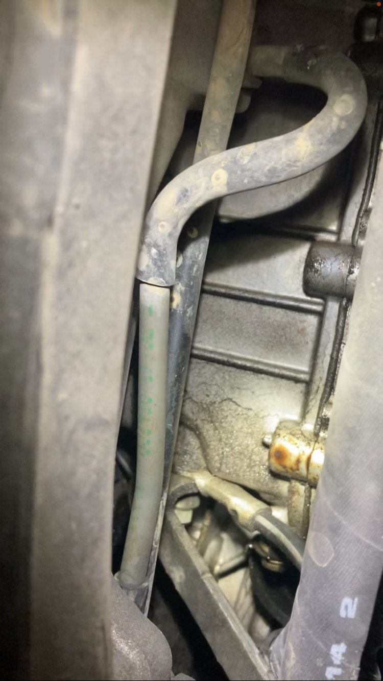

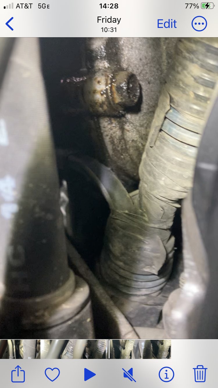

    Ok based the following pictures, should I be concerned with this leak? 111,000 miles. Looks like it’s from the front cover. It is not splash back from an oil change.

    Merely a seep... check your oil occasionally and confirm nothing can be "registered" on the dip stick as far as losses are concerned...

    It was a problem on some 5.7s. Mr. Robot didn't put quite enough sealant on the right side of the timing cover. Keep an eye on it but eventually you will probably going to have to have the work done. They never get better.
