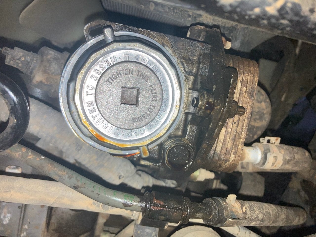

    Alright folks - gonna be a long one. I already searched the forums and couldn’t find a match for my issue.
    I have 191k on my 2016 tundra. It has never given me any problems. I just changed the oil for the umpteenth time a few days ago. Went outside 30 minutes ago and have a small oil stain under the truck on the driveway. Oil cooler and filter housing have oil on them, but so does the driver side of the timing cover.
    I can’t tell that the timing cover is leaking for sure so my question is: Could it be leaking from the filter housing and getting thrown onto the timing cover?
    Only changes to truck: metal filter housing swap, but I kept the oem plastic housing as it wasn’t broken or cracked.
    Replacing OEM housing will be step one, but I don’t see how oil could get from the filter housing to any rotating parts to sling oil up the side of the timing cover.
    pics were taken through the driver side wheel well. Not the best, but it’s dark here.

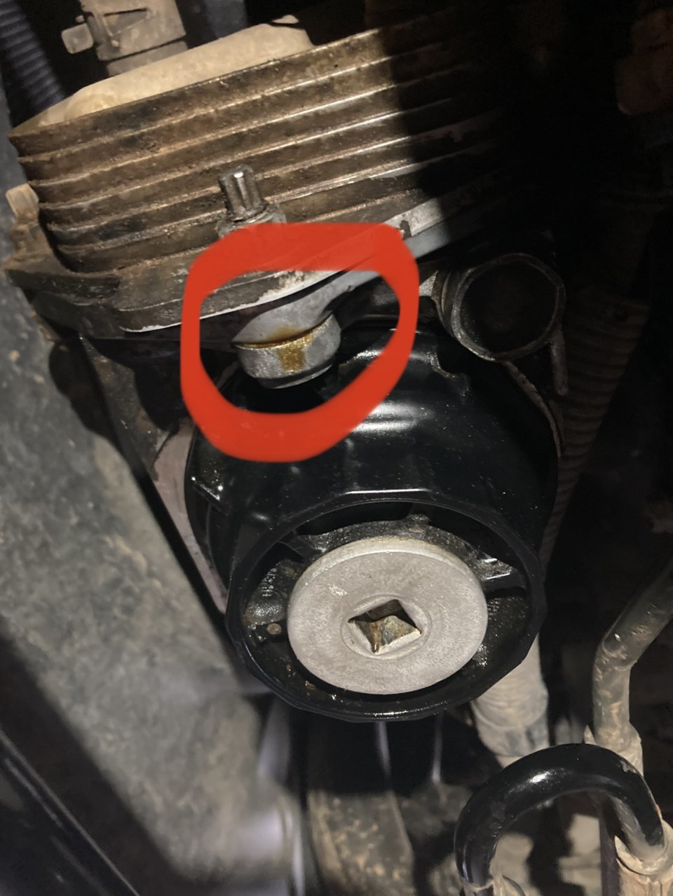

    Well I finally got under the truck yesterday. Aluminum filter housing was leaking so I swapped that back out with the oem one. I let the truck idle for 20 minutes. No more leaks, until I drove it to work today. Came out after work to an oil stain and a fresh oil droplet hanging on the skid plate.
    Now I have to figure out how to stop the leak in the second picture.

    Looks like that bolt (circled in red) was removed before. What happened to make that have to be removed?

    That’s not a bolt. It’s the mating surface between the oil cooler and the engine side of the oil filter housing. There is a stud that goes through there and the nut is tight. Bought the truck used so I have no idea if it was removed before I got it.
    My concern is that the leak is higher on the engine somewhere that I am not seeing and it is running down to that point to drip.

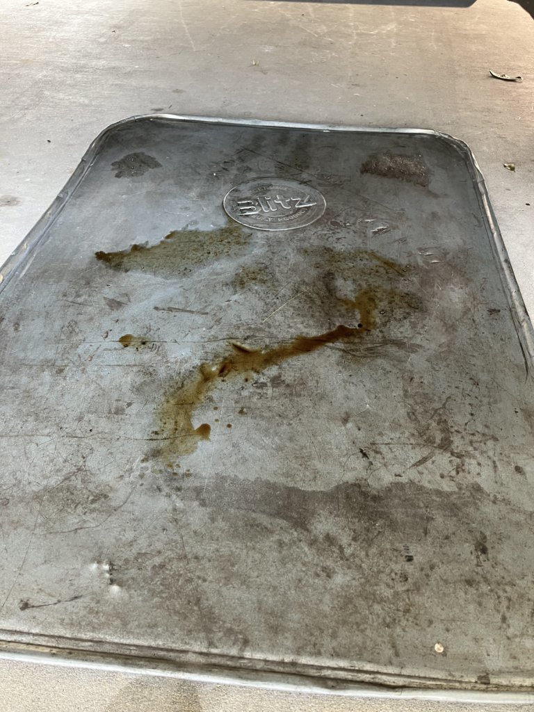

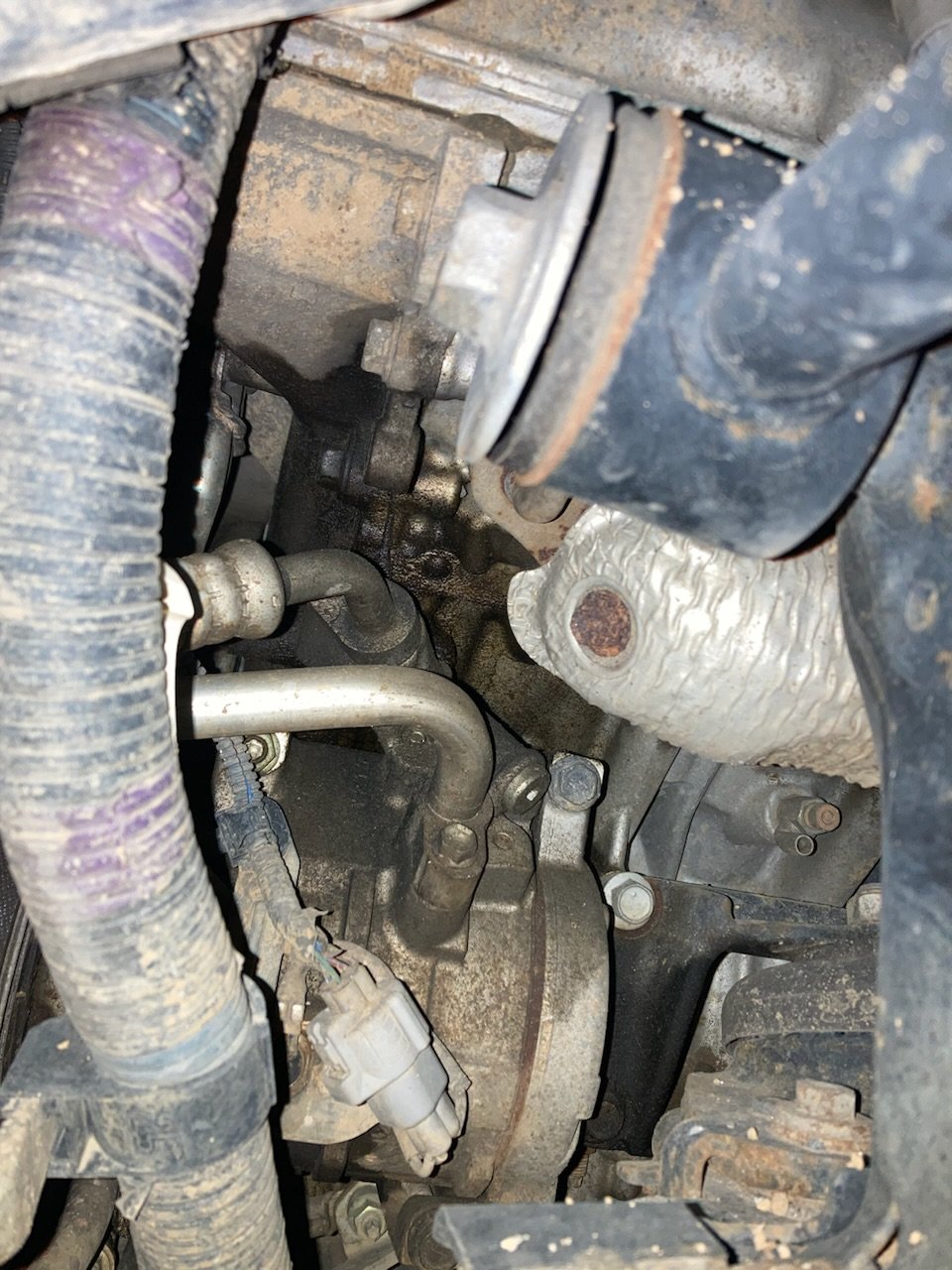

    Decided today was the day to chase the leak and I was really hoping it was the front crankshaft seal. Got the fan and shroud off, took the belt off. Front crankshaft seal was not leaking, but the water pump was! Dammit! Replaced the water pump started adding coolant and found a pinhole leak in the radiator. Dammit again! Truck has new water pump, new belt, new thermostat, and new radiator.
    Cleaned the oil off of everything and still could not find the leak. In the photo below the most oil covered part was between bolts 6 and 11 on the timing cover. Checked torque and they were in spec. I literally have no idea where to go from here.

    Now that you have it cleaned up good, it might take awhile for the leak to show itself again. I would just drive it and check it everyday till it reappears, then take it from there. Good luck.

    Unless pooling under the vehicle actively, I'd advise cleaning every surface that you can see now that you've replaced one known leak and seeing what happens.
    Especially under highway speeds, leaking oil can migrate up or toward the rear of the vehicle from the leak point, and continue dripping out of crevices and things for days after you have stopped it. It could keep "leaking" for days but really is oil migrating back down with gravity after being blown up into those spots.
