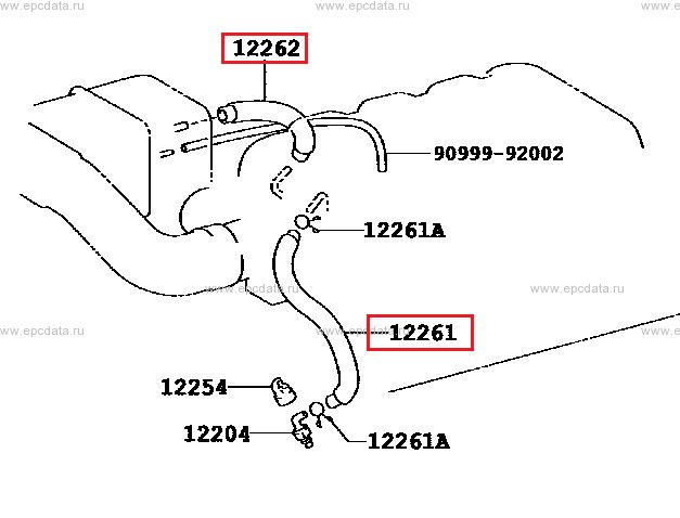

    Would need pictures to advice you on that one. You should probably be proactively replacing your PCV valve every 50k miles or 10 years, honestly. The hoses, by now, are certainly cracked as well. I know my 2006 hoses were cracked at the ends, and several other members have reported the same for theirs. Part# are easy enough to lookup using the EPC with your VIN (more info on "how"), I assume you have the V8, because you didn't specify in your truck details (inside your user profile) if you're V6 or V8. After you plug in your VIN, the part numbers will be found under section "Engine, Fuel System & Tools", inside subsection "Ventilation Hose". You'll want to open the diagram image, and click on each of these two numbers to fetch the part number.

    Intake torque is 13 ft-lbs. Be advised the ventilation hose marked 12262 is no longer available for early non-VVT 4.7s. The nipple on the valve cover is smaller on the early trucks like yours. I bought the hose for the 2005-2006 trucks and adapted it by put a short section of hose over the nipple and them pressing the new hose over that - worked perfectly. Also older trucks have a push in PCV and a rubber grommet in the valve cover. The 2005-2006 trucks have a screw in PCV.
