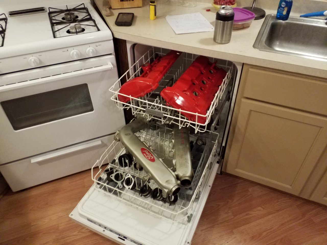

    I have a suggestion:
  24. Apr 21, 2022 at 8:27 PM
    #24
    Randydw
    Randydw New Member
    May 20, 2021
    #63337
    239
    Randy
    Ozark,mo
    2021 platinum crew cab
    Really, the dishwasher?. That kinda stuff keeps me in business.

    I support my local plumbers. Plus, it's a rent house.
