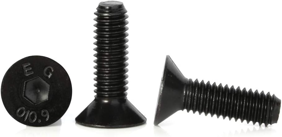

    I pulled one of mine and measured it.
    It is an M8 - 1.25 X 25MM BOLT
    lv4a3hxx_77c1d9778de100a33c68885a592c42bcfbf451c2.jpg (edited)_w72l28ev_23a3d82df5dbb0db4eb9fc567578378cc7d5aec1.jpg
    (edited)_ns2drkbl_832a16e4eebf8160b061a7daf4057ba4ae012260.jpg bcchpb4d_c910bba46a28aa5c6f039d79641b6f01427b7287.jpg
    Maybe you can find some somewhere.
    I don't think Toyota sells them unless you buy a complete hardware kit.
    If you MUST have OEM bolts, I think this is the kit part # PT938-34140-HW
    I'd check with @Roman to make sure that number is correct and the door bolts are even in it.
    Otherwise you can try something like these, or as others suggested try a hardware store..
    https://www.fastenal.com/products/details/M42580025A40000
    https://www.grainger.com/product/FABORY-Flat-26LG08
    These black ones are nice and you'll have over 20 spare bolts if they lose them again..:thumbsup:

    I ran into this and ended up buying 12.9 grade coated in black oxide. You "only" get 10, but the quality is better or equal to the ones from toyota. It cost under $10 with shipping for 10. The bolts are manufactured by the same manufacturer as the ones that come with the TRD skid plate, but they are just coated in black oxide.
    https://monsterbolts.com/products/socket-flat-b12-9-m8?variant=36297007564
