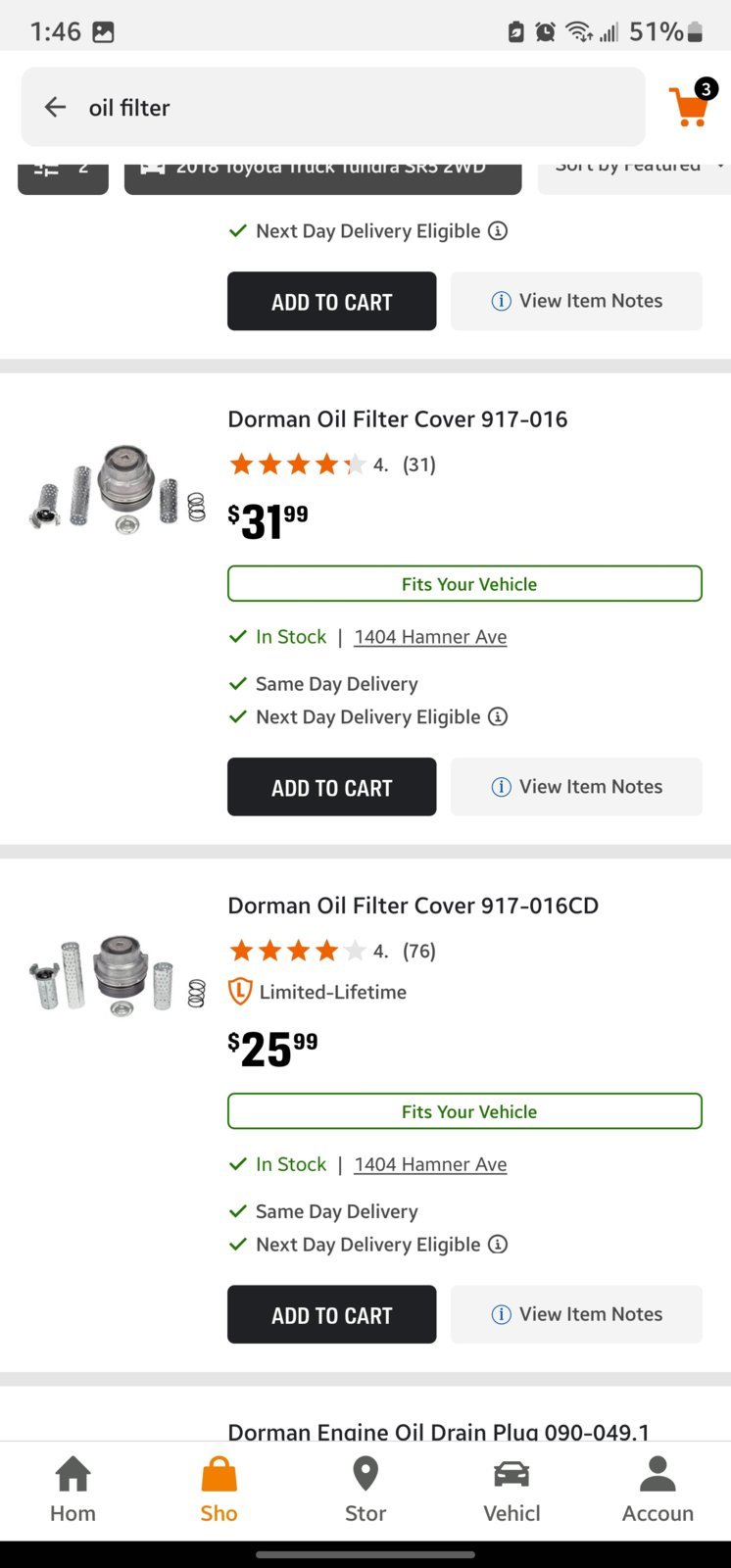

    Looks like this dorman aluminum comes with 3 sizes but what's the difference between the 2? :confused:

    I would use the OEM tower which has the tabs. The Dorman looks like it has a short tower with tabs and then you slip one of the two over it. It should work either way as all the tower does is keep the paper filter from collapsing.
