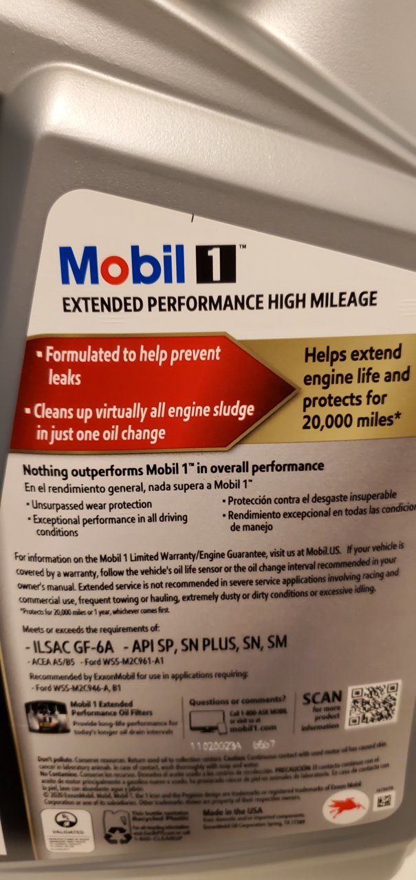

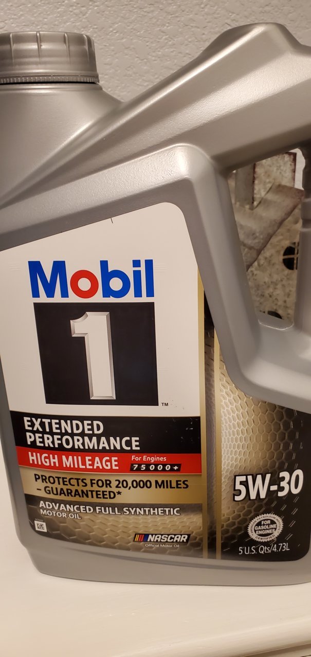

  9. Aug 27, 2020 at 6:01 AM
    Johnsonman
    Johnsonman New Member
    Nov 25, 2019
    #39132
    1,625
    Austin
    Sequoia
    LED headlamps/fogs; interior footlamps.
    Liking this oil, see 2nd note in Red.
