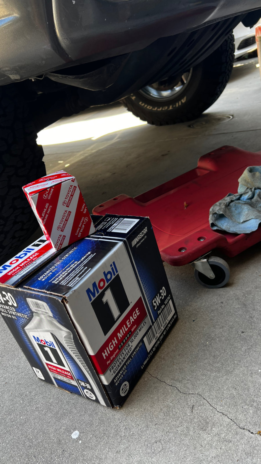

    Iv been putting in all 7 quarts of Mobil 1 5w-30 high millage for the last 3 years vs the recommended 6.6 quarts. OEM filter always.
    5 bolts for the splash guard, im lifted 2 inches so no lift or jack needed.
