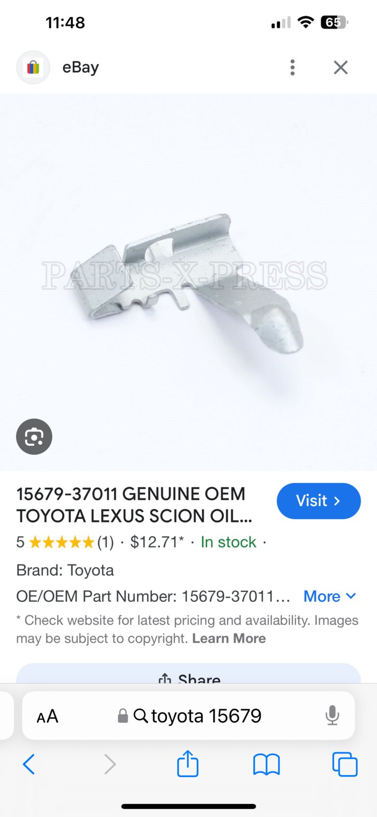

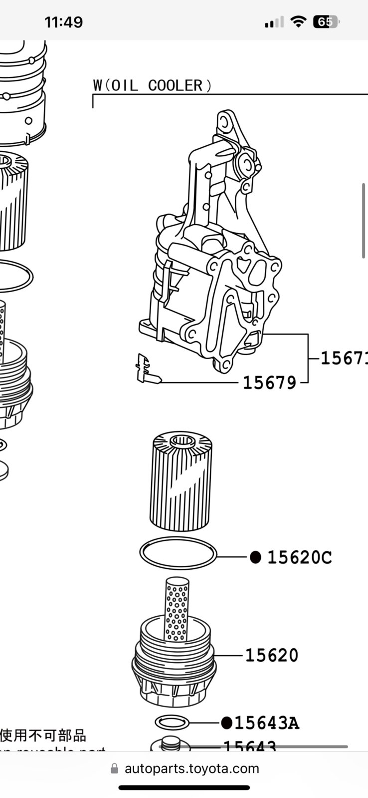

    Just did a oil change on my 15 5.7 for the first time , i swapped the plastic housing for the metal toyota one and while i had it apart i noticed a little metal clip in the housing where the filter screws in, it pulled right out i was able to find it online
    15679-37011)
    anyone have anymore info or how important this piece is

    I believe it’s designed to prevent the filter housing from backing off.

    Does it keep pressure on the housing? Mine looks like the tab is broken and no way touches the housing

    I think that component is worthless, in fact that's the first thing the lube tech bends out the way during Toyota Care oil changes.
    Never had an issue with oil housing backing off especially with Conan the Wrench Man torque specs from dealership.

    It’s a little tab that rests on the outside of the filter housing applying pressure to the housing to stop it from backing out. I’ve ignored that thing and have not had any issues with my filter housing backing out. I do use the filter wrench to snug it up, snug, not Conan tight. Maybe a little bit more than hand tight with a normal filter.

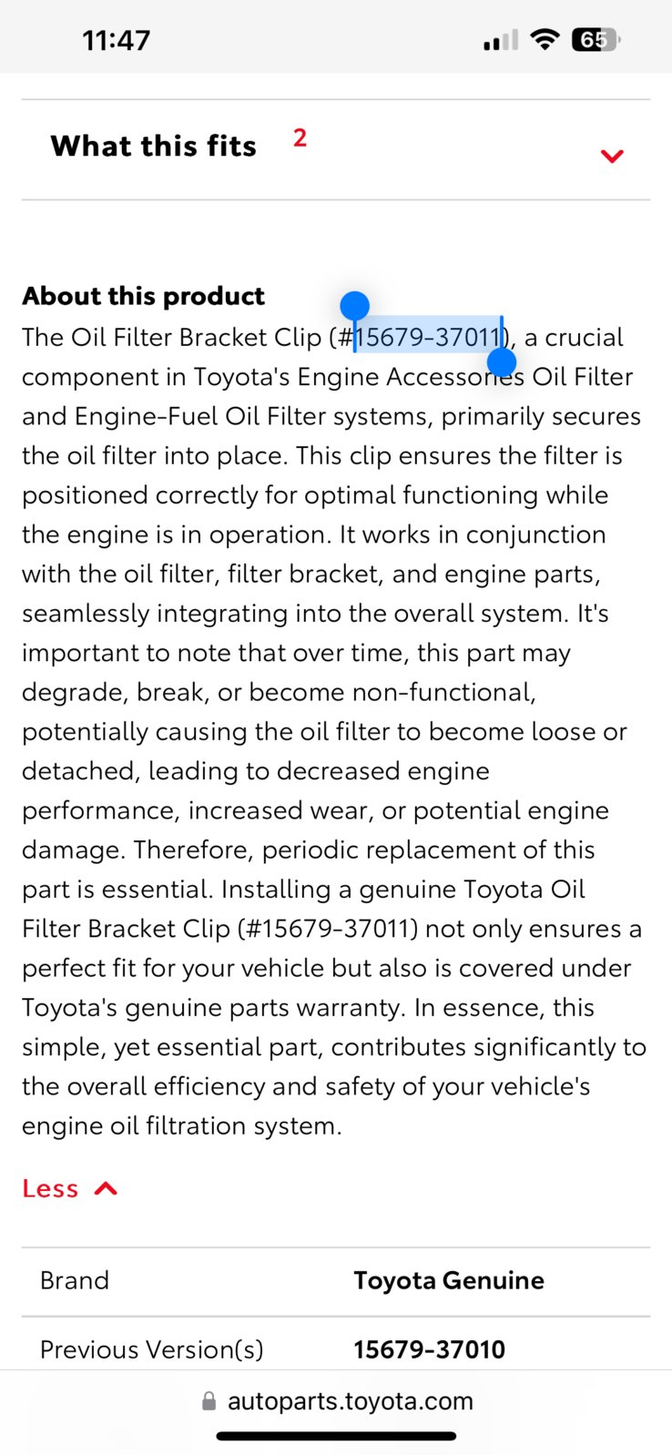

    Mine always eventually fell off and it never seemed to matter or do much of anything. In their description there you'd think all your oil would leak out and your engine will blow up if you didn't have this "simple yet crucial" part.
