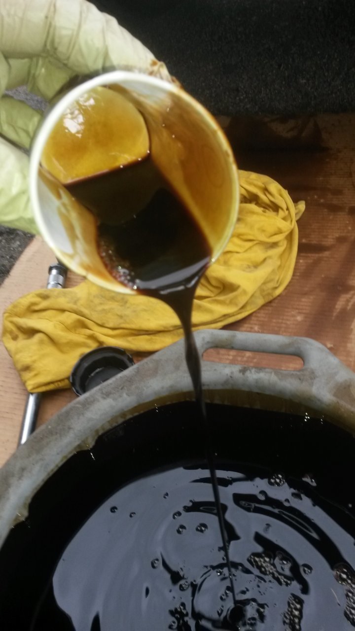

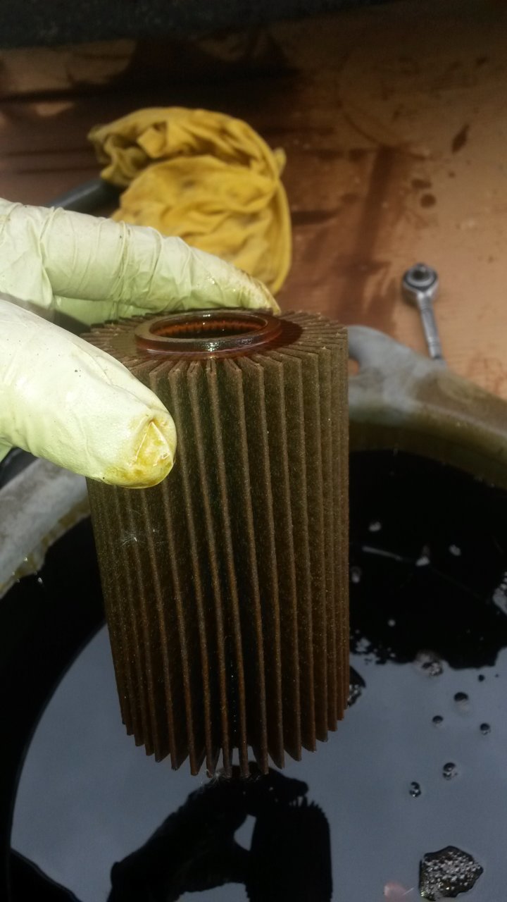

    Well, I decided to change my synthetic oil and filter on my new Tundra at 4600 miles instead of the recommended 10K. It was an easy job and I'm glad I did. I know it most likely did not break down due to it being synthetic, but I'm from the old school and just don't like the idea of waiting that long. I drive it only for pleasure and have towed a light trailer 3 times since purchasing it last summer. I wanted to share a couple of pictures with you. Would you really want to wait until 10K to change your oil?

    I too change at 5K. However, my oil looked nothing like the OP. Mine was still like thin honey. There was also no signs of metal on the filter pleats.

    Yeah, mine at 5K always looks real good but I still change it out.

    10k is fine with me. Color doesn't have much to do with the life left in the oil. Get is tested at Blackstone labs to find out for yourself.

    Yeah, oil color is somewhat of a myth now because many oils have additives that discolor it. If dark to black though.....not usually a good thing. (High heat). I think Blackstone only charges about $30. I want to find out more info on the Mobile-1 Annual.

    Bob has a brand new truck with a brand new motor. If I remember correctly, it takes 10~15k to totally break in new piston rings under normal driving conditions, so blackish oil for the first several oil changes is not uncommon. The oil in my Toyotas still looks good when I change it at 10k, and I run both of them hard at times. I had a TRD supercharger on the Tacoma from 25k~80k and hauled two~three Harleys in an enclosed trailer often. I removed the S/C when I bought the Tundra to gain back a couple of MPG ... otherwise, that thing ran like a bat out of hell :mudding:
